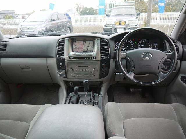

Toyota makes a bewildering variety of global specs on this machne. My 2004 JDM 100-series has no rear or front locker unfortunately, but has an LSD at the back, and a Centre-Diff lock. The CDL is button operated and can be used in high or low range. I believe (from reading, not personal experience) the earlier models had it so you didn't have that choice.
