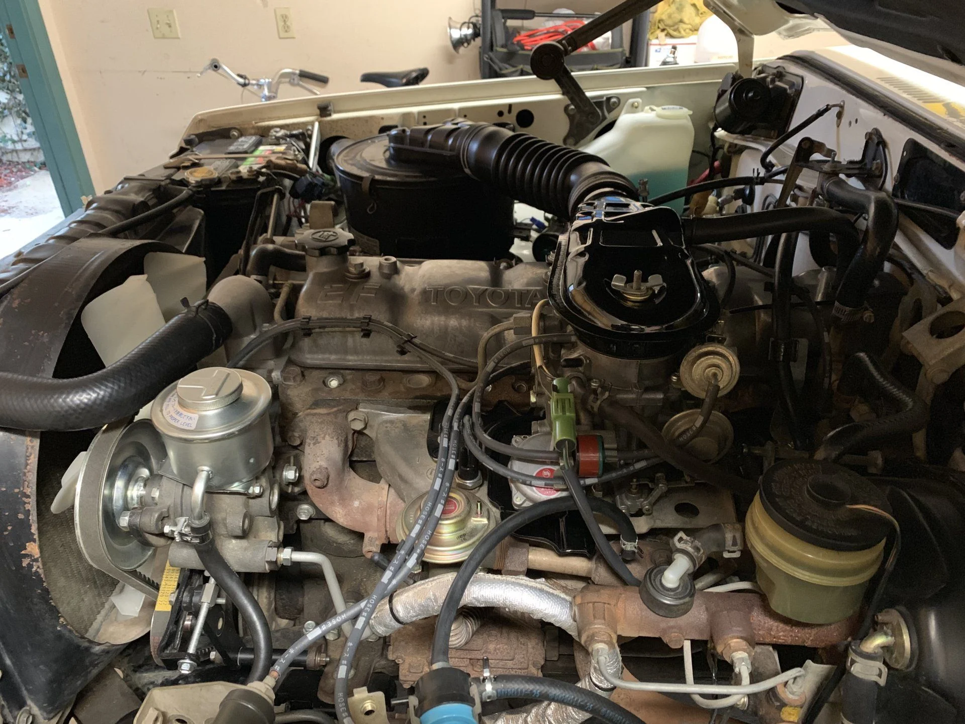

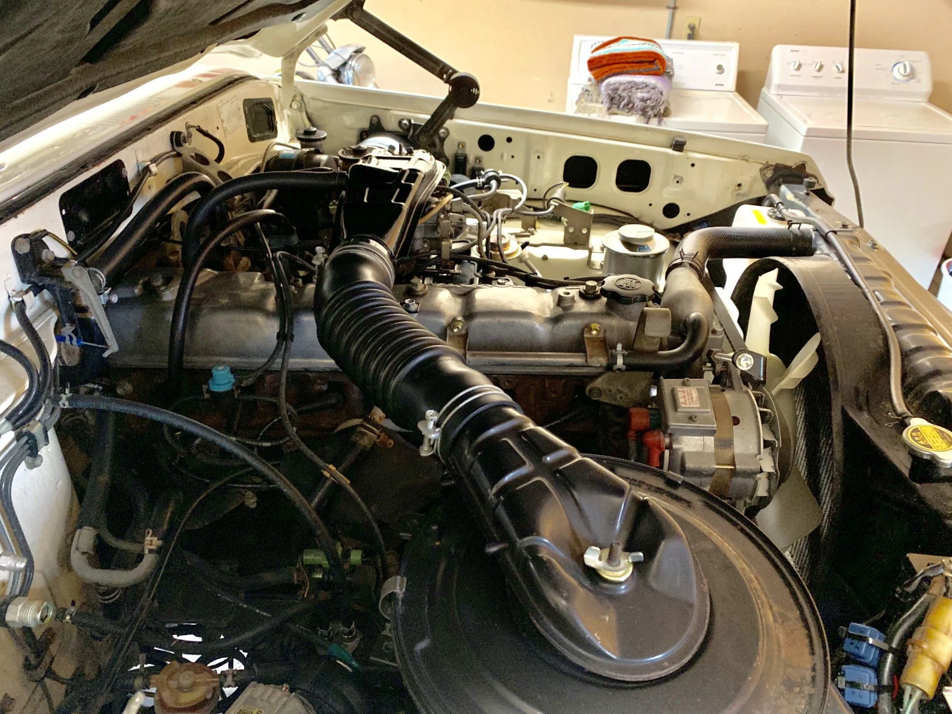

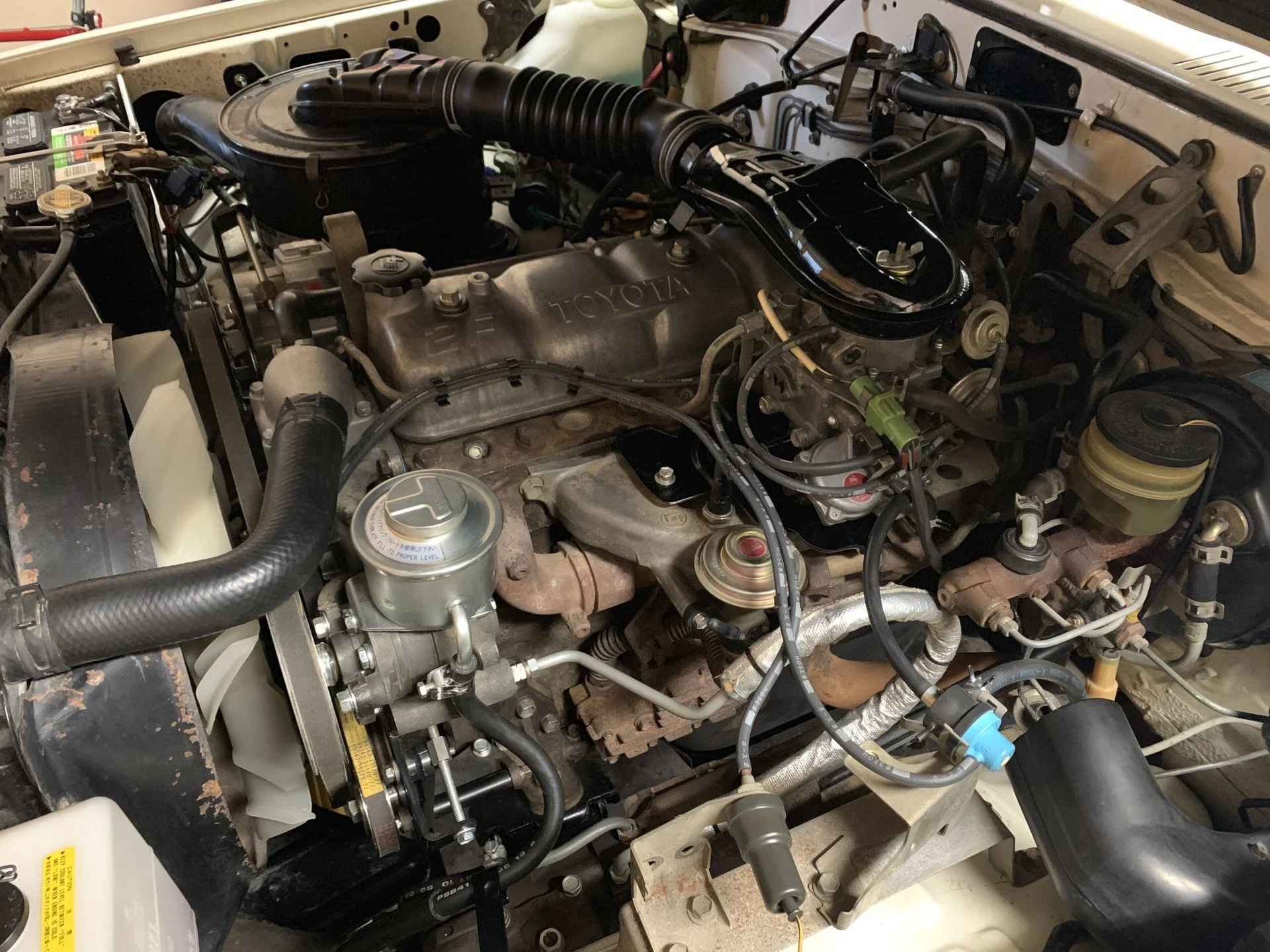

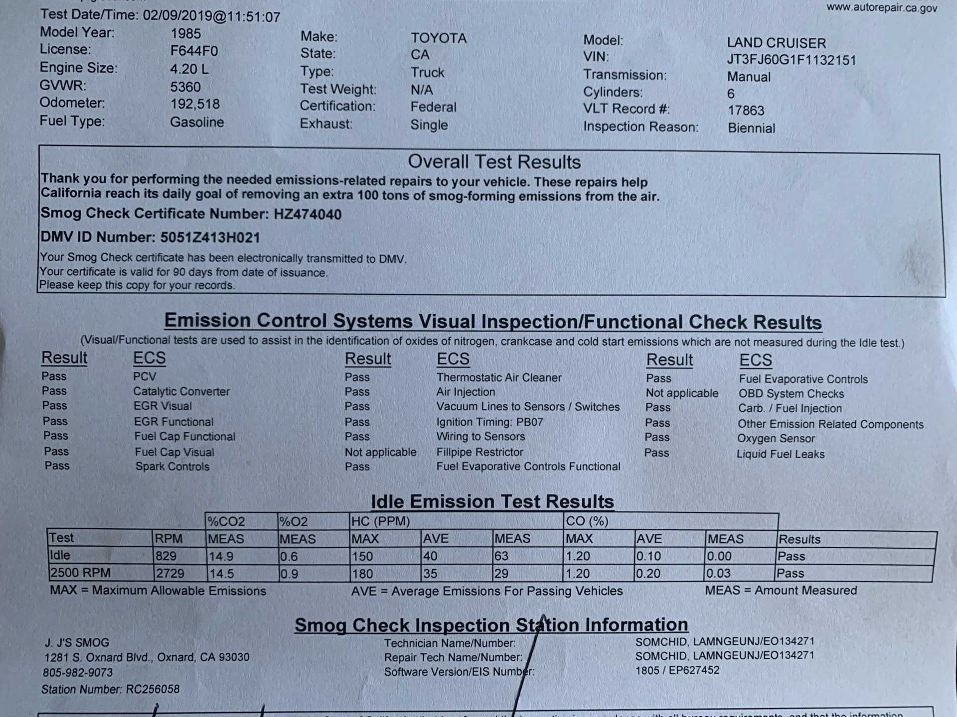

Nothing too interesting going on...passed smog, so that included resmogging and desmogging.

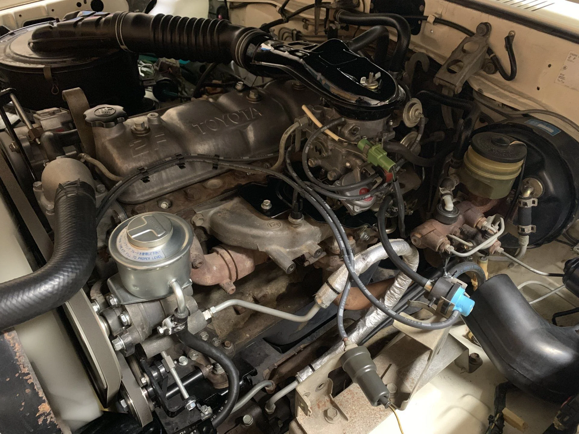

Now that she is good to go, i decided to fully desmog. Waiting on @FJ40Jim egr delete then going to weld up the pcv or make a new unit. Until then, here she is including the smog cert.
1904915
1904916
1904917

When you went in for smog did you put the original air filter on, or were you able to smog it with the 3FE air filter?
Went back to completely stock including USA air cleaner. I kept every piece so it would pass visual as well.

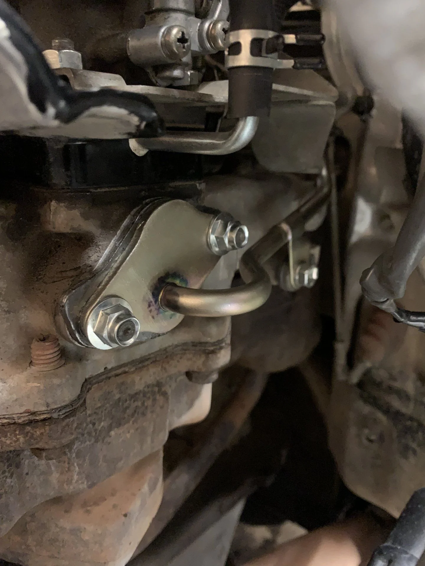

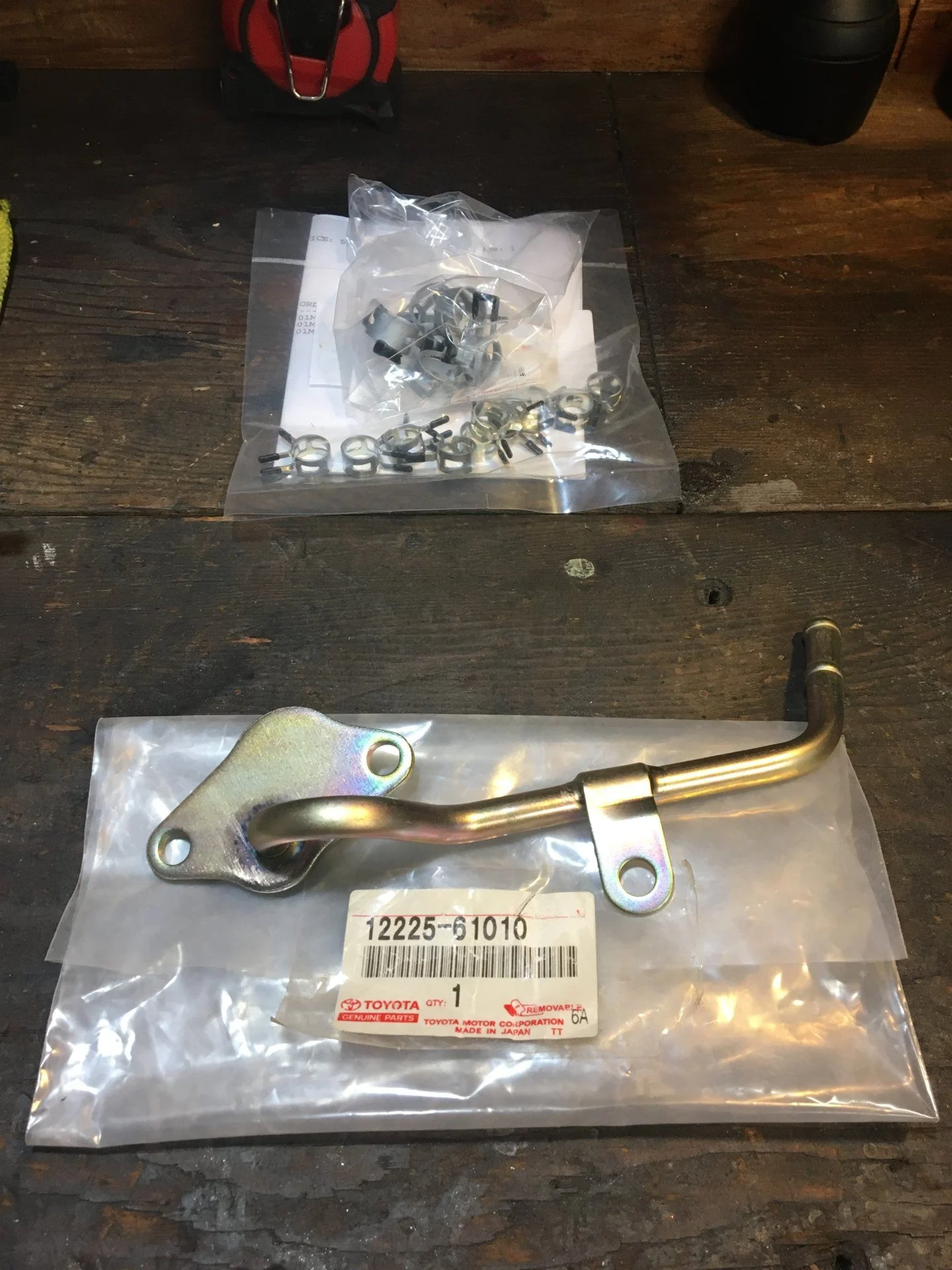

A while ago I purchased the non-USA 3F pcv vent hardline because it appeared it would be a direct replacement for desmogged trucks. My quick fitting made me think it wouldn’t fit....
Well I was WRONG!
3F pcv hardline fits perfectly, only two items to note, ever so slightly bend the hardline just a hair away from manifold, i did this off truck and test fit, no issue at all. Then add a 8-9mm spacer behind the bracket off the hardline and voila! Now the truck is completely desmogged and the only non Toyota item is the J Pipe block off from @FJ40Jim
Also did a carb rebuild, thanks @cruiseroutfit for the kit. Might give you a buzz on mixture screw, mine is a little bent...
