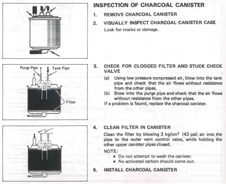

I came to your build and read through the entire thing again just now. Great read a second time around by the way. I was looking for something in particular... I could have sworn I read a post or thread a while back about you rebuilding your charcoal canister. Am I wrong? I’m fighting smog demons and my charcoal can isn’t breathing properly. Running through the Emmisions manual one system at a time. I’ve found some used ones but I’m weary of a used charcoal can. Any thoughts?

Not sure where I mentioned the charcoal canister part, but my method was doing the initial test in the FSM which is below. Then I sprayed light amounts of carb cleaner into the Tank Pipe then cycled compressed air and vacuum to free the check valve. After a few attempts, the canister functioned according to the manual and lines were routed back to normal. Now my tank no longer purges air when the cap is removed and that was tested up to 13,000 feet while in Ouray.
Man... I could have sworn that was your thread I read on that CoalCan rebuild. Oh well...
I have the manual, thank you. I was apprehensive regarding spraying any cleaners in the ports but after taking your advice I did so sparingly. Seams to be functioning properly again. Thanks for the tip bud.

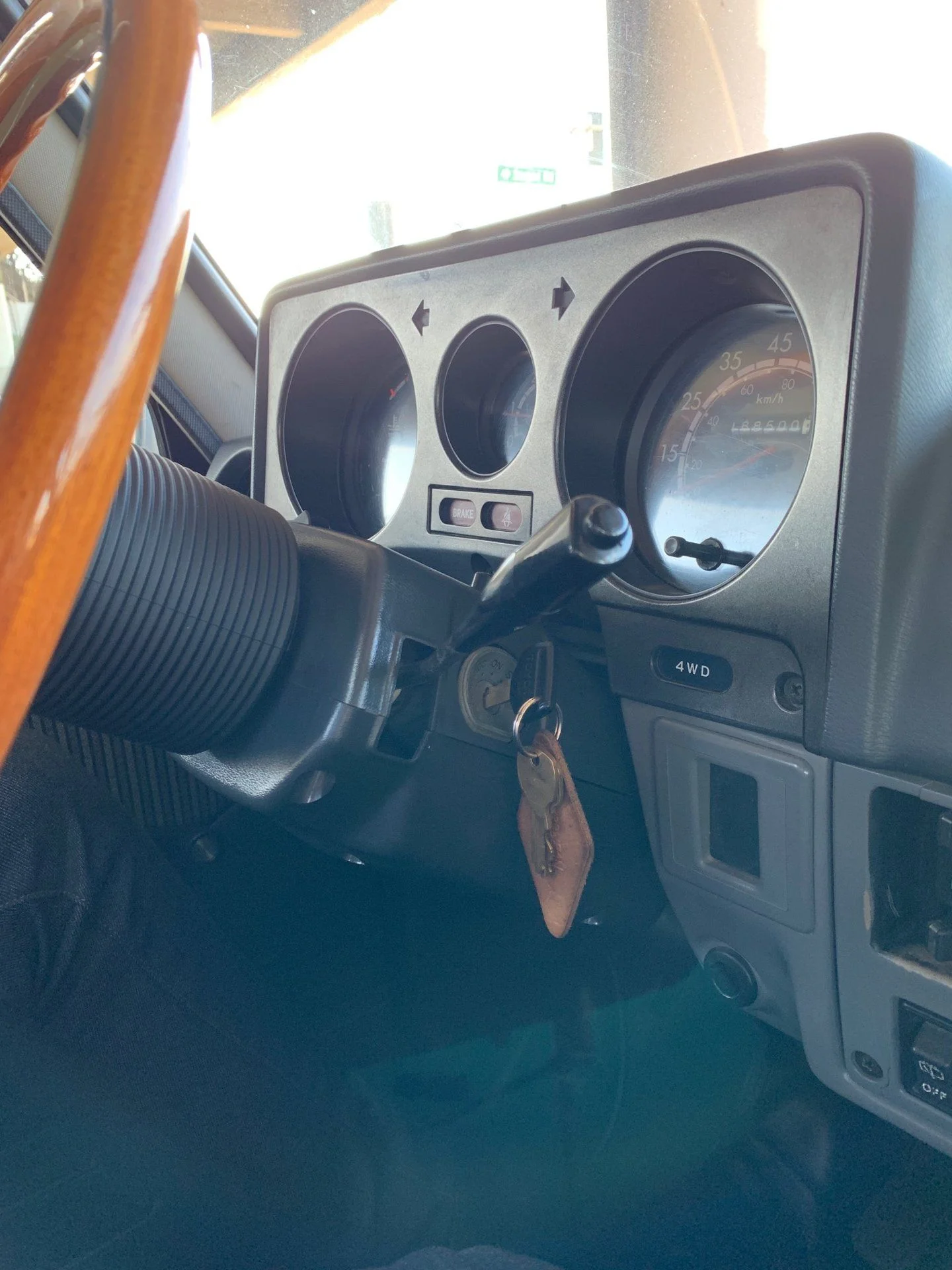

No real updates...just the Nardi and Works Bell Japan sorting me out with a 15mm longer boot. Nice fellows and helped me very quickly, doesn't usually happen like that when conversing with someone at a company overseas.
I love the Nardi, plus it lets the stock wheel relax in a box for a while.

Not usually a fan of after market steering wheels but that looks really good, the foot wear on the other hand...
Just one more thing to copy from you...
Haha! I’ve wanted a nardi in a car again for a while and this is the closest i can get right now.

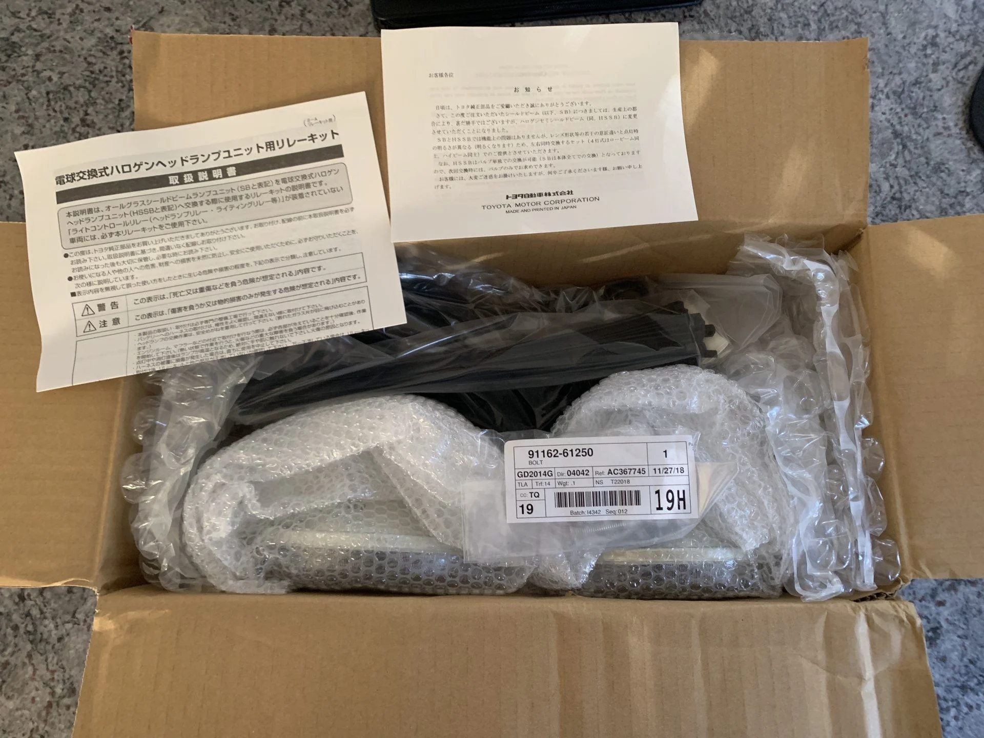

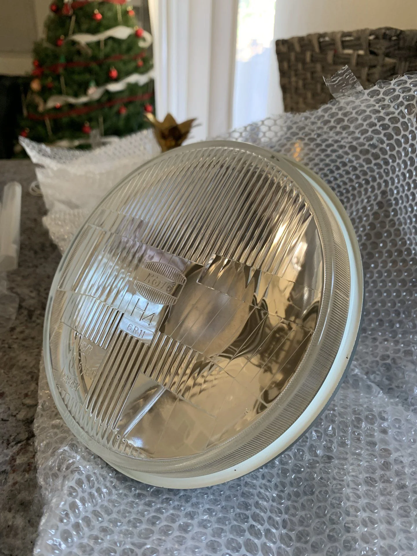

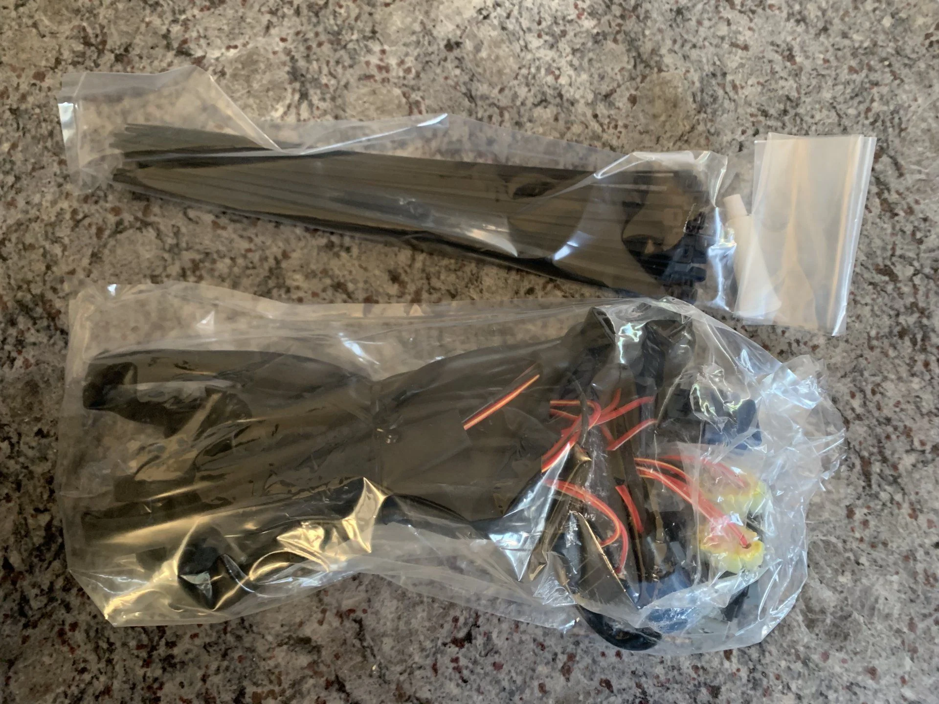

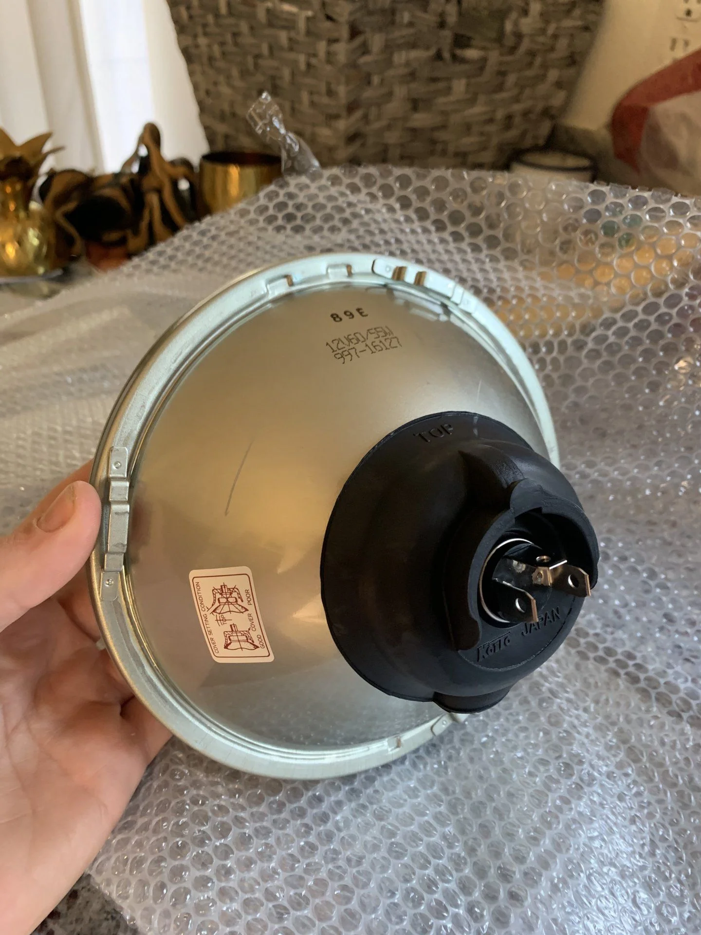

So thanks to @beno he found a Koito H4 upgrade kit. Ordered locally and it just arrived today! Decided before I install I’m going to refresh the entire bucket assy so these will have to wait until the rest of the stuff comes in but until then, here’s what it looks like. The lamps are Flat face, not concave for those who are curious.

That kit is sweet. Did it come with the relay harness too, or just the bulbs? The part number just pulls up the bulbs.
I'd love to do that on my 60.
81110-60P70 is two headlamps, relay harness, two bulbs and zip ties.
Super complete kit, really cool they offer it like this.
That rocks. Thanks!

We need beam pattern pics!
