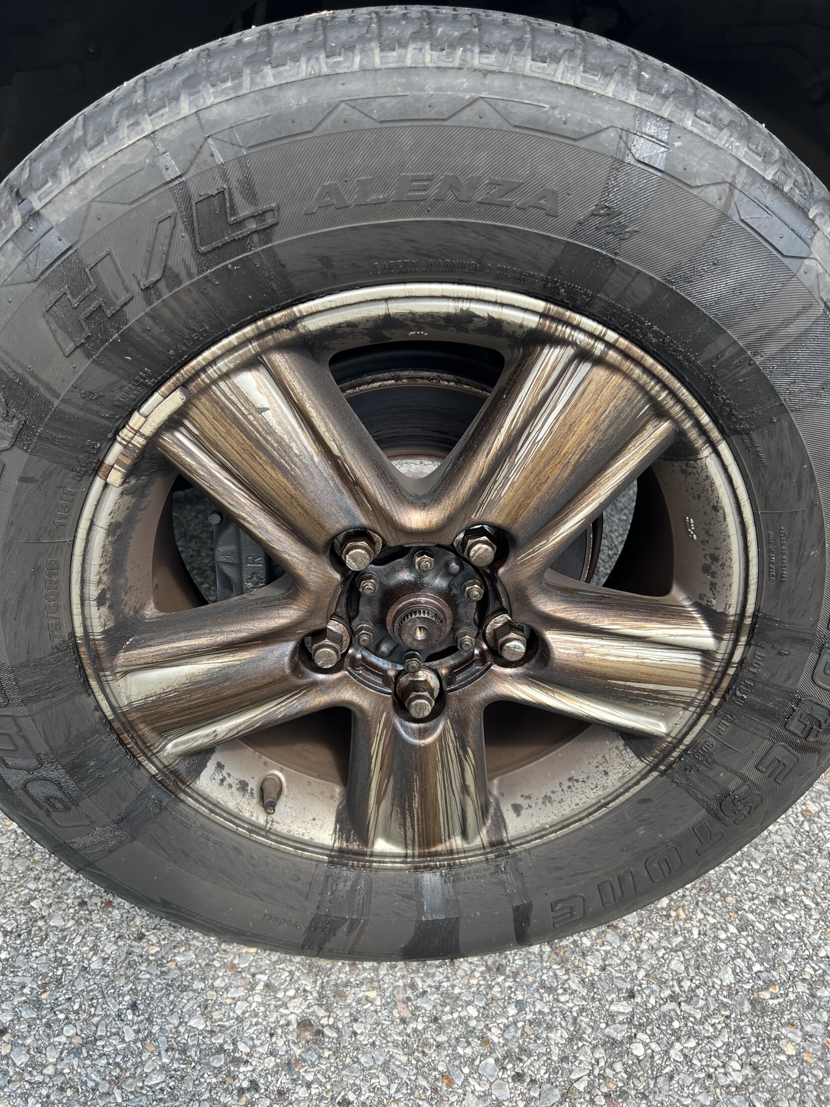

Well, this just happened and I could use some advice.
I tow an 06 lx470 behind my RV.
Appearently this morning, the brake away system stuck the LX brakes on, but not fully.
This caused either the brakes to over heat or the front axle to over heat, not sure which.

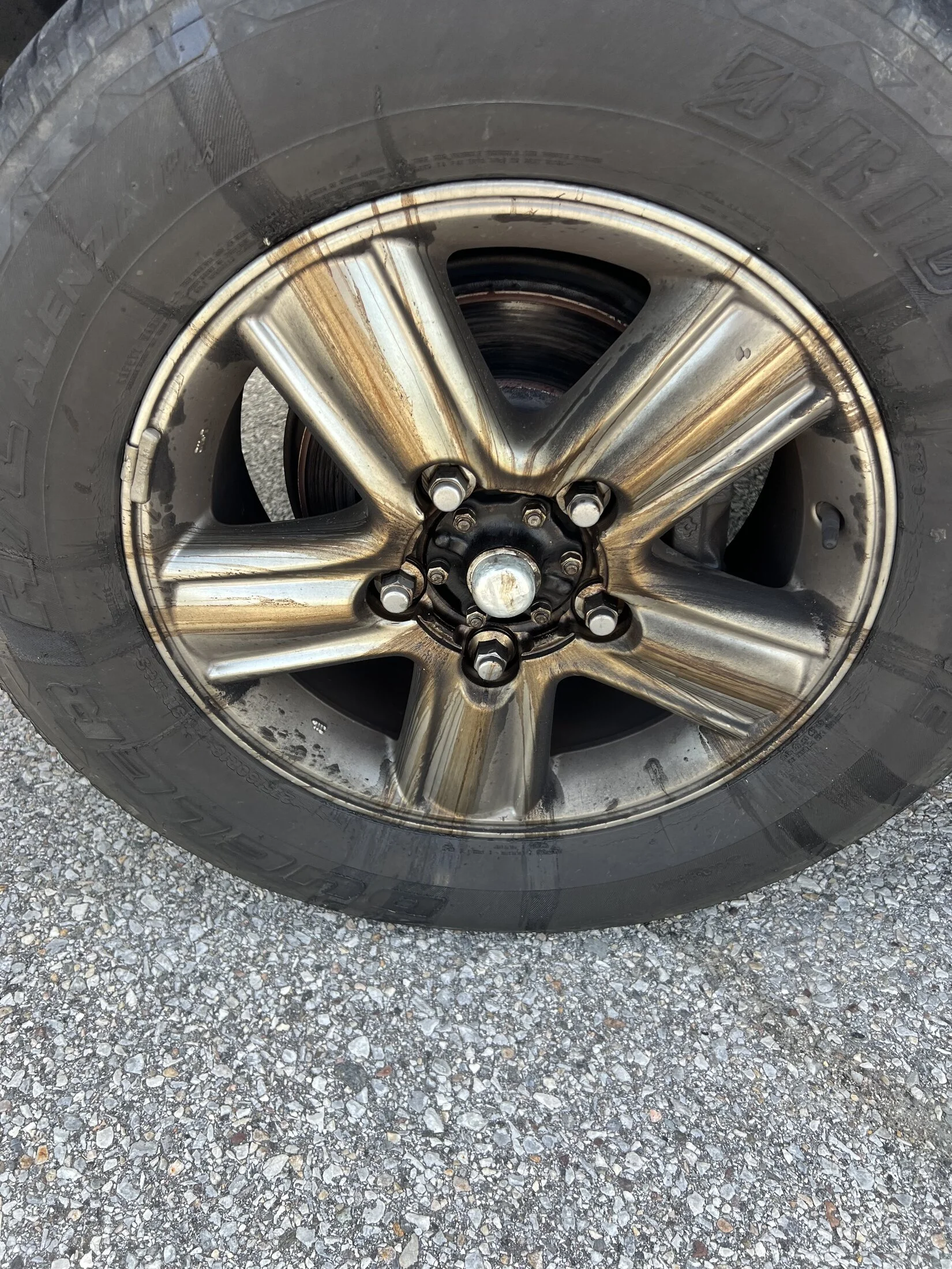

Looks like axle fluid all of the inside tire wells and the plastic center caps are gone.
The brake reservoir is full so I assume it’s from the diff?
The CV axles are new, less than 5k miles and the fluid was fine before this trip.
The carnage happened in less than 40 miles between stops.
Any advice is appreciated.
Now that the brakes are cooling, you can see the mess appears to be from the brakes, its poring fluid when they are applied.
Anyone know of a good cruiser shop in Vermont or Maine?

IDK, but it looks like it's coming from the axle by looking at the spray pattern. You mentioned that the CV axles were recently replaced. Were they replaced with original Toyota or aftermarket?

The leaked fluid all over the wheel is definitely not hub grease or cv axle grease. Hub or the cv grease is too viscous to splatter like that. I’m positive that’s brake fluid. I’m curious how it reached the face of the wheel. I’m thinking the banjo brake fitting on the caliper backed out, spilled brake fluid all over the barrel of the wheel outward the face to the tire sidewall.
Having brake fluid on your paint is gonna be worse than having gear oil hub grease on your paint i would think.. in case that also occurred.
That got to be hub grease. The hub got over heated and melted the grease into a liquid and passed through the gasket at the outer flange which supposed to hold viscos grease. Brake fluid cannot get into the hub. You might want to check the grease inside the hub.
Did you have the ignition on while towing? The car applied brakes on it's own, ATRAC kicked in? 40 miles of continuous brakes wear off the pads and then rotors.
I agree, the hub grease could have melted from the heat.
The grease cap is missing on one wheel, and I would guess loose on the other? I would surmise that the brakes bound up and started to heat up the corners, this has melted the grease in the hub which has expanded popping the grease cap out and then spread across the face of the wheel. The heat has eventually damaged a seal in the caliper so the brake pressure has released.
As well as the brake work I would strip both hubs and inspect all rubber seals then replace the grease with new. Then you need to work out how the brakes bound up. If the master cylinder is not adjusted properly and the reservoir port was covered you could have contained fluid between the master and the calipers. As this fluid warms it would slowly apply the front brakes. This would put more heat into the fluid which would apply them harder and so on.

Dude did you smell it... Maybe tasted it. Smell test will tell you exactly which fluid it is... No need to guess.

The vast majority of the fluid was from the brake caliper, when the system triggered, it held the pedal down and the brakes overheated. It got so hot it melted the seals in the calipers and the passenger side was dumping brake fluid as a result. It also lost some bearing grease as evidenced by the center out pattern on the wheels. The passenger side bearing will need to be replaced but we could not get the parts, so it was cleaned, repacked and we will take care of it at home.
