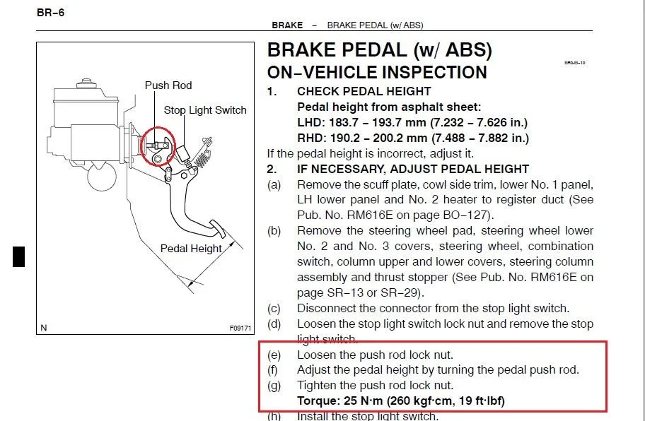

  3. Brake Pedal Adjustment: There is a clavicle at the back of you brake pedal that connects it to the master cylinder plunger. FSM calls for a very specific adjustment procedure (see pic below). I replaced the whole expensive brake booster assembly without improvement in the brakes until I did this adjustment!)
Interesting and detailed read ClassyJalopy, thank you for the info.
lol, no wonder no one talks about adjusting the pedal height. That would take all day!
It is actually pretty quick. You just need to do the part I highlighted in the red square. No need to take off anything really. I adjusted to the point where I started getting the brakes to rub and then backed it out slightly. Checked to see if I can roll the heavy beast by myself on flat surface and that's it.
