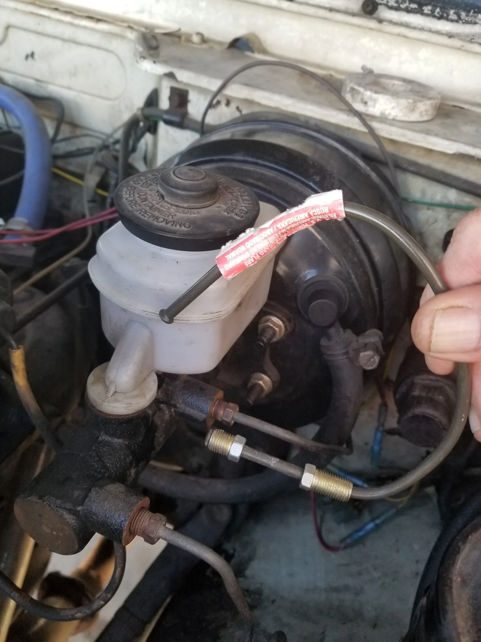

Bench bleeding the master is different than bleeding the lines and slaves. It should really be called firewall bleeding, that's where I do it. I got two short lengths of brake line off the shelf at my FLAPS, bent them so they would reach from the master outlets back into the reservoirs. Fill the reservoirs and pump the pedal a lot. Pump until you get no bubbles, attach the brake lines and bleed the rest of the system
