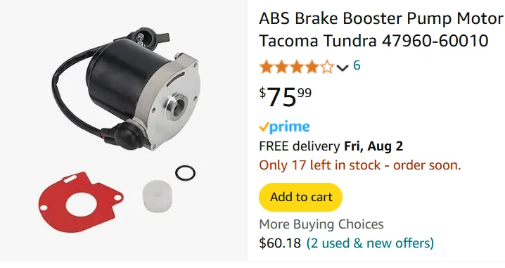

Is your safety or family’s safety only worth $75.99?
Another instance of compromising the legendary reliability of these trucks by slapping barf parts on.
Most of us doing this repair will only need to do it once. My booster is 17 years old with 264k.
I agree! If you want to change it out as PM then wait until Labor Day and I bet Serra Toyota will have a 20% off with free shipping. That would be the time.

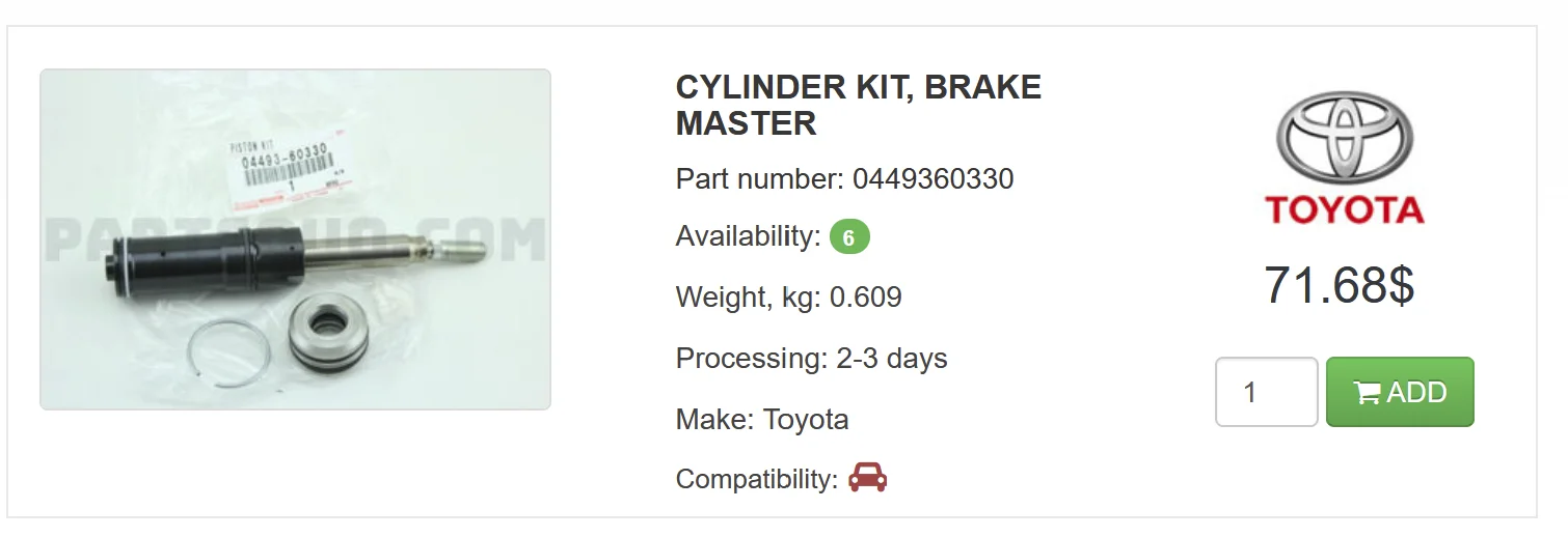

This is the part I used. It looked identical to the original Toyota. The seller also appears to now offer to rebuild your motor, but its pretty easy to do your self. I have a post on the "What have you done" thread about it. This kit has a 5 year warranty.
Master cylinder kit from Partsouq
If you have any automotive skill at all you can handle this, so don't be scared by the "must be OEM new all the time" crowd. New Toyota parts fail sometimes, but no one likes to talk about that.
