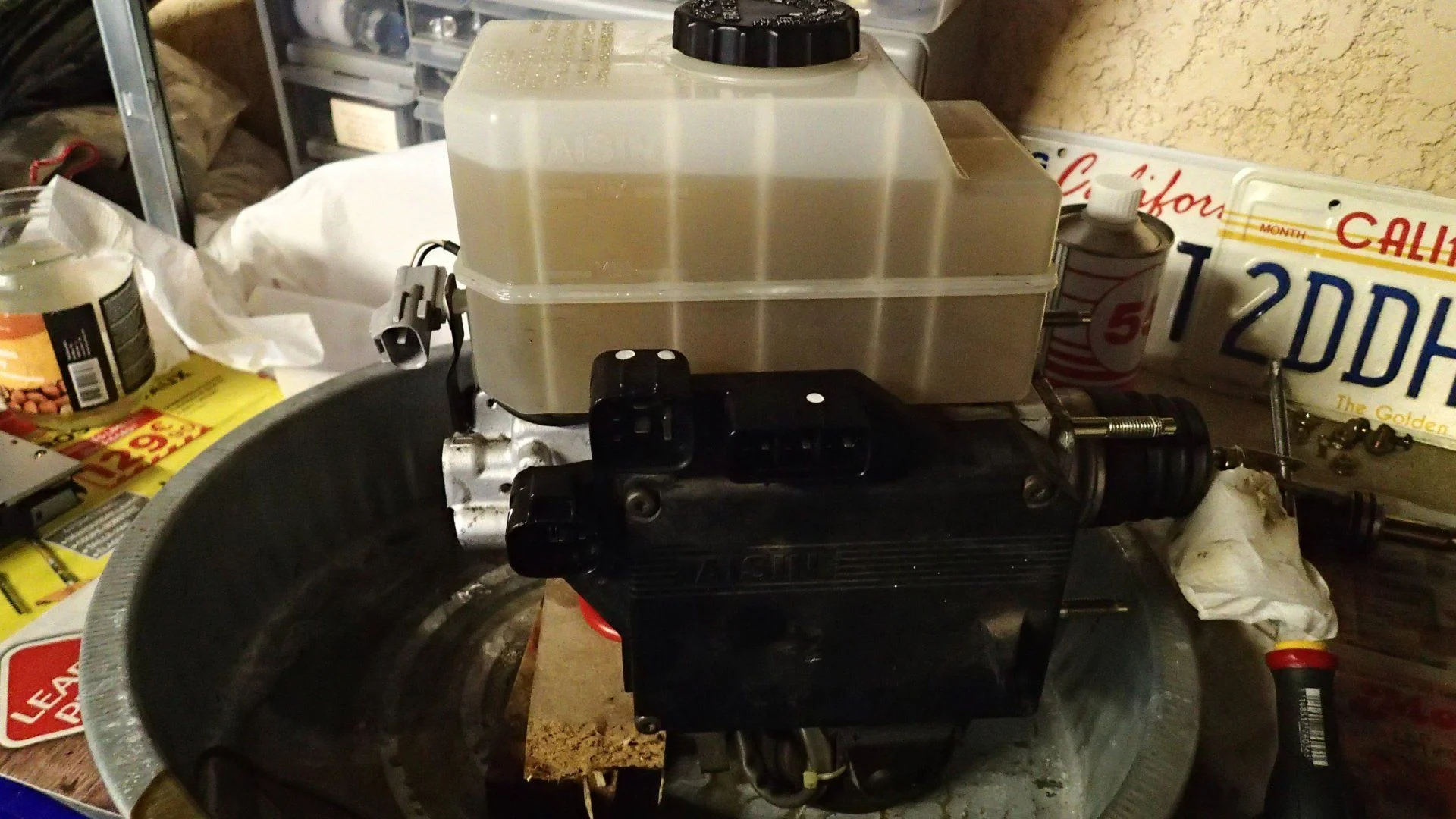

I did the MC piston swap on my '99. The bore of the MC is perfect. Since I was going to have to bleed everything I installed Slee's ss brake line kit too. Everything has gone smoothly. There are no leaks anywhere. I even made sure the bleeders are cleaned out and passing air with teflon tape on the seams for good measure.
I've read every post I can and I've looked at the free '03 FSM.
I bled the hydraulic brake booster by pumping the pedal over 40 times (57 times). The first 12 pumps the pedal was jammed to the floor (JtF from here on) where I had to pull with a bit of force to get the pedal to come back up. After putting the key in the ON position the pump ran for 35 seconds, perfectly between the 30-40 the FSM specifies.
Leaving the key in the ON position, I pumped 20 times (25 really) as per the FSM with the first 12 pumps, again, JtF. After three pumps I can hear the motor working.
Now with the pedal down (I didn't need to get the wife or bro cause the pedal is JtF) I cracked the front-left valve. I've done this multiple times with nothing. No air or fluid tries to escape. Same for the front-right valve. When I crack the valve it doesn't cause the pedal to return.
When I finished installing the new MC piston I tried to bench bleed the assembly by hand pumping the piston. While there were some drips I was unable to get fluid flowing. Was I supposed to orient the piston in a certain way? Could I have a busted MC? My brakes were ok before starting all this, albeit with a mushy pedal and less than perky stopping.
When I tried bleeding yesterday I got the rears bled. The ABS light and buzzer went off periodically. None of that now and I can't get pressure to the rear brakes. Pump n hold, crack the valve and no air or fluid comes out. I thought I was just going to have to figure out the fronts today but now I can't even get the rears to respond.
I've bled brakes before, numerous times, successfully with no issues. I'm 3.5 banana capable. Am I missing something obvious?
Thanks for any help.
