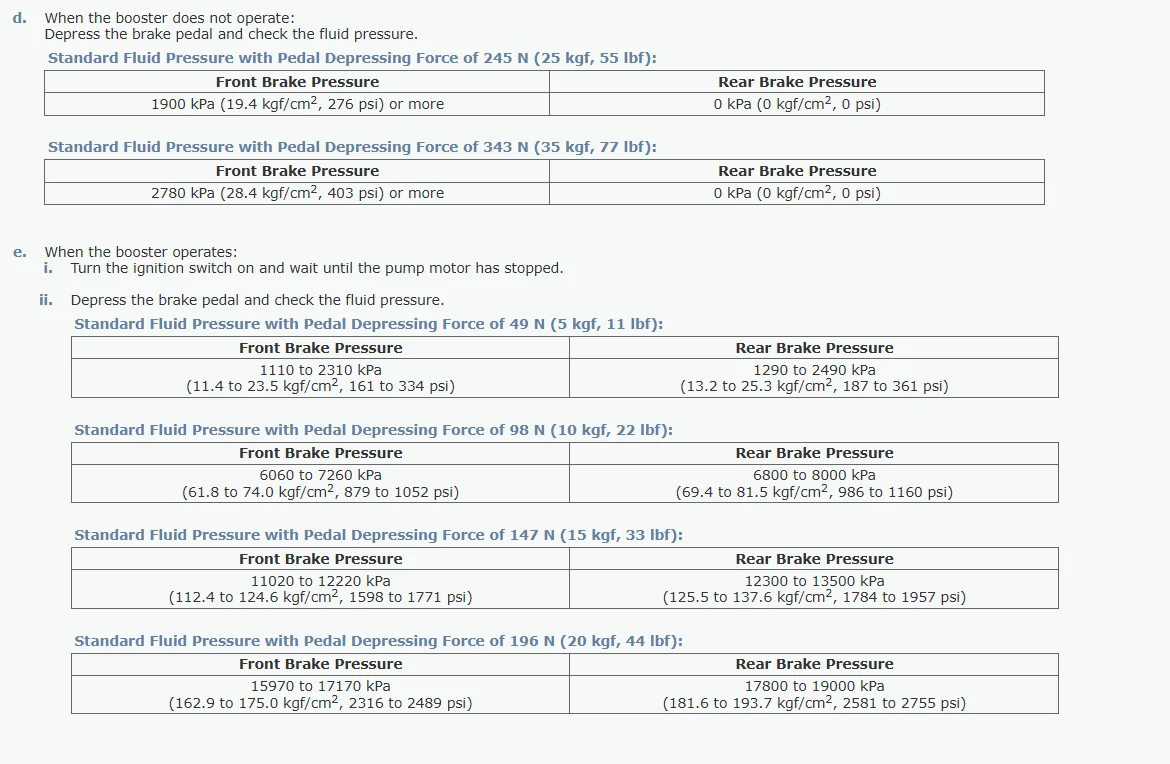

When I review the FSM I see that with the booster functioning properly the system should generate more force at the rear. I was under the mistaken assumption that the vehicle would be biased toward the front brakes. Ass|u|me I was wrong.
Given the apparent rear bias could my problem be brake pedal free play adjustment or it a problem with the master cylinder?
