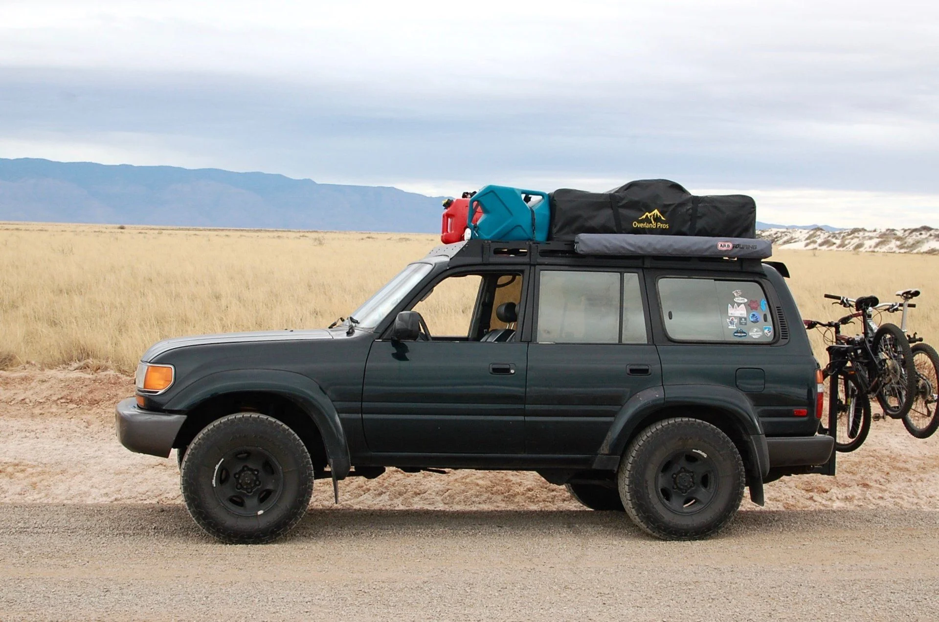

When I set out to go on a cross-country journey with my wife in the 80, I knew my options for storage and sleeping well, because I was always looking at 80s enviously, when I had a rust bucket project of a 40 (rest in peace, dear one). We ultimately selected the option of an RTT (and therefore a sturdy roof rack), and the LandShark KISS drawers instead of in-cabin sleeping, because: 1) it eliminated the need to purchase extra storage or some sleek external storage (i.e. BIO, SLEE, or 4x4 LABS bumpers with bike rack storage, etc.) since we were/are on a budget during the build and travel (I will still take money for the adventure over money for bling, any day).

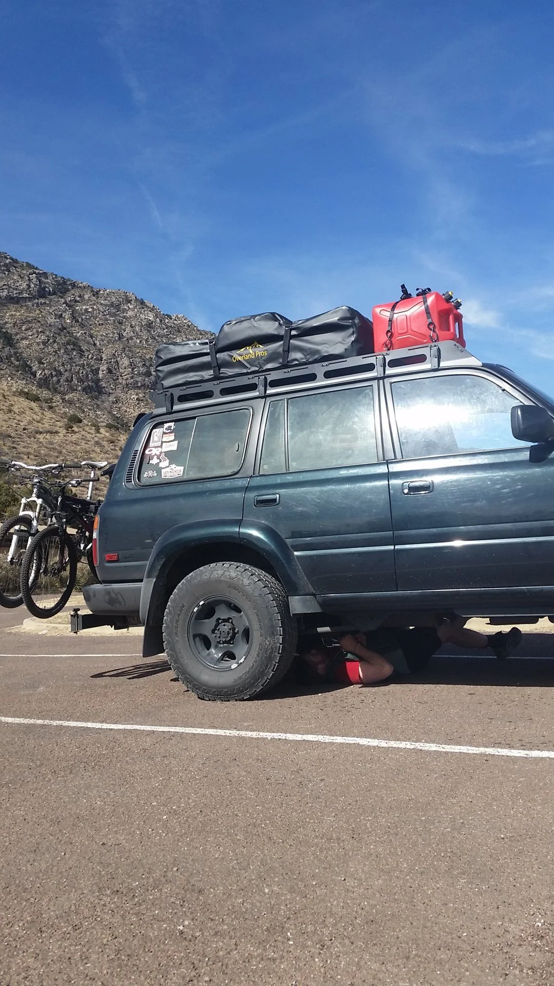

I am pretty sure the tie down anchors were not Cerakoted, as it lacks the grittiness of the stuff, and therefore probably molecular surface adhesion. The tie down points are exceptionally secure; despite securing 60 pounds of gas and 40 pounds of water, respectively, and driving a huge distance, I never retightened the mounts on my trip. Excellent designs, simple and robust, made of thick, coated steel. The other design of tie town anchor was also secured with four bolts and two long nuts each (the long nuts made aligning in the t-slot channels a breeze--another recommendation would be to use them in every situation feasible), but with a vertical, perpendicular mount welded to the flat plate that was secured to the crossbars via t-slot nuts. the vertically vs. horizontally oriented anchors serve different purposes, but could hold a larger static load than I'm sure the crossbars could handle.

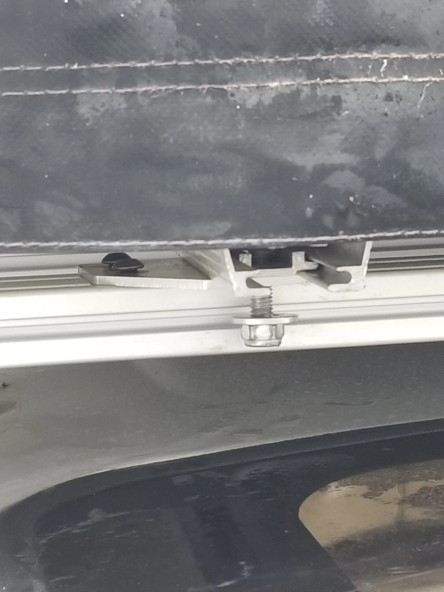

The tie downs which Patrick made for the rails are each secured with 4 (four!) hex bolts, which mate with a t-slot nut that goes into the crossbar channels. Lining them up can be a PITA, (for the individual t slot nuts) but once you install them, it only takes one revolution of backing off to move the position of the tie downs, so it's not a problem. Furthermore, without some significant change to fasteners, there's no changing it. As previously stated, two different types of tie downs were sent to me: 1) a type which was flat, and 2) another which had a vertical tie down. Both worked exceptionally well, but I'm sure will serve different purposes for different people. I think you should manufacture both of these, Patrick.
The tent mounts were sent, four in number, to be placed at each of the four corners of the tent, allowing it to mate with the rack cross bars. The adapter/mount is attached to the crossbar with the T-slot nut/bolt, and the tent is connected to the mount with one of the bolts sent with the tent, usually connected to roof rack crossbars in a u-bolt configuration. Patrick sent me photos via email, which I have included, as they are the same as what I received, except he sent some adhesive rubber pads, as well, to place on the square parts of the mounts, to prevent rubbing and vibration between the tent and the crossbars. It worked super well, and the only hassle is installing and removing the tent, because the super long bolts which came with it are difficult to install and remove while on the rack. However, 1) this is effectively a theft-deterrence, because it took an hour to remove the tent and 2) you can use shorter bolts and everything will be simpler.

For reference, I was in the desert, two blizzards, rainstorms; regularly stood on the awning mount and crossbars (mounts were super sturdy; crossbars will flex in the middle, so stand next to where it mates to the frame rails) to remove/install the tent rainfly or other things...it is super robust. I never had to adjust anything up there.
