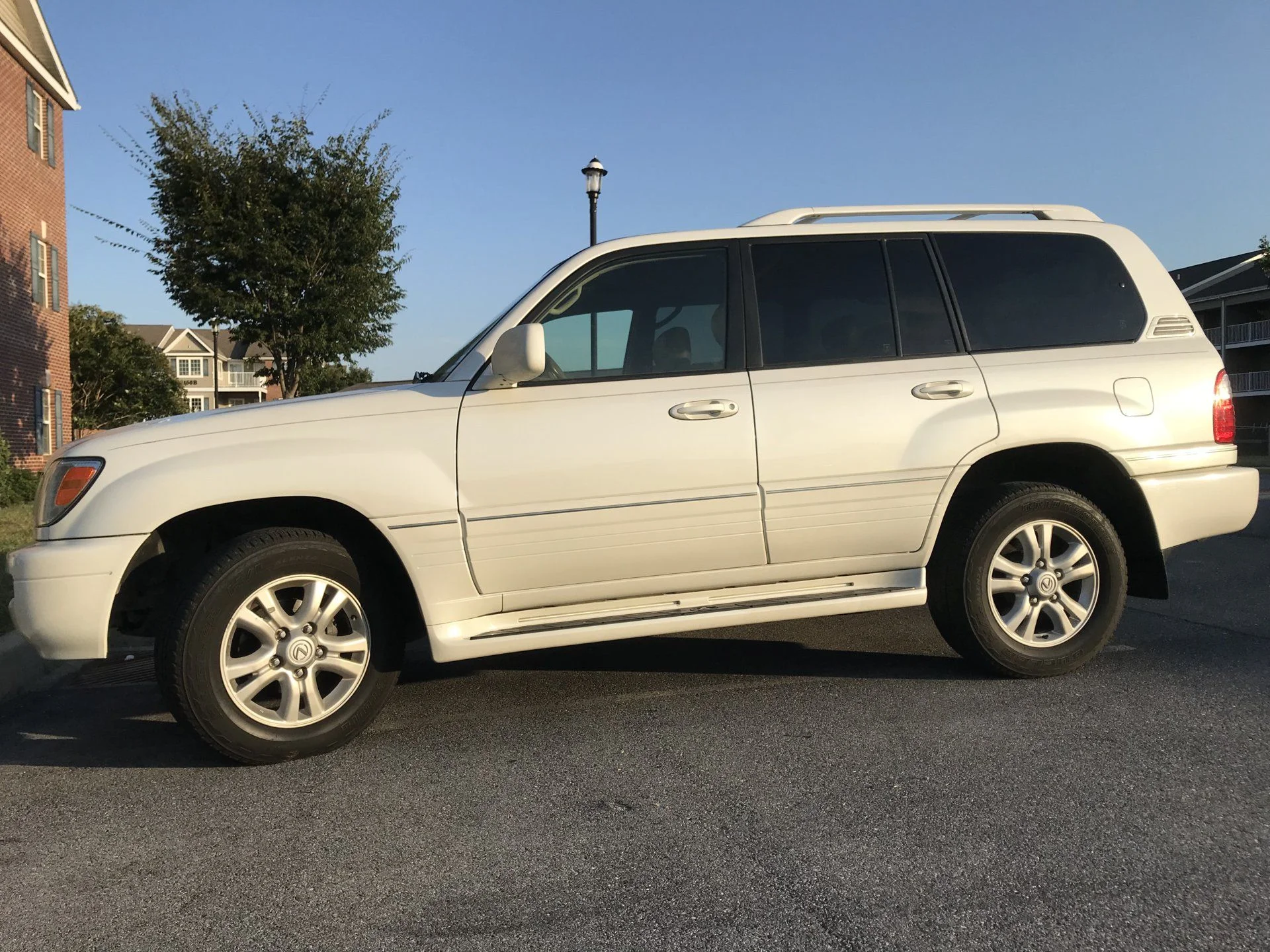

Here it is...
It might be an optical illusion, but it looks like you've got more rake than you should. My truck looked like that when one of the rear sensors went bad.
Definitely an illusion. Its parked downhill. Otherwise it sits level.
Looks clean. Congratulations and welcome 🍻

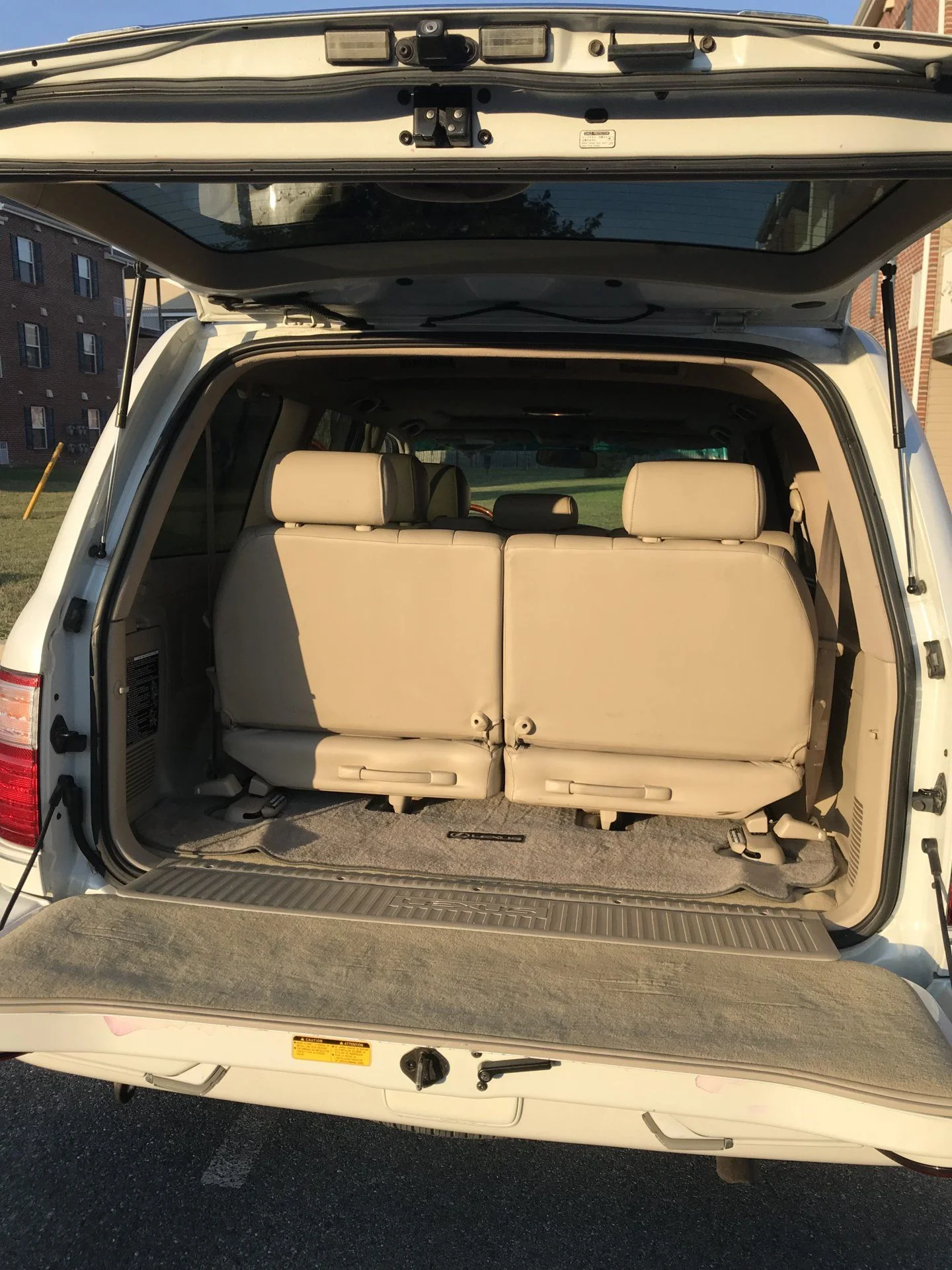

Thanks everyone. Yes the truck does looks really clean now that it is washed. The pictures dont do it justice.

It looks like we're right in the same boat with really similar LX's. Your seats look really nice!
