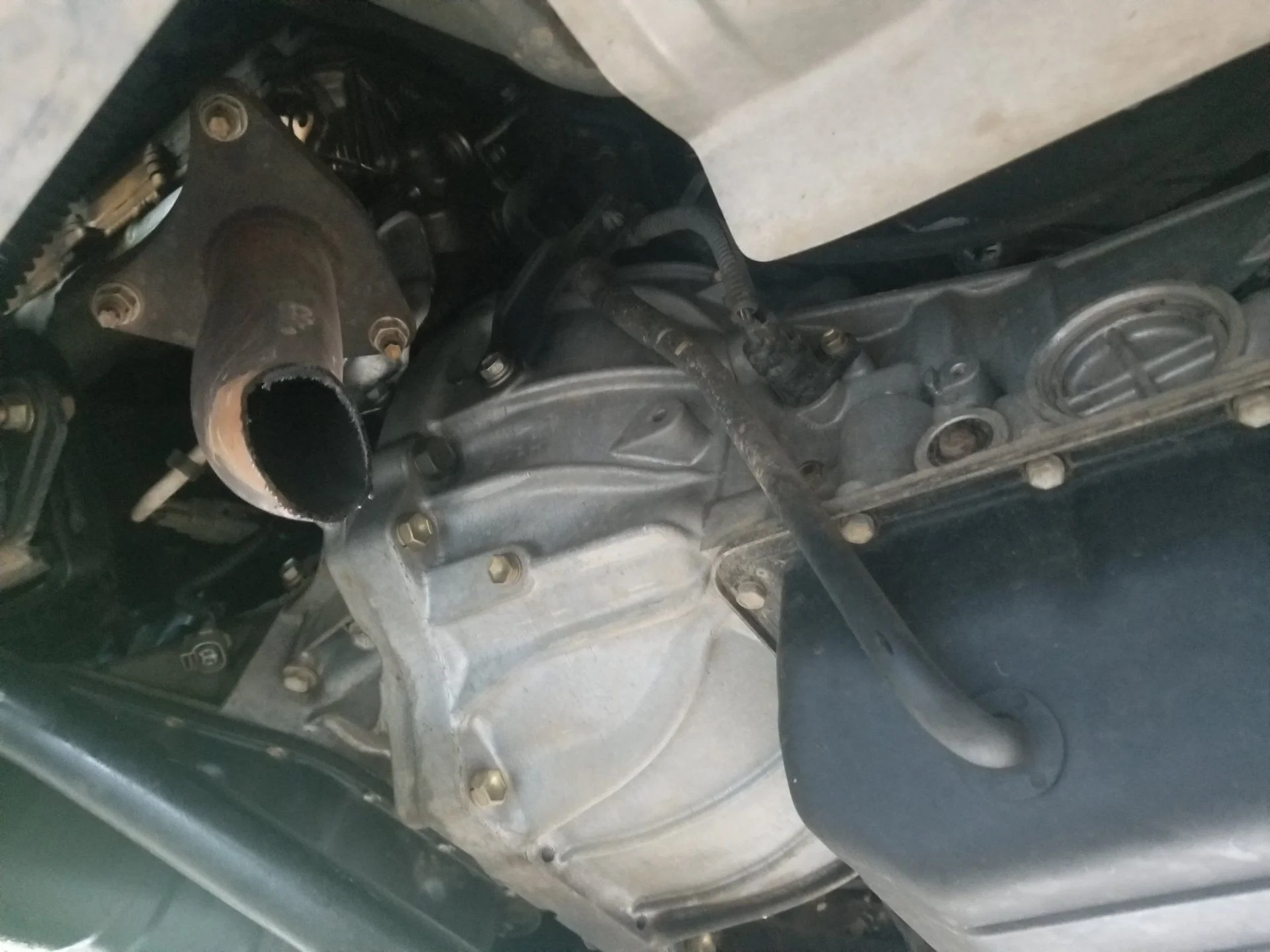

Someone chopped both my Cats at my apartment complex. I figure my options are the following:
1) Insurance claim to get OEM cats... 3-4k
2) out of pocket aftermarket Cats (anyone have recommendations?)
3) I'm all ears to other suggestions
I have another vehicle so not in a huge rush. I plan on keeping the truck another 5 years.

PM'd you... I'm not on CSC would you mind giving them a heads up? For those without a garage, not sure what we can do except skid plate with tamper proof bolts or a Cat Clamp
It is shockingly common. Welcome to the big city. Walker has been the best of aftermarket in my experiments in cats. They are $265 each on Rockauto
Sorry to hear that. Happened to my old 4Runner when I lived in a hoodish neighborhood in ATL. I came out in the morning, none the wiser, and cranked it and was pretty shocked by the noise. Figured out what happened and took it to a local place and got a new one installed. Afterwards, I bought and installed this product to prevent it from happening again CatClamp Catalytic Converter Theft Prevention Lock
Look at Magnflow High Flow Cats. I just put a pair on my LS swapped LX450, and they are great and around 100 bucks each
You'll need to match the collector diameter and find a shop you trust to install them.
This happened to me a few years ago, was super bummed at first but in the end, $500 deductible and my truck got brand new factory cats. Easy bolt on, actually made money by doing to work myself in less than an hour.
Did you have any issues with insurance going up? Another thing I'm afraid of is them coming back for round 2 in a few weeks after fixing it. Do you think they'd chance it?
I have a pair of factory cats/piping in great shape from my 01 lx that would bolt in. I would need your old header flanges, but I would sell them cheaper than your deductible. Im in the NW valley, let me know if you are interested.

I guess if you were to steal cats, the cruiser is the easiest one to steal from. They're high enough that you can just crawl underneath and sawzaw it out in seconds. Used cats are worth some money, we sell them at my shop after replacing it for a customer. Some honda accord cats can fetch us $60 each.

Wow, that sucks! I'm in Gilbert and have two cats off a Toyota Century that you're welcome to have, they just need to be welded in.
For the U-Haul fleet we started welding rebar cages over the cats in areas where they get stolen a lot.
