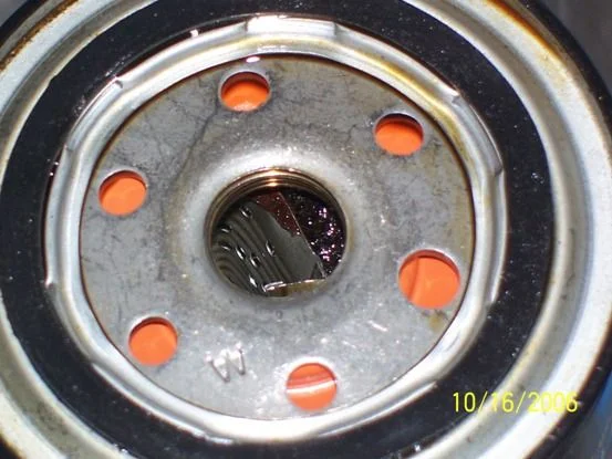

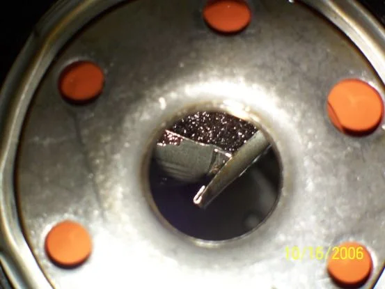

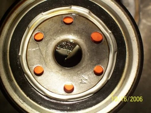

I changed the oil on my 94 the other day, and found that the oil filter has what looks like a failure in the lining, as if the pressure through the little holes was too much, and it caused the filter screen to buckle. (see pics)
This filter was on the rig for about 4500 miles using exclusively Delo 15w-40.
I have always heard good things about Bosch products, but this is a little disconcerting.
Questions:
Should I be worried about crankcaase contamination and do an oil flush?
What would cause this?
Also, the cruiser has never burned any oil, but two quarts disapeared the other day driving to CDA. would the defective(allegedly) filter have contributed to this? It hasn't burned any more oil in two more trips........
Sorry for all of the questions, and thanks for any input you all can provide,
Dan

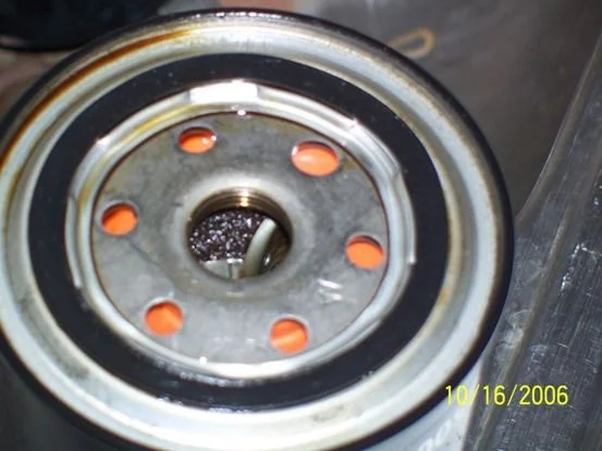

A couple more pics and one last question. Does the oil flow through the big hole and then out the little ones or in through the little ones and out the big one??

The oil flows in the little holes nd out the one in the middle,
I doubt bosch actually made that filter, they put thier name on a lot of stuff they do not make. the AA stamp lease me to think it is a champion labs, and not the POS E-core variety, ushually a good filter,
are you sure you have the right aplication? a non bypass equiped filter installe don a 1FZ might do something like that
I would shorten this oil change interval to 1,000 miles or so, after than just change normally, buy OEM or WiX oil filters from now on,

Other than getting reduced filtration on this cycle due to the oil pouring out the area of filter media we can see, I see no harm from this. If a bit of the filter media did come loose and go into the pan, it would be caught on the next pass through the filter. So, you're likely back to a normal oil/filter cycle now rather than waste money on a short cycle. Assuming you put a good filter on this time.
I think that was a manufacturing defect (unless you're positive you looked in there before installation and it was fine) and you put it on like that. I'm not in the habit of visually inspecting my filters before install, either. I cannot see that happening from operation because it's a metal structure and they can withstand more than the oil system PSI can put out. That's where these cheap filter innards (think Fram) are a bad idea - they can be overpowered.
I thought about your oil consumption and cannot reconcile any link with this unless a piece of filter media somehow got sucked up by your PCV valve as it floated past unscathed through the whirling, mashing valve train. If that happened, crankcase pressure would rise and oil would get forced by the rings and burned in the cylinder at a higher rate. That's about all I can come up with on a single cup of coffee this morning.
If you decide to go with Wix, get the 1068. It's the NAPA Gold 1068, actually. I bought a pile of them last month for just over $3! They are the top line model with all steel internals, a quality O ring, fully rolled seams (vs some cheap spot welded), and a lot more filter media than even the normal quality Wix.
DougM
I wouldn't sweat it much, our motors don't make much junk and the chance of motor damage from this is slim. But I would contact Bosch, file a complaint and send them the pix. Then bag and keep that filter in case of the slim chance of motor damage that can be traced to the filter.

Since your truck dictates 10-30 and you used 15-40, could it be that the start up pressure spike drove the filter element array? I've seen start up pressures in the 150psi range (the gasket is rated for 300psi), which means that you absolutely could have compromised the filter pleats.
I did a test several years ago and cut up the Bosch filters, Mann and Mahle. The Bosch was aboslutely the worst of the three, and the most expensive, even wholesale. I'd be careful of the NAPA filters as well, that's not a given supplier, that's only an approved supplier (ala Bosch).

I seriously doubt that this failure has anything to do with excessive oil pressure, looks like a manufacture defect. The pump to relief ratio is well designed, even with 15W-50 in mine I never see higher than relief pressure. Depending on temp 15w-40 is within the factory recommended range.
I agree, if you had a overpressure issue (i.e. a stuck pressure relief spring), you would have seen the o-ring blow out or the filter split. This used to happen with M10 engine BMW's using aftermarket filters, specifically frams. It is was what originally caused me to abandon fram and go OEM 15+ years ago.
