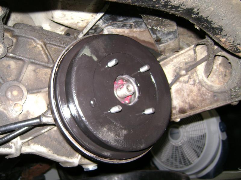

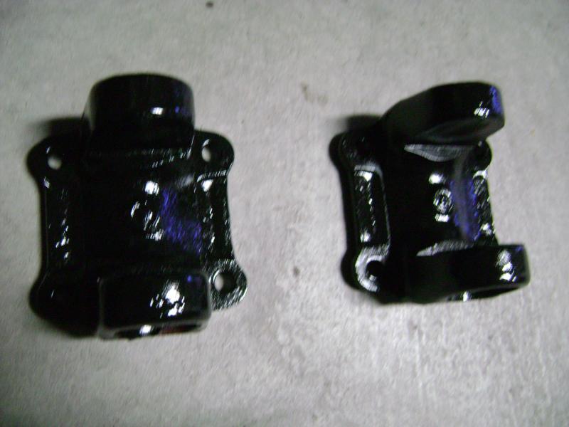

More painted stuff...thrilling I know! When the paint cures need to install the U-Joints. harbor Freight has a tool for $39.00.
Looks GREAT!
I LOVE PAINT! Its amazing what a little elbow grease and love will do for these old parts. I spent yesterday afternoon stripping down my front leaf spring pack and descaling the rust and crap. They will get painted and look brand spankin new for a minute or two.;p
Nice to see progress!
