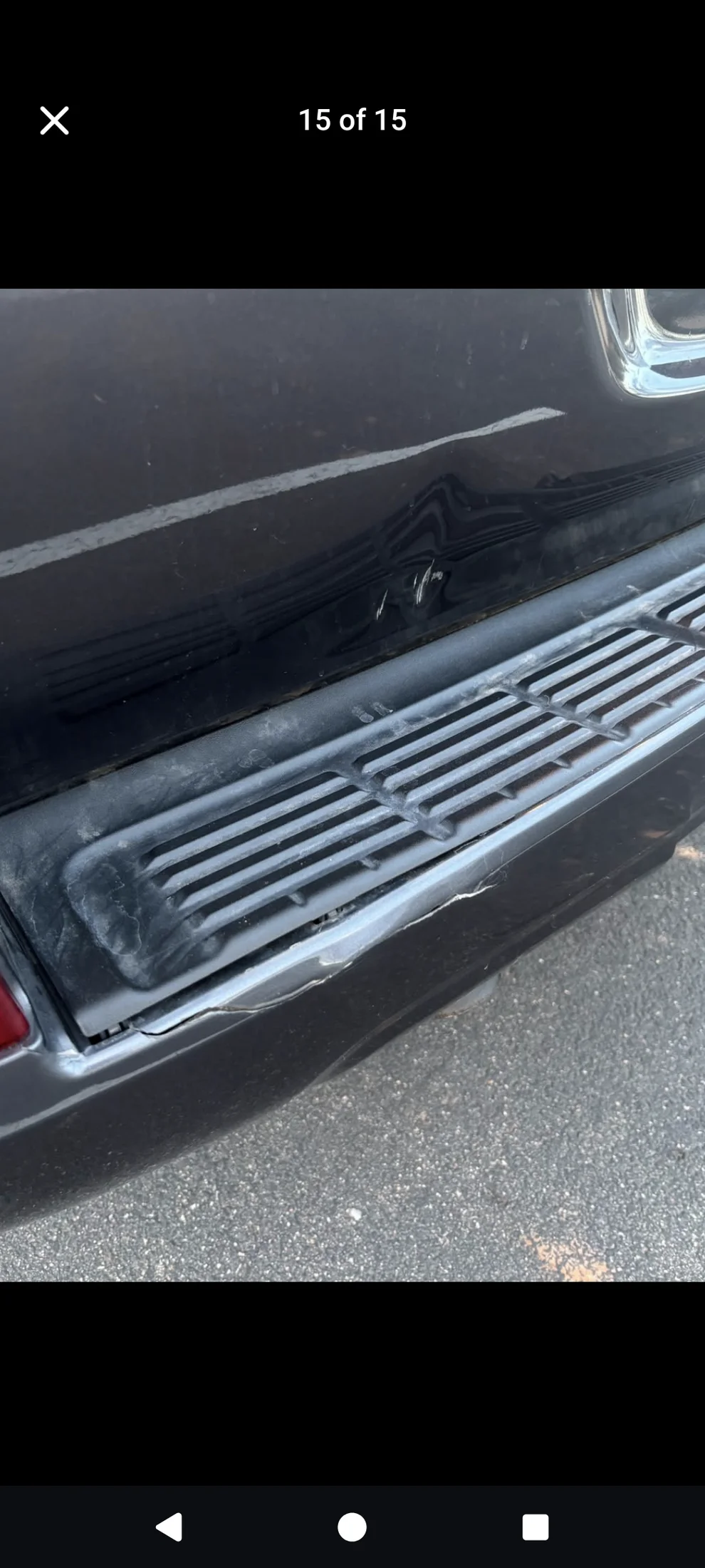

Good morning all, I am looking to join the 200 series fan club /owners club. We are looking at a 2016 Land cruiser that has damage to the rear. Would anyone have any idea on the estimate to fix this? How much should we ask from the seller for compensation to replace it? Also, we are located in The southeast suburbs of Denver. Is there a shop that anyone would recommend for mechanical work/ body work on a Land cruiser in southern Denver? Thank you all in advance for your help.
At a minimum, you'll need a new bumper skin, and paintless dent removal. The tailgate dent will almost certainly require some filler/sealer/primer/paint/clear, so I'd budget at least $1500-$3000 USD to make it look as new. It will definitely depend on the shop and ultimately the extent of the damage, which two photos can't really provide.
