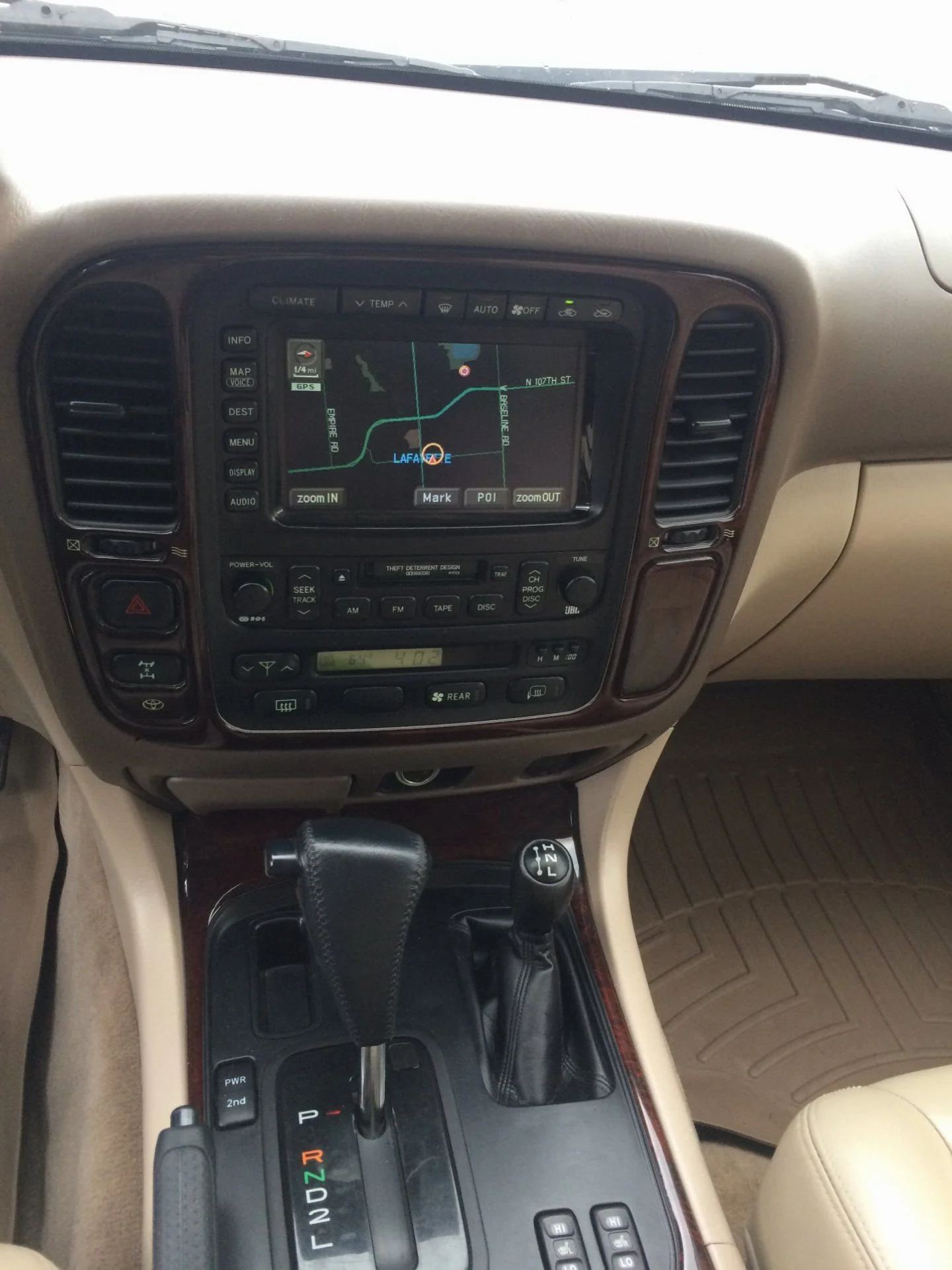

Hello,
I'm back in the LC world after a rusty 60's series experience (I learned my lesson about painted over rust on the frame - no car fax back in those days). We're flying out soon to pick up a 2001 LC and driving it back to the East Coast. The question is - how do I get bluetooth (or wired if that's the only option - btw it's one of those new fangled iPhone 7's) into my land cruiser. I believe this cruiser has the 6 disc changer. It has the nav and the tape deck in the dash. I don't want to get into replacing the entire head unit, just adding bluetooth.
Thanks - appreciate it!

Thanks for the input. I am a little concerned about audio quality with an fm transmitter but if it sounds good then that's the easiest way to go for sure. Any idea if the Crux BTS-TY1 will work with the CD changer in the glove box? Looks like you had the changer in the dash. I'm assuming both have the same type of input in back of the head unit.
I'm in the same boat as I recently acquired a 2001 with the same setup (NAV, 6 disc changer). Despite having the HVAC controls as part of the GPS screen, there are still some decent options. The Grom VLine will work for this year (website says 2003+) but I am using one now and it works. It's great for Bluetooth, but doesn't give you a handsfree phone. Carplay works, but the echo the caller will hear makes it essentially useless. If they can fix the software to provide noise cancellation then it would be a nice solution (even though the phone must be tethered). But at $500, I'm of the opinion it should be more stable and offer a handsfree calling solution. The other options are to add and aux input by either emulation through the CD changer or cutting into the tape deck heads, which would be pretty much a DIY job. The last option I am aware of, and currently leaning mostly towards, is the "68 ohm resistor mod" (search for this). This allows for an aftermarket head unit where the tape deck currently resides. Good luck!

Sorry about the delay. After some time with a Crutchfield advisor and my "new" LC dash taken apart in a parking lot in Boulder it turns out the BTS-TY1 will not work unless you have the CD in the dash. I'm still on the hunt for a solution. I've been using an FM transmitter which works okay for music but for podcasts and anything you have to turn up the volume you can hear a clicking sound in the background that is not super great. Anyone else figure out a solution? Wired (new iPhone), or bluetooth - I don't really care at this point.
