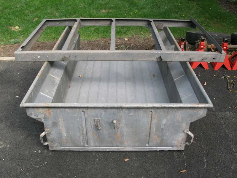

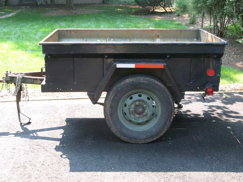

Had my trailer dipped. Agree with Red Camel, dip somethings and blast others. If your plan is to re-seam seal everything then you might just dip everything This trailer had some mil spec paint that paint stripper would not remove but the dip removed everything.

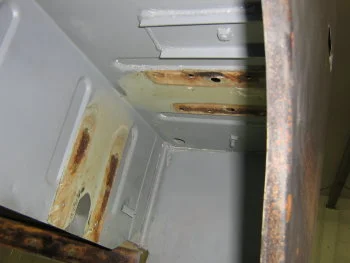

Also-make sure that you can protect the cleaned surface shortly thereafter. Dipping will not reach all of the places in your cruiser that need to be looked at. For instance the rear sill, it is best to remove the inner channel as this is spot-welded so closely to the outer tub that dipping will not get at everything and you cant flow something into that space after the you have dipped-it anyway. I have attached a couple of pics from my current project. This is from an Arizona only truck and this is what was lurking under the wheel well supports.
The factory construction technique bonded raw metal to raw metal and left the inner surface untreated. My guess is that Toyota had no idea that there would be nut jobs like us caring for these things 30-50 years later....
One last thought-unless every seam has been separated, stripped, treated and rewelded there is no such thing as a rust-free Land Cruiser. They all rust.
