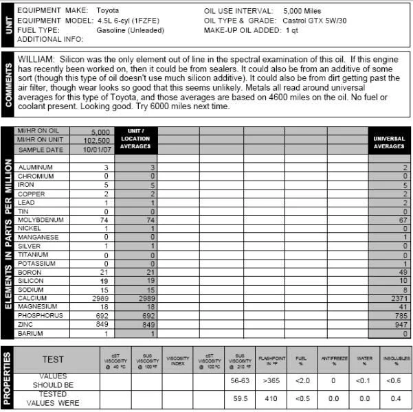

Blackstone Engine Oil Analysis - High Silicone
Jan 12, 2006

I don't really have any concerns - though I'm curious about the silicone. Mostly, I thought I would post up the results so there are more comparison options in the future.
I did the analysis b/c I was making a change from dealer service with the Castrol GTX synthetic 5w-30 to doing it myself with Mobile 1 Diesel Truck 5w-40. I will do a second analysis after 5k.
FWIW: No work has been done on the engine (ever actually). The last oil change was done by the dealer and included a new Toyota air filter.
I don't know enough about the universal averages to know what is considered "high" vs just higher than the UA.
Another great 80 report, these engines are just easy on oil. The most likely cause of high silicon is an intake leak or K&N air filter (lets dirt in).
BTW, Castrol GTX is a mineral oil. Again showing 5k changes on mineral oil in this engine are a walk in the park and it is unnecessary to go to a synthetic unless you are running longer intervals.

Once again, mud members prove their knowledge. I did run a K&N air filter for about 8k miles. Then read of its disadvantages here on mud and dropped it for the factory filter. Any chance the silicone could be from an accumulation of dirt getting by the filter during that 8k - and still some in the engine after 5k of running on the OEM filter?
If not, I'll check the air intake very closely. I suppose a crack is not uncommon in an 11 year old system that experiences swings in temperature.

BTW-I'm no expert on oil analysis, but with an iron of 5 and a lead of 1, you have virtually no important wear in your engine. At that rate it will last 500k miles..
I agree and I'm on board now. I certainly hope you are right and I still have the engine at 500k!
