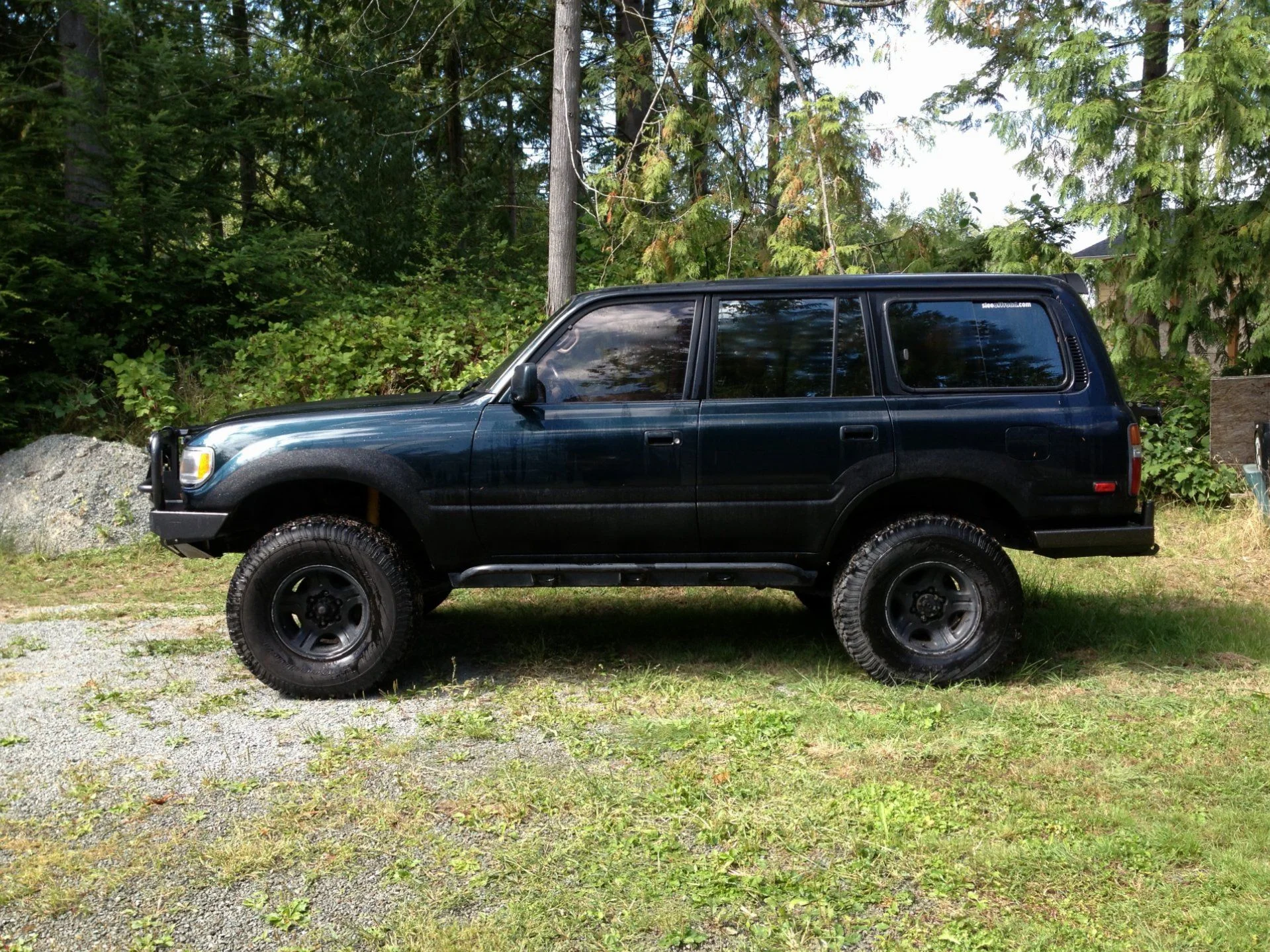

Take a look, this was my green 450 decladded & poprivots shoved in all the holes.
I beat on it harder than either other 80 I have, and the lining held up great.
