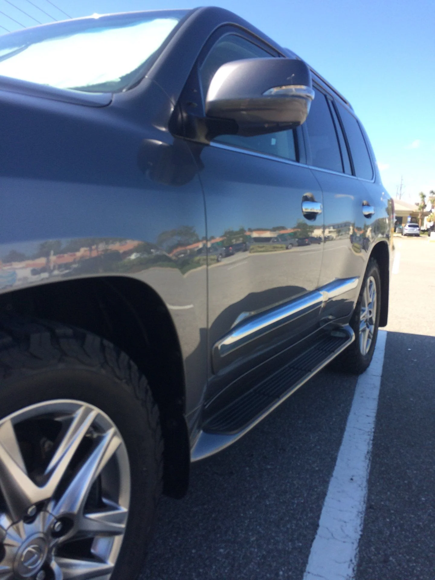

Correct. I'm running Tundra SR5 + spacers netting out 35mm and I scrub at full lock and in reverse. It's super minor though.
This is with rear mudflap removed.
