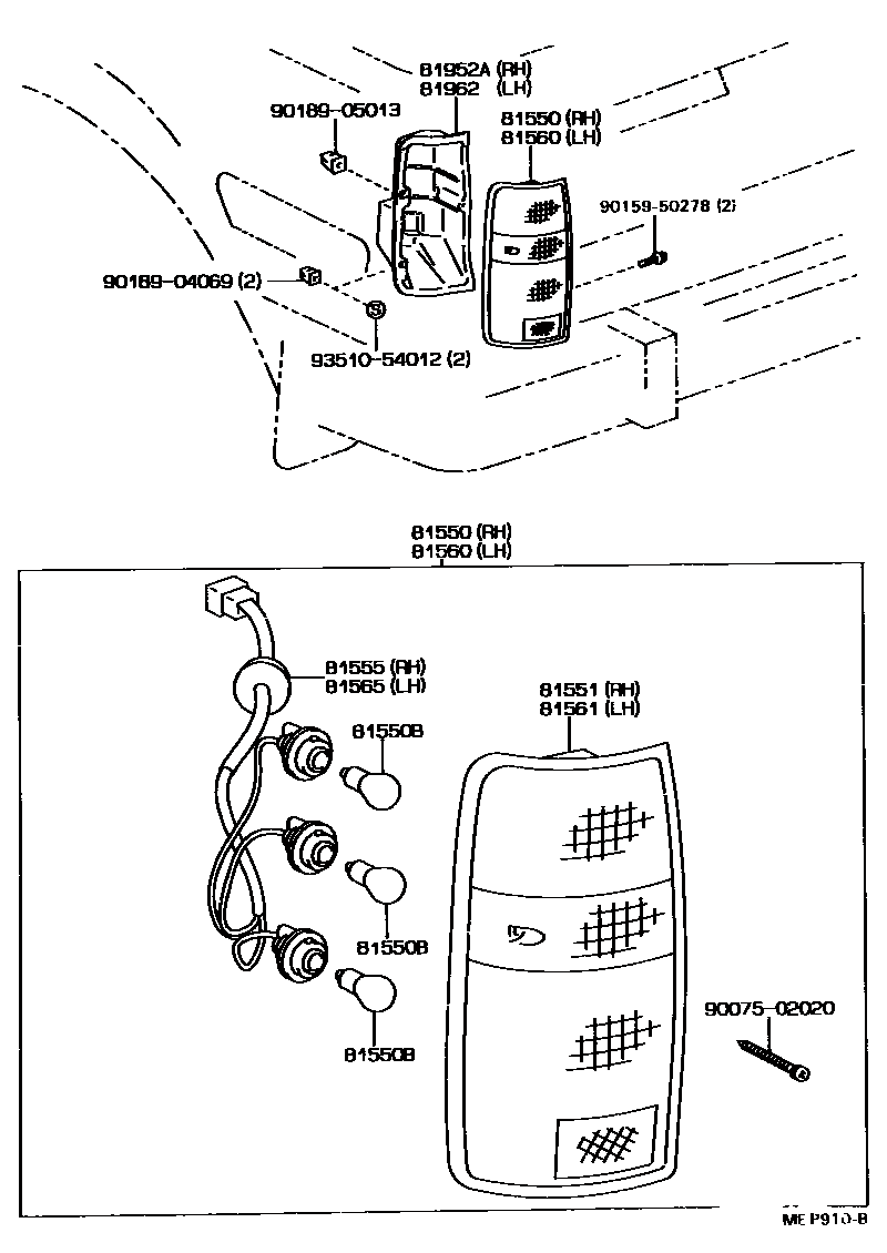

What is the Black Plastic trim piece that surrounds the rear tail light assembly called?

Are you referring to the visible rim around the lens or the black housing behind the lamp?

Which is not serviced, you buy a lamp to get it.
If you're talking about 81952A / 81962 Toyota simply calls it "Cover, Rear Lamp"
Yes it is the black trim piece visible around the lens. I didnt realize it was part of the light assembly as I hadn't taken it off yet.
