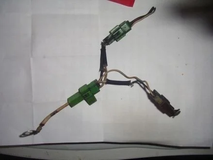

The big $60,000 question is how do you tell what's a fusable link? I was able to talk to Sheldon last night after he got home from work. I hope I can get off work early enough to try and find what I think is a fusable link to replace a wire that got smoked, probably the fusable link?
This is a fusible link off a BJ42. The wires that are covered in the black insulator are the fusible portion.
hth's
gb
I replaced the fus link on the 70. It's right off the + to the first green connector (black goes to a little Stud terminal) there are 3 fusible link wires. I can take a pic if you need. YOU will know if they burn because they will smoke.
even with my electrical fire storm the fuse link didn't burn though all the way and I could still get enough juice to crank. The Fuse link is availble in the US sytem and is only like $7. I can post the #'s tonight if you need them
Wesintl
Yeah, that is what I thought it was. The smaller wire coming out of the green thing is what smoked. The other wire is in pretty bad shape too, about broke through. Will have to see if I can get it apart to replace those wires. The parts stores here have these, but they are not given any kind of rating, just wire size, so hopefully they will be the right size/rating. Will have to try the part number when I get a chance. Thanks.

That's why I ordered a new fusible link from toyota. Trying to figure out the rating was too much. Your dealer might have just the wire too. I think mine did but I opted to wait on the whole new fuse link. I almost bought 2 for the next time, but I didn't want to jinx myself :D I probably have half a dozen from 60 links I could pull a wire from if needed. The 60's won't work because the connection is different.
anyway good luck.. I at least I got the number good for you :)
Update. Well, I replaced the two fused wires coming out of the green connector with generic fusible links based on wire size for a temporary fix. I got a new connector/with fusible links on order. Everything is back on power wise, but I don't think The Alt. is charging. I hooked a volt meter to the 24V pos. terminal and turned head lights on and the voltage started at a little above 24V but it kept creeping down. Is there something I need to do still? Or is the voltage regulator now fried? Any ideas? Thanks.
