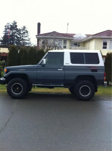

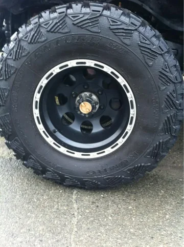

Suggestions with bj74 owners. Lookin to do an soa lift with mine and just want some experienced owners to tell me what they think. I already have the ome lift put in last year and running 33x12.5 with no gears or mods yet. Doing the egt and boost mod this week. I do plan on also doing gears for 35-37 tires with a lunch box locker in the rear and move the LSD to the front after a very good clean. Now my rig is also a daily driver so any opinions are great. My back yard is nothin but old road and trails with a lot of snow. Luv this truck just want it to perform to its most extreme with lots of flex but also worried about floppin it on its side or rear. Also it's an automatic. Thanks guys!

Thanks guys! I do appreciate all the suggestions. I do love the ride of the full ome kit but would love to get a few more inches out of it. I know I do have to move the front axle forward but another one is do I do a body lift? Ahhhh. So frustrating cause a lot of the guys up this way are on soa lifts and I do love the look of the truck sitting up a little higher. I love the build that lauenbrau has on his. I love that truck!!!! Now where and how much would cable lockers run me? Where do I find them? I do have some wheels that are backspaced and work perfectly that I bought from Steve from Ebi. Give the cruiser a nice wide stance so no spacers needed.
