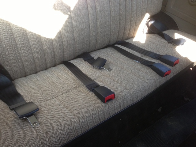

Our JDM spec truck has a great fold and tumble rear seat, but no seat belts. I have three boys so need three belts back there. For one week I had them held in with ratchet straps. (my wife thought the straps were stock Toyota from Japan. he he he)
Belts.
I already added rear seat belts to the back seat. With the seat being a fold and tumble so I wanted to keep the belts doing the same. I CNC plasma cut a custom tab and welded them to the back of the seat frame. New 10.9 side bolts and a tube spacer completed the set up, along with three new OE style replacement lap belts. Now when the seat is folded and tumbled forward, the belts also go with it keeping a clean floor. This also makes it 10x easier too when the seat is folded back down as the belts are always ready to go.

Can you provide a photos of the side bolt/spacer in place and the rear tab(s) in place? I like the functionality of your seat belts.

Rob, its no top secret parts. Happy to share the bits. If there is enough request we can do a kit for them. The key thing is the custom tab's since the do weld to the frame. It makes for a very clean install. The new lap belts also have the Toyota style push locks, so that's nice too.
