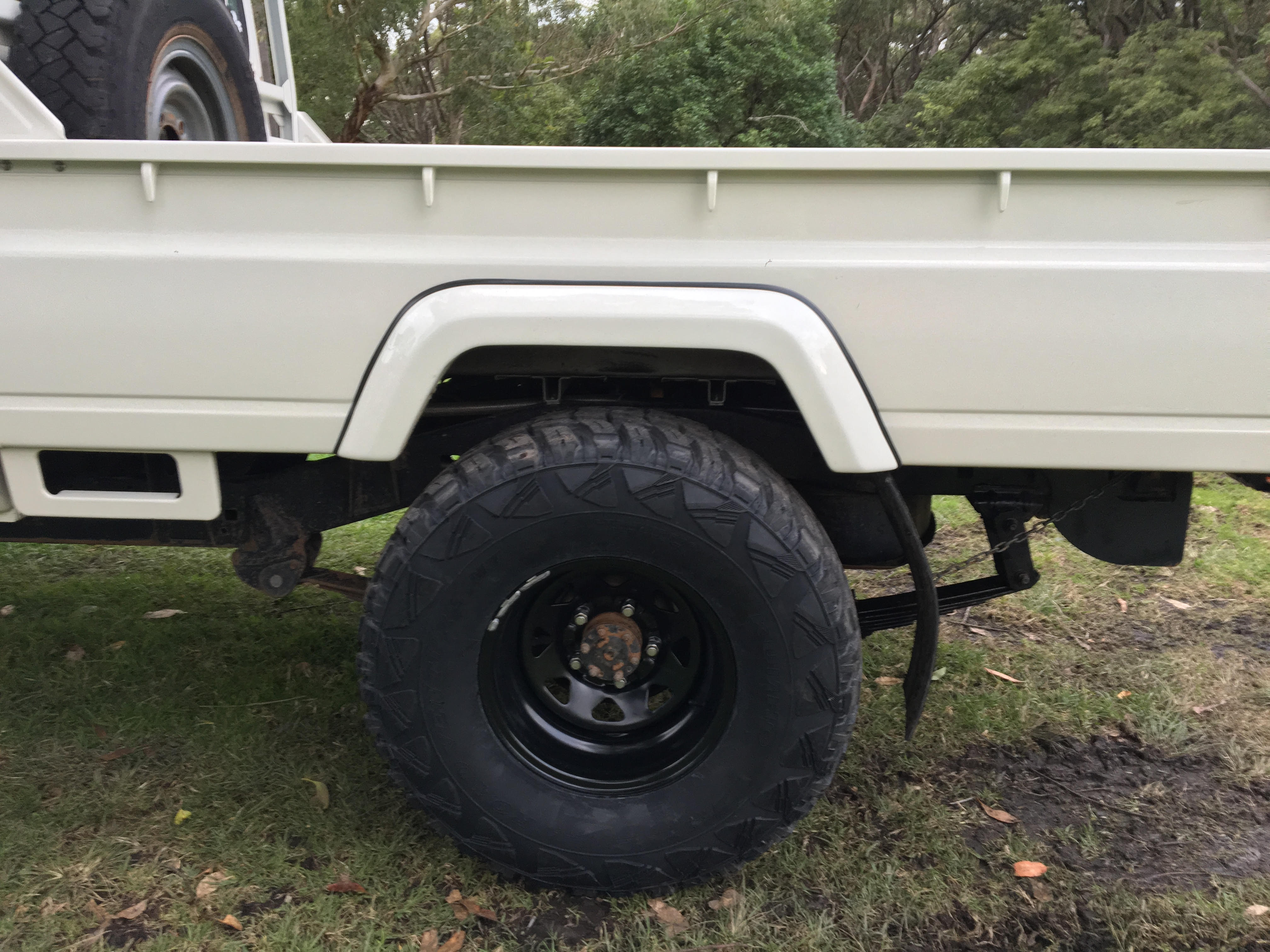

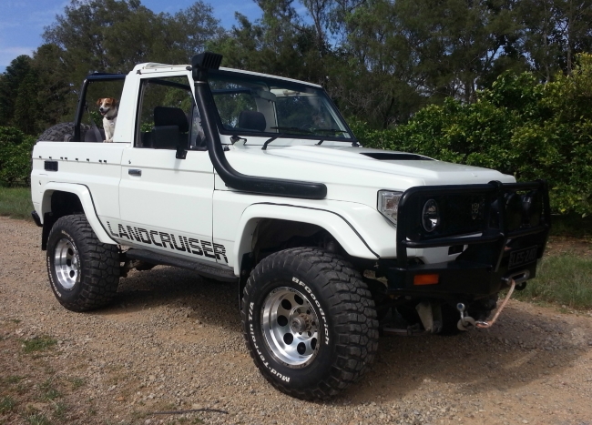

A couple of pics to show style and how much they stick out. I'm running 285/75R17's on 9" rim.
so basically a 11" wide tire. If people think it should be wider? I personally don't think wider is better.
The bottom pic is a set of 33/12.5R15's on a 10" rim

These are not OEM. The OEM flares are very expensive, but also require a bunch of holes etc
and brackets. There are 22 holes to attach the OEM flares.
The flares on my truck are a light single piece fiberglass that are attached with 5-6 screws through
the wheel well lip. They fil well and cover the tires.
