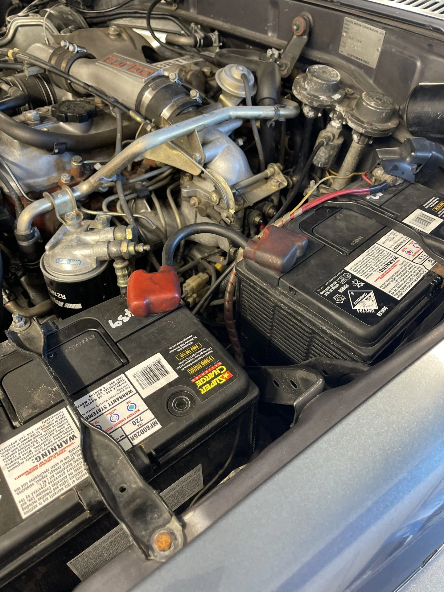

Battery out? The screw is near the top of the pump, I screwed mine in all the way, goes good now.
thanks Hulsty, your posts have been what I’m referencing. I’ll keep screwing it in and see how I get on. It’s 24v if that makes a difference? I cant get in there without removing the second bat and the horns

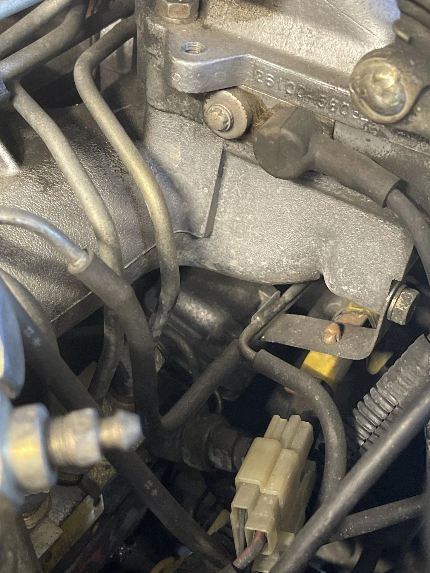

The fuel screw is on the top right hand side of the pump here?
