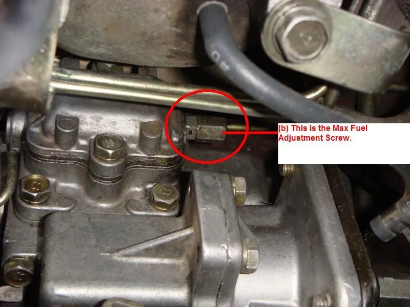

This second picture is a more close up. I am using the picture ‘close-up’ tactic since Fuel Adjustment Screw is located in a dark spot and a single picture will not help inexperienced people to locate this Max Fuel Screw.
(a) Is the boost compensator adjustment screw. To adjust you will have to undo this cap-bolt. Underneath you will find an all-thread (a rod with threads all over) and a lock nut holding this ‘all-thread’ to its position. This all-thread had a tooth like head and you need a plain screw driver to do any adjustments. You will need to loosen up this lock nut then you turn the all thread towards the engine for increasing fuel. Do it the other way and you decrease the fuel. Actually what happens here is that when you turn it towards the engine, more fuel is delivered under lower boost. Remember boost compensator increases fuel only under positive boost pressure. Thus this tweak only improves performance under boost pressure i.e. when the turbo kicks in i.e. above 2000rpm.
Max Fuel Screw
Finally, the Max Fuel Adjustment Screw. The adjustment of this is similar to that of the boost compensator. You remove the cap-bolt. You will find ‘all-thread’ underneath. You can also see the lock-nut in place (the nut with a hole, just after the cap-bolt) in the picture. Loosen this nut and turn the all-thread towards the engine for increasing fuel and to reduce do the opposite. Again, you need a plain screw driver to turn the all-thread in any direction you want.

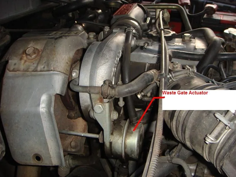

Wastegate Actuator
After you increase fuel you need to increase the boost to see any performance gain. I will not go into details since there is already too much on the working and tweaking/adjustment of wastegate actuator.
