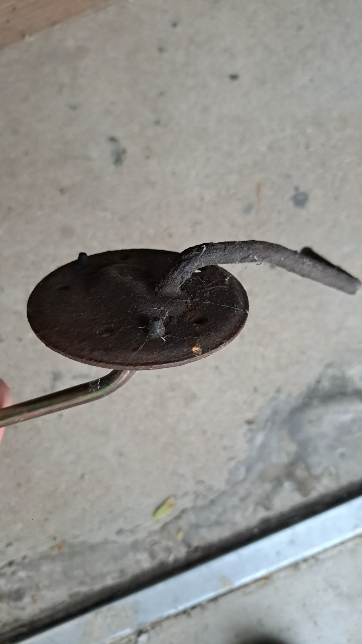

But there is unfortunately one suspect item that's notorious for leaking: The pickup pipe on the tank. It has a bend that has a tendency to rust a hole in it.
(Ask me how I know).
Unfortunately, that sucker is on top of the tank, so you would need to drop the tank ...
(Anyways a good opportunity to check & paint it.)

OK Well I'm back up and running. Been driving it the last 3 days without a single issue. Posting up my results in case anyone stumbled across this thread in the future.
here is what i think truly fixed my issue
-the soft line right off the tank was visibly wet, and the hard lines were clogged up from years of sitting.
I pulled that leaking soft line off the tank. that line essentially runs from the tank into the water separator. I pulled the other end of the line off the separator and tried to blow into the line. nothing. So not only was my soft line leaking, but my hardlines appears to also be gunked up from years of not being driven. this was the moment i realized i was onto something.
-i ran one brand new rubber fuel line straight from the tank to the water separator. No connections, no compromised connections.
