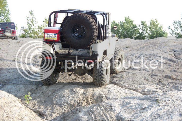

I installed the rear bumper on the BJ42 this morning. That is a 37" Super Swamper on the tire rack and what this rig will be running. The spring over and spring reversal will allow it to clear that kind of rubber. That and some rear fender sheetmetal massaging :)
The lights are optional LED units, Recoovery mounts are 5/8" thick
All tube is 1.5" and 1.15" X .188" wall 1020 DOM
The can rack is removeable
Swing arm has lock pin at spindle that locks in closed and fully open positions.
Tire and rack well out of the way for stepping down off ledges

Here are a couple pics of its shake down run
