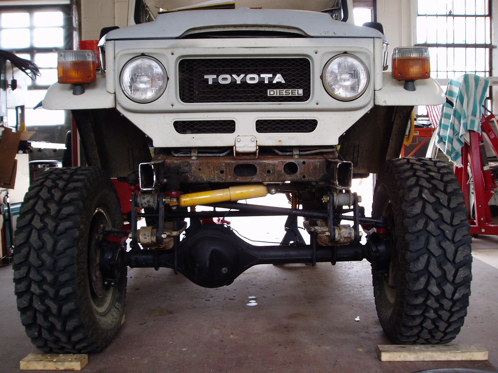

You just never know what will show up at your door. This customer is from PA and has a tight schedule he can pick up and deliver within. So he tossed in the front axle doing a spring reversal and a spring over. This is how it rolled off the trailer. He is going to do the back end when he picks it up.

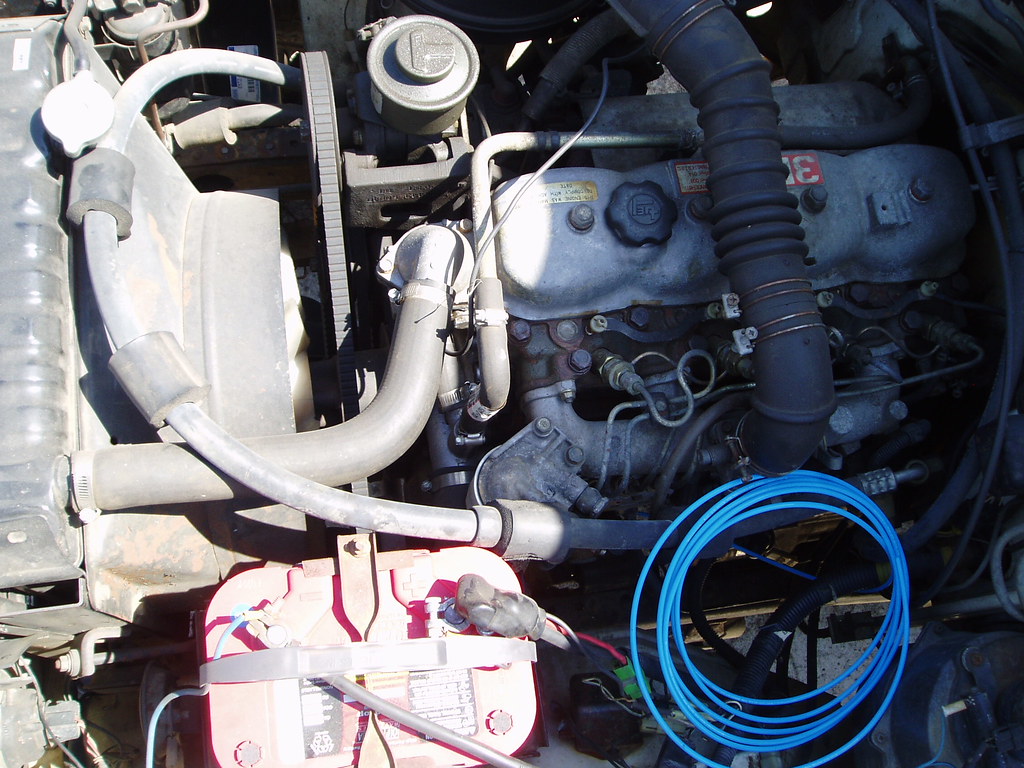

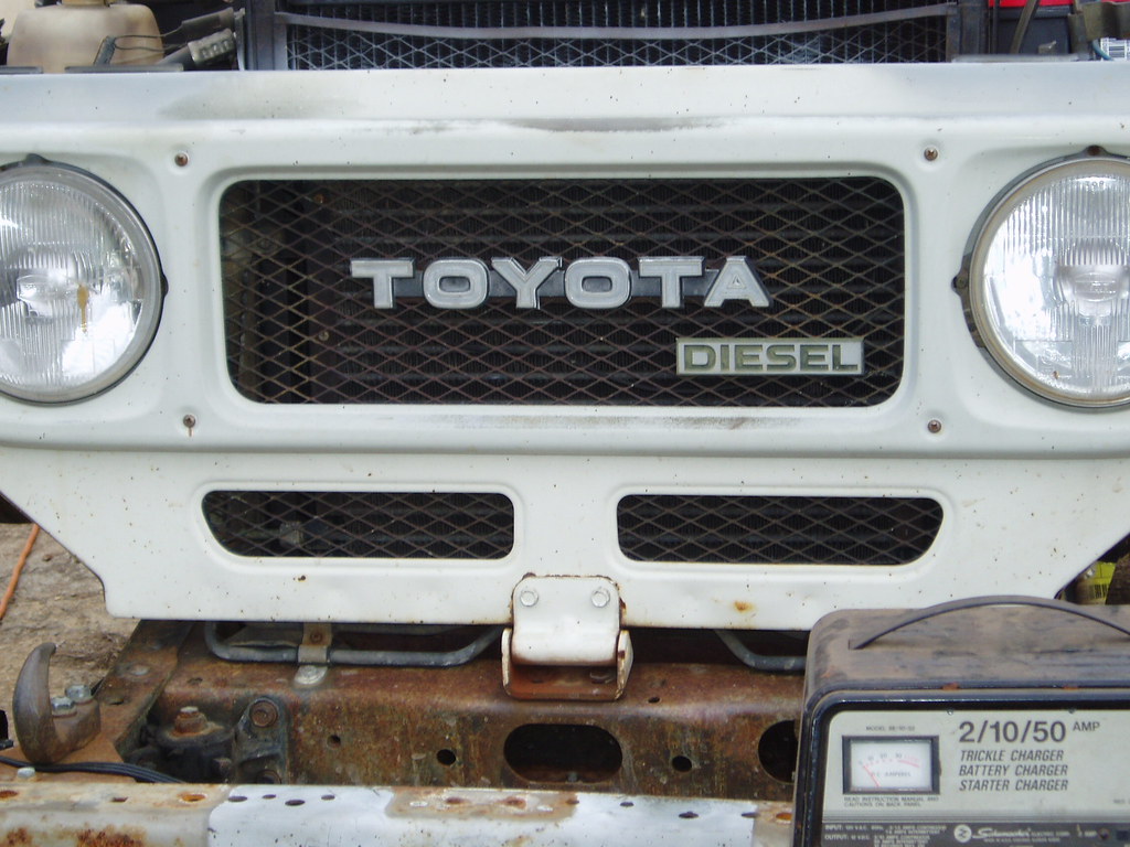

I put the battery on charge and tightened up all the bolts holding the front axle on, all were loose. No gear oil in the rear axle and no front brakes, I won't be doing any test driving.
While it is here it gets a front bumper to customer's specs, rear bumper to customer's specs, a set of sliders and a Metal Tech roll bar kit installed with custom seat brackets built into the cage by us.
It is also a RHD

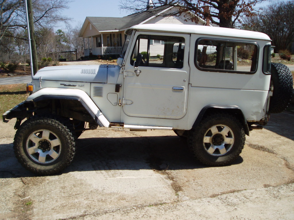

The BJ was a real find. She lived in Australia until 3 years ago. I picked her up from a guy in DC. Very solid.

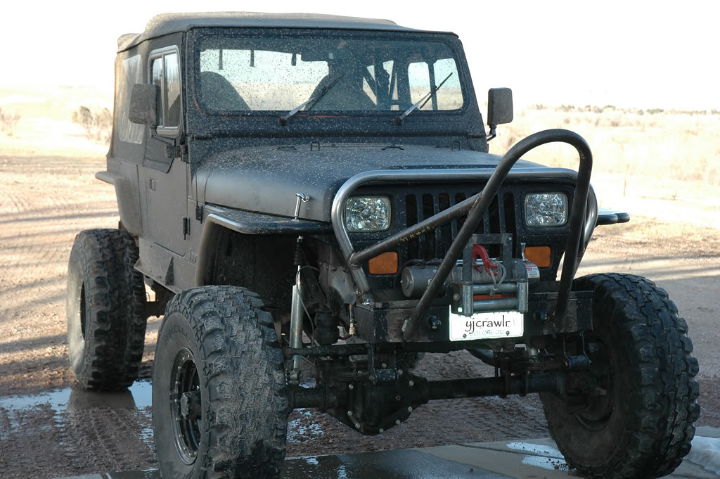

My customer gave me this picture and said, something along these lines will work. He also handed me a Superwinch Husky 10,000 lb worm gear winch,HUGE!.

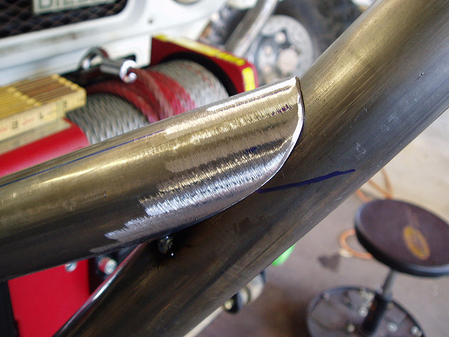

I came up with this. There are a couple gussets not shown in these photos
When you are using tube, your sh!t has to fit! :)
