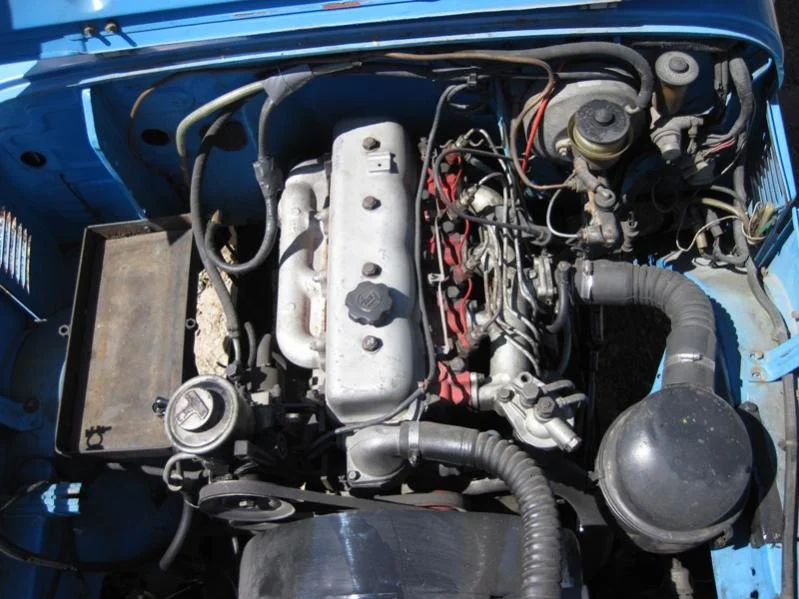

as long as conversion was done properly, it should be OK. in fact i also own an fj/bj40 back home. engine bay looks similar.

I had a friend in the PI that had a 40 with a 2T conversion. I never rode in it, but he said that engine was still powerful enough for driving over there and saved gas too.

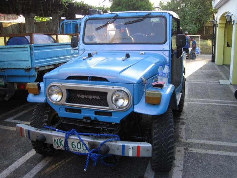

UPDATE!
its with me! the BJ40 is finaly home. will post some pics soon.
some things though..
1. the battery of the bj 40 is a long 12 volt battery.. is this accurate? or are the long batteries 24 volts?
2. she drives fine. i got her on the highway with no problem and i was doing about 85 to 90 kph. a bit wobbly but as expected.
3. i drove her from the province to the city.. maybe a good 90-100 kilometers.
4. as soo as i got into the city, SHE BOGS DOWN!!! i did about 70 to 80 km in the highway but she dies in the city. I ran out diesel.
5. good thing i was with my girlfriend and family driver and we manage to pull the rig into a gas station. upon investigation, my tank has a hole... CRAP!
6. the mechanic tries to revive her by pumping out the air but to no avail.. CRAP!
7. i pull my rig home for about another 20 kilometers or so and finally, she's home.
