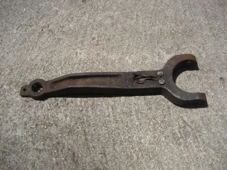

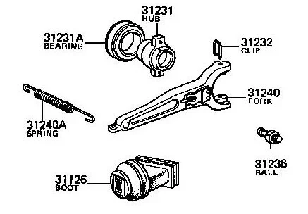

I've also tried adjusting the salve cylinder arm to it's maximum. It now seems like the clutch fork pivot arm is adjusted in to far. Are these pivot balls even adjustable on the BJ40 trucks? (Damn toyodiy.com with their removed images :mad:)
If they are, is it possible to adjust them without splitting the engine and gearbox? Tiny socket possibly? But what size? Has anyone got a photo?
I've attached some images below that may help. I'd love some help here.

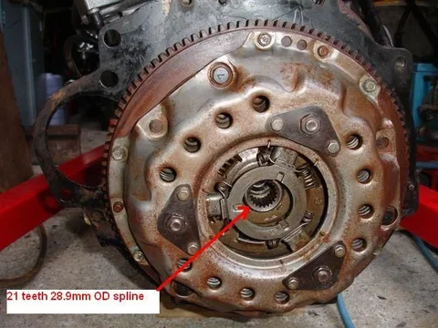

BJ60 pivot adjustment
attachment.php
from an FJ40 i think...
attachment.php
Here are some pics for a 1979 BJ40:
So I don't think the pivot is supposed to be adjusted..

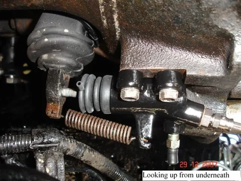

Why don't you get underneath and check the travel to make sure your slave is indeed moving the release bearing far enough forward.
(You should be able to move the fork by hand till the bearing hits the pressure-plate-finger ... so you just need to check the slave pushes it that much further when someone has their foot down on the clutch.

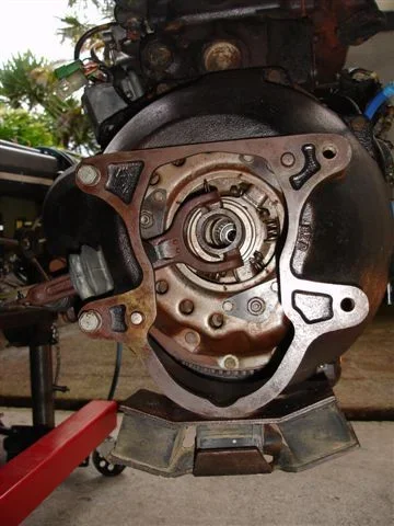

I got a little frustrated with the clutch issues today after I posted this thread and decided to remove the engine to investigate fully. It only took about 1 hour total thanks to having a forklift nearby.
I removed the rad, both batteries and holders, turbo pipes, exhaust, wiring loom etc.
I then did many tests to try to establish the cause of my problem including confirming that the clutch could be manually released with a pinch leaver. I eventually concluded that the PO had installed some kind of non-Toyota cluch / pressure plate. The clutch fork was not able to release the clutch even when on full extension.
I decided to bend the clutch fork arm in a hydraulic press by about 15mm at the end. The then meant that the clutch fork 'should' operate before it begins hitting the bellhousing.

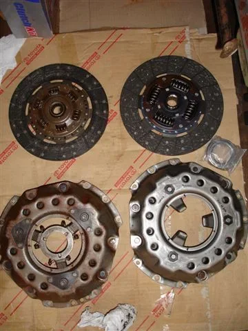

I eventually concluded that the PO had installed some kind of non-Toyota cluch / pressure plate.:
So long as the important specs match OEM, that shouldn't be a problem.
Here's two aftermarket versions that AFAIK both work/worked OK

SOLVED!!!!!
After refitting the engine the problem still persisted so I took it out for a second time.
The time I removed the clutch and it's pressure plate to discover that the clutch was seized solid into the pressure plate. It was so seized that I needed to separate it with a flat screwdriver and hammer.
I've just finished putting the engine back in for the second time and the clutch appears to be working as it rock it back and forth in the garage. I'll put the ancillary bits back in and being it for a drive later tonight. I'll update you guys on how it goes..
