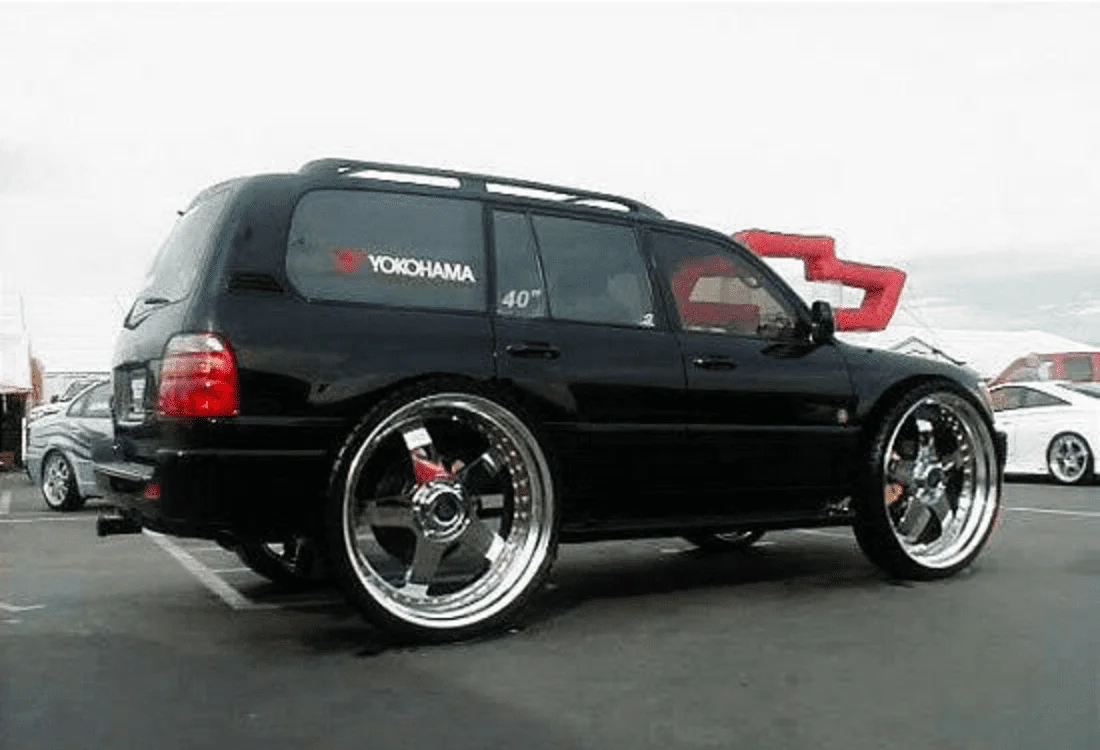

@Jb gay, do some searching via Google Image - there lots (!) of 100s on 22s... make sure this is the look you're after. 4-6" larger than stock will make a pretty noticeable difference in the ride as well as the look
