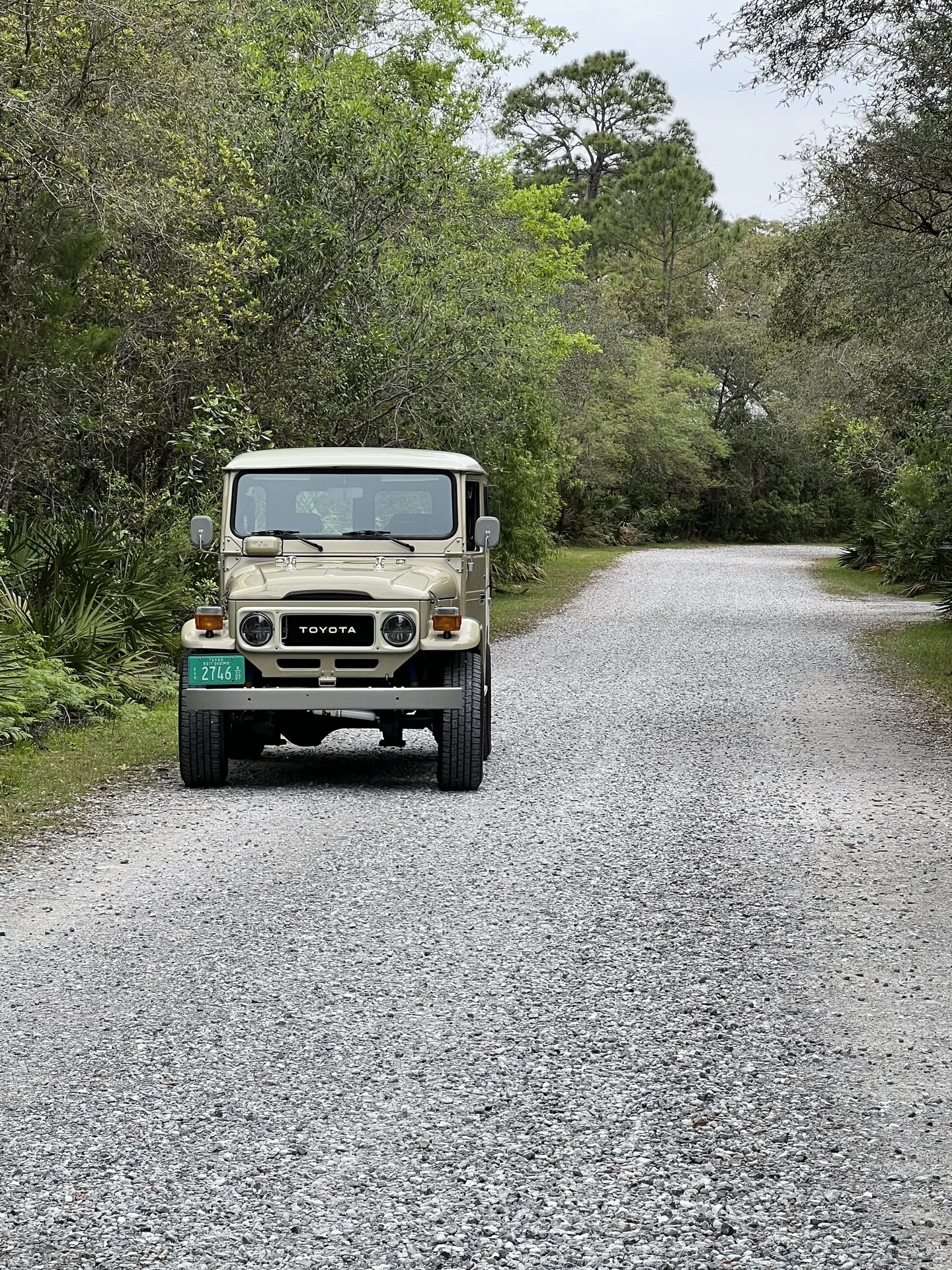

I've run both, one after the other on my 40, first the MT then the AT (still currently on). The MT were great for pretty challenging wheeling (Poughkeepsie Gulch Trail, general Moab trails, etc.). They were noisy on the highway. Did well in wet conditions, OK but not great in snow, bad on ice. The AT's have much better manners, are more quiet, and do fine in general off-road conditions. We don't have that much sand here so I can't speak specifically to that but overall I prefer the AT's for most everything so far - but if I did Poughkeepsie Gulch trail again or similar, I would want some MT back on. Hope this helps.
