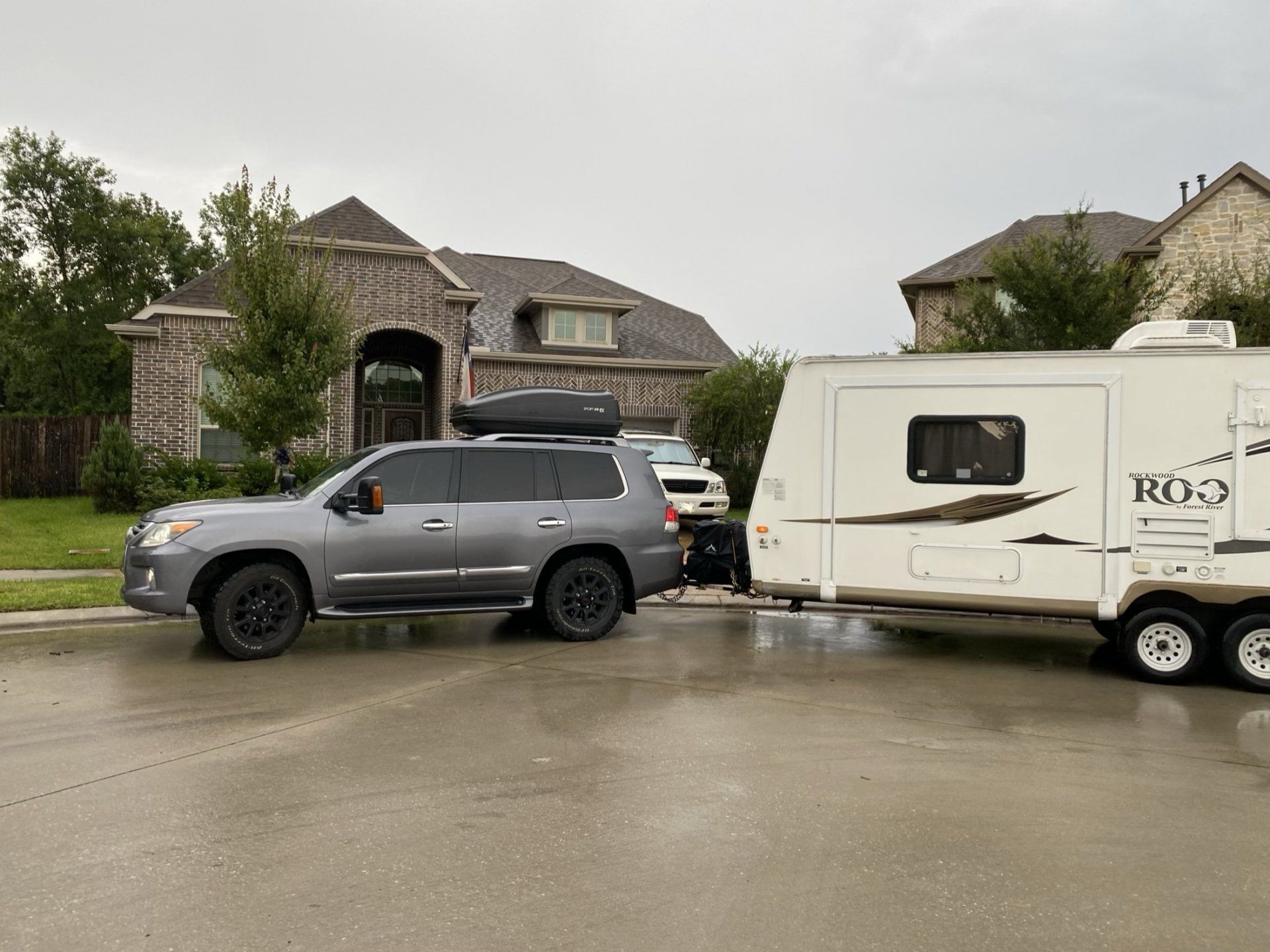

I wanted to follow up on this post for anyone still looking for tow mirrors or maybe 5 years from now. I bit the bullet on the eBay mirrors I posted above. By the time I ordered they had price dropped to $199 delivered which is what convinced me to roll the dice. The eBay listing says it will take 60 days to arrive and they aren’t kidding. I think they arrived for me on the 62nd day. When I opened the box they were very well packaged and did not have any damage or marks whatsoever. Installing them went pretty easily and I didn’t really run into any issues. The mounting holes and pins lined up almost perfectly and required very little massaging. I installed these on my 2013 LX570, which the seller said he could not guarantee it would fit since they are specifically for a LC. Well they fit fine and the plug for the power mirror connection clipped right in with no problem. The power mirror is the larger mirror on top and it operates smoothly so far on both units. The lower mirror is manually adjustable. On the passenger side mirror I was not able to angle the mirror quite as far toward me as I would like and I do have to lean back a little to get a full view. I bought some blind spot mirrors and put them in the outside top corner on both mirrors and am very happy with that. I do not have a long term review since I have only had the mirrors for about two months, however I do have a long distance review. I drove from Houston to New York and back last month with the mirrors fully extended and had absolutely no problems at all. So far I really love these mirrors and strongly encourage anyone that needs tow mirrors to buy this set. I used the clip on mirrors to the factory units on a drive to Arizona in March and they pissed me off so much that I was ready to shell out the $750 for clear views, but decided to try these first and am glad I did. I’m heading to California in a couple weeks with the camper and if anything goes wrong I’ll update here, but I feel very confident that they will perform perfectly. I am attaching a couple pictures for y’all to see. If anyone would like a picture from a different angle or of a specific part just message me and I would be happy to send whatever you need. Hope this helps.

Did you have to give up any functions with those mirrors? The LX, especially the later ones, has quite a bit of stuff built in including - power fold, heat, signal, camera, blind spot indicator, angle down on reverse, anything else I'm missing?

I gave up everything except power movement. I don’t think my 13 has lane assist,blind spot etc. So all I lost was the heated feature and power fold. This one does have a turn signal indicator on the outside. Oh and it does not automatically angle down for reverse, but I don’t care about any of those things personally.

How is the road vibration? I had a pair of Clearviews on my Tacoma and they vibrated quite a bit. It wasn't a deal breaker, but it was very annoying. . .

There’s a little vibration of the mirror “glass” that I can see, but not feel. Like you describe it’s not a big deal and I don’t even find it annoying at all really. The housings do not have any vibration for sure.
