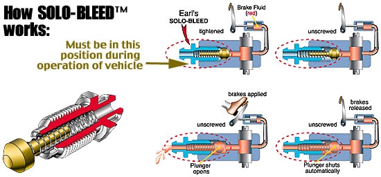

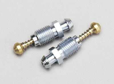

I recently bled all my lines because I thought the pedal felt squishy. I installed earls solo bleeders on all 4 corners. I could not find the right size for the lspv so I used a "speed bleeder" brand for that one. I definitely got all the air out from the lines. Maybe not from the abs unit since the brakes still feel a little squishy.
