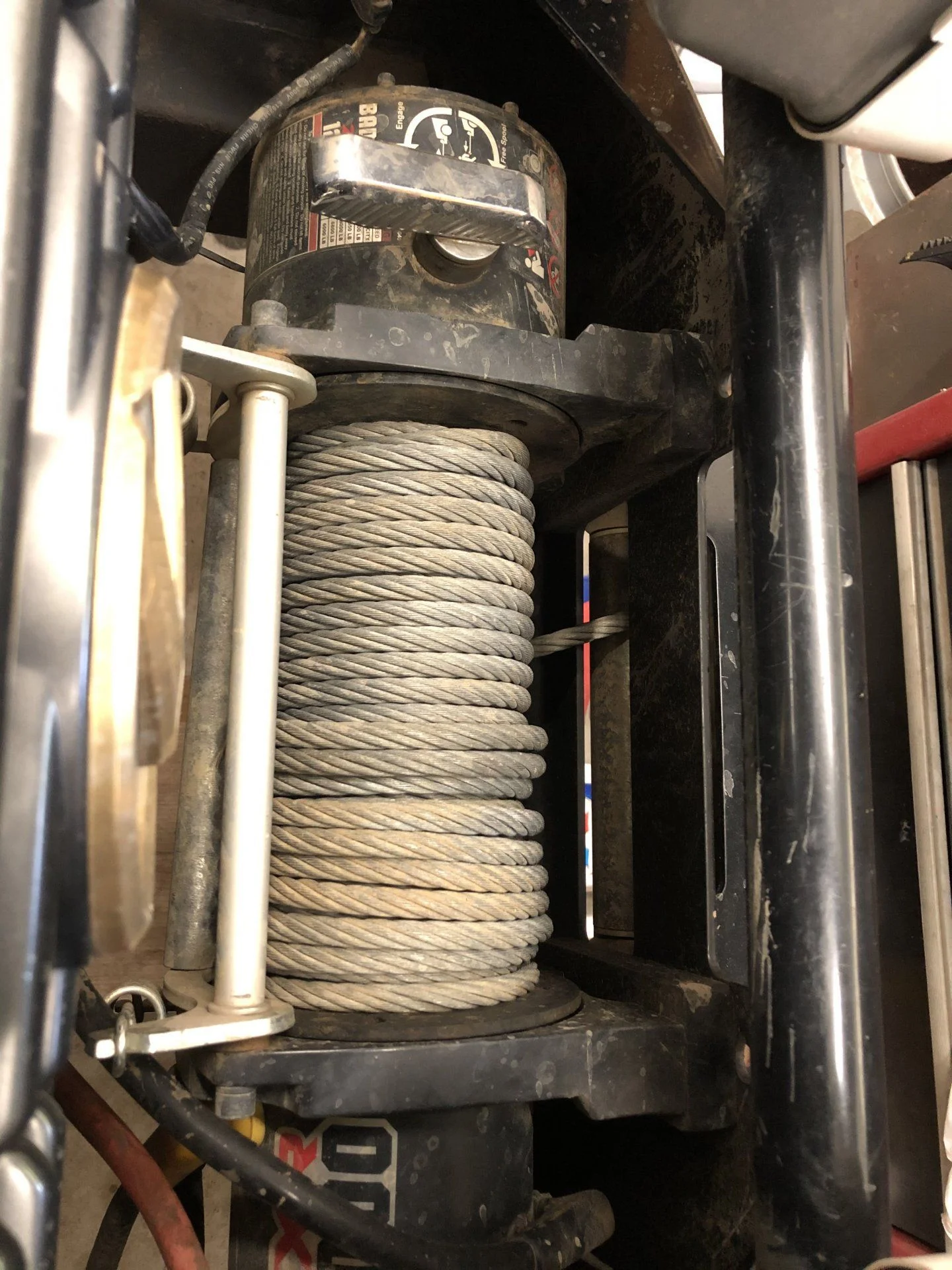

Not the best pics but you’ll get the idea. It’s 4 bolts that hold the winch to the front of the bumper.
