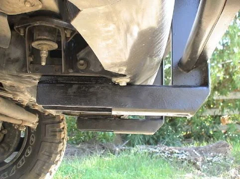

here is how the roo bar attaches to the frame. It's simply bolted on underneath the frame rails with 3 bolts on each side (may add U-bolts later on for added strength).
It seems that if I attach a strap to the front of the bar, either directly or with a shackle, at the same elevation as the bottom of the frame, that I should be in good shape.
Waddya think?

I said "safely"!
The issue here is that a big shackle would require a big hole in the mounts, which would weaken the mount, so I would have to compromise. 3/4" is pretty small, that should work, but 10K is not that much for a snatch maybe?
I'm starting to think I may not do this after all.
In theory should be plenty safe if done well, but maybe not worth taking a chance?
Life is too short...
E

Yes, it's a Bambi bar mostly. Doesn't mean I would not go offroad if I have it on. So the question was really about the fact that if this bar is on I don't have tow loops any more in front, so what to connect the strap to if stuck? Was being proactive in figuring it out before going out there. As far as connecting to the frame directly, I don't know how to do that.
I guess what throws me about this discussion is that the tow loops are held with 2 bolts. This bar and others are held with many more bolts, yet it is widely said not to connect the straps to the bullbar. That does not make sense if somebody is careful where to connect the strap, I would think.
