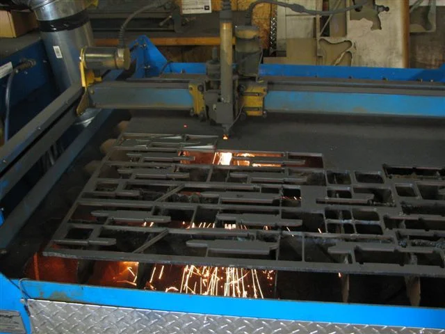

Heres a pic of some cuts done with my Hypertherm Powermax45 plasma on a 4 x 4 cnc table. If I want to cut by hand I unplug the machine torch and plug in the hand torch....can sever to 1-1/4", torch is designed for drag cutting and for guiding along a template.

I really do miss the days of being able to draw/post my items on a PC, walk out into the warehouse, throw a sheet of steel on the table and make all the shape cuts I want.
My goal, however, is to test the feasibility of making shape cuts in my garage - for nowhere near the expense of a nice table setup - with hand tools, if possible. I will more than likely go this route, but for starters, hand tools are gonna have to cut it, pun intended.
Well, this one is in my garage! The Powermax45 plasma is about $2k, the cnc machine and software is $10k.
If the max you need to cut is 1/4" you could use the Powermax30, which is around $1000. Just pretend your hand is the cnc machine, and your mind is the nesting software!
