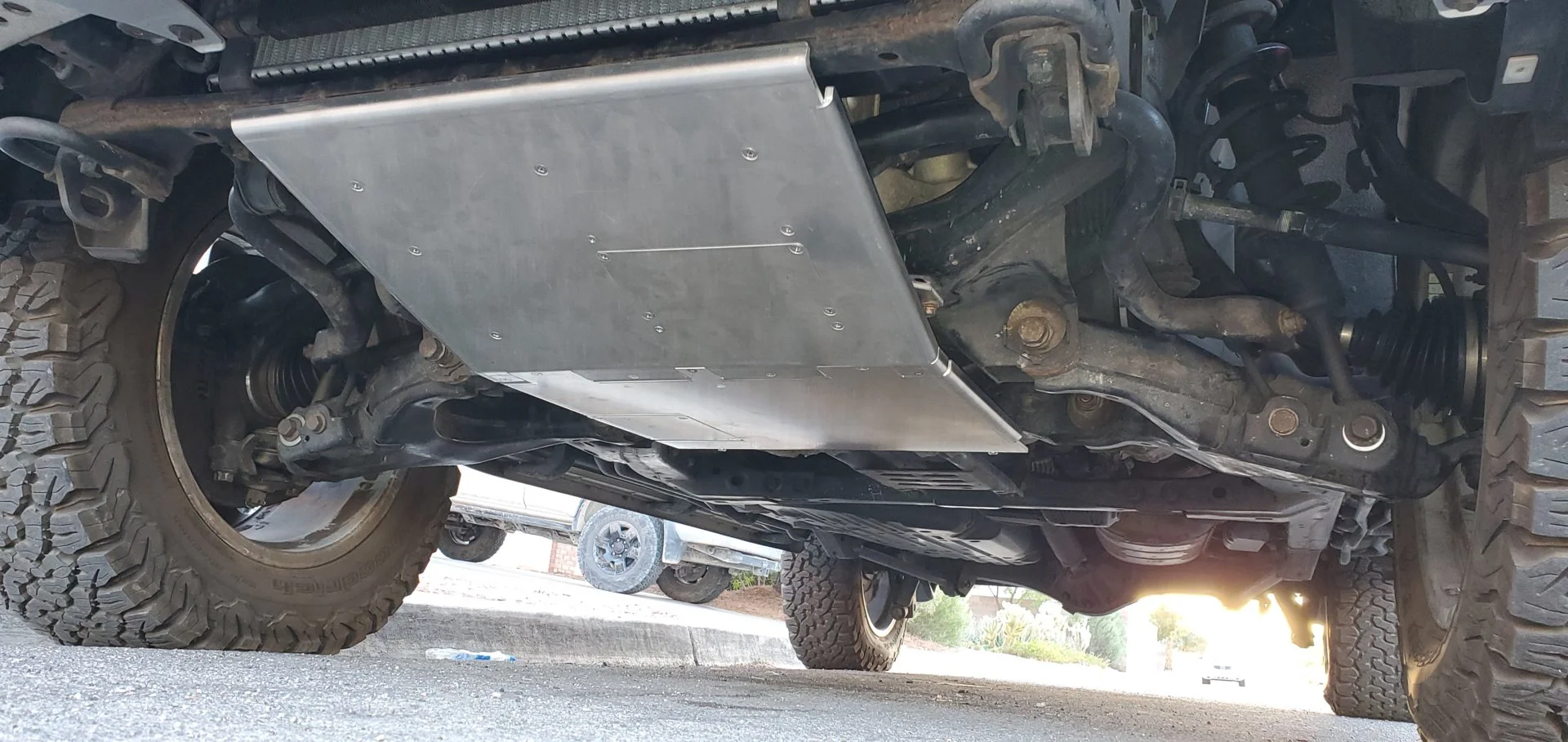

Budbuilt has an access hole for the filter which has a cover with a few small bolts. Pretty easy. Definitely don’t have to drop the skid.

I have the Dissent skids and you remove one section to get to the oil filter, it’s 6 bolts and it takes a minute or so. The oil drain plug is accessible without removing anything, if I remember correctly, but I use the Jowett setup so removing the drain plug is moot.
Bonus to the Dissent skids is there is access for the front zerks… since you’re changing oil you’ll be greasing those as well.
I have ARB Skid Plate/s and I cut an access inspection hole so that I don't need to remove the skid plate when doing the oil change. Plus I have those ez-drains and Jowett filter housing.

Not the ARB ones. You have to completely remove the front skid plate to get to the oil filter cartridge and it's a PITA. You have access to the drain plug without removing anything but it makes a mess....
+1 for budbuilt and oil changes. Three 5mm bolts and you're at the filter. I have a Fumoto valve, so no need to drop the skid or create an oil bath when oil drain plug removed.
