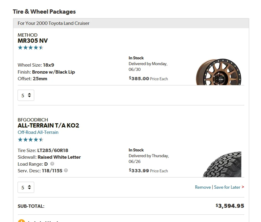

Hey guys I am looking to get a set of method wheels for my 2000 stock lift landcruiser.
Would 18x9 work ? is 25mm offset better? or 0mm offset? what size tires ?
I would prefer 16" or 17" any method wheels that would work for this size ?
This is what tire rack recommends. Any comments ? suggestions ?
Stock height Land Cruiser…
How are you gonna use this thing?
Are you willing to trim?
I recommend 17’s as they have a much broader tire selection.
I don’t suggest more than +25 offset.
285/70’s (33’s) are a very common size, easy to find and relatively affordable.
Mainly street but light offroading. Yes I am willing to trim but prefer not to
If it were my rig, I'd go 17x9 wheel, +25 offset, 285 tire
