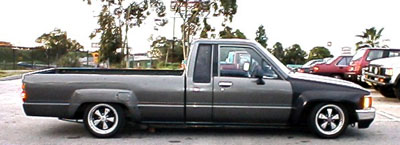

Isn't this a longbed?
If it gets you through the night, then sure.... :D No, that's a shorty, about 6 feet long. Long beds are about 7 feet long, and the difference is between the rear wheel and the cab, like this 2wd, that someone put 4wd fenders on.....
