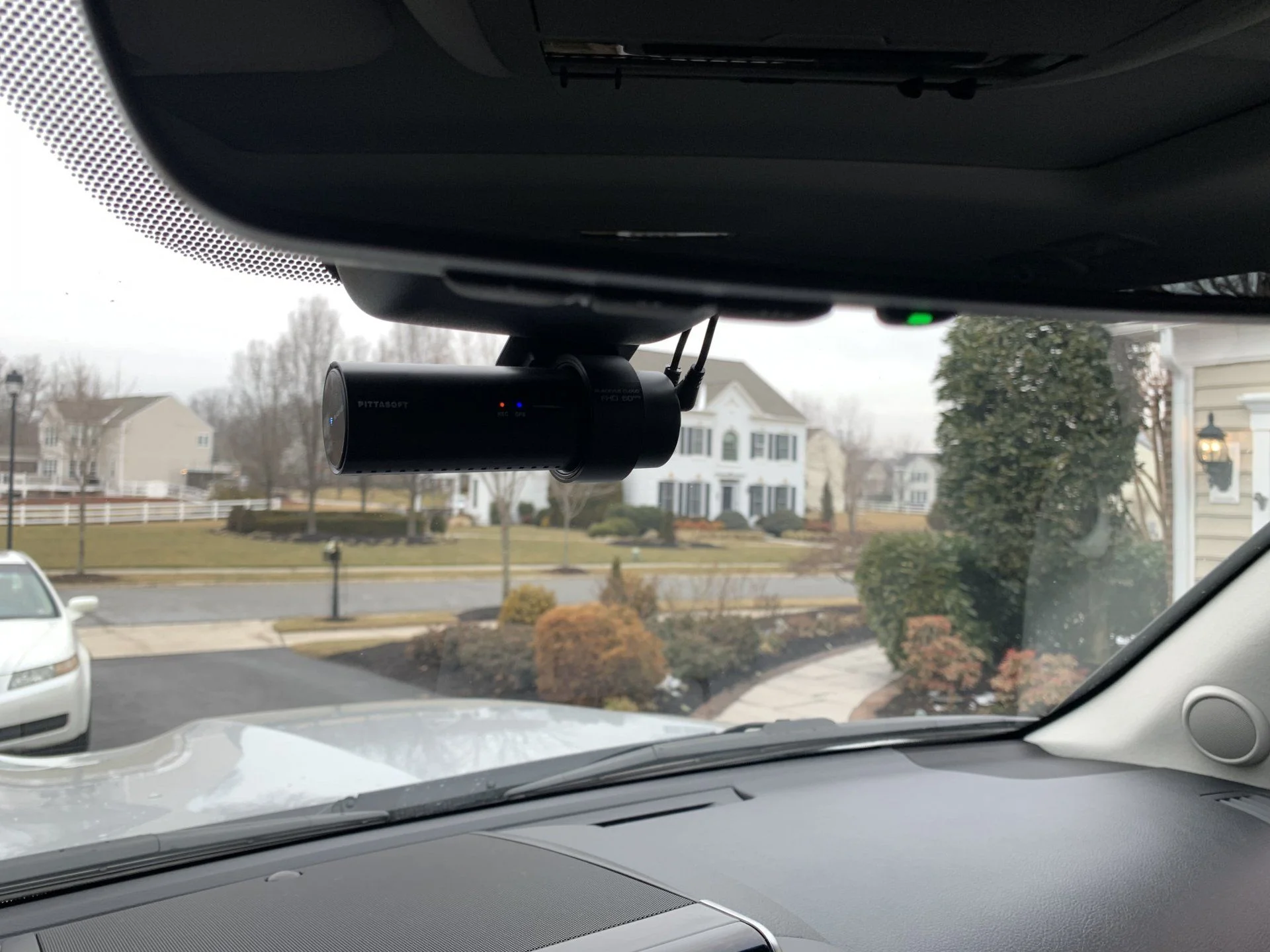

in the middle. Works great. Have one in rear window too.

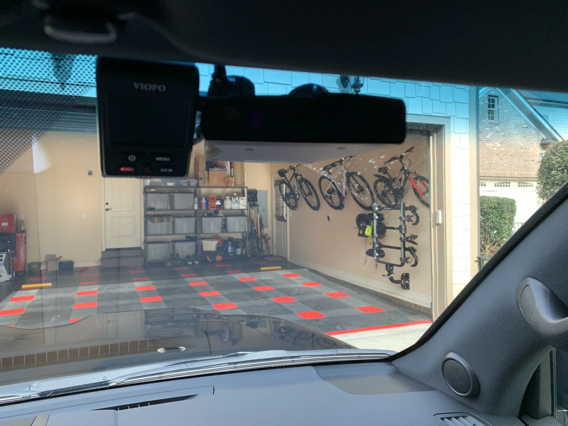

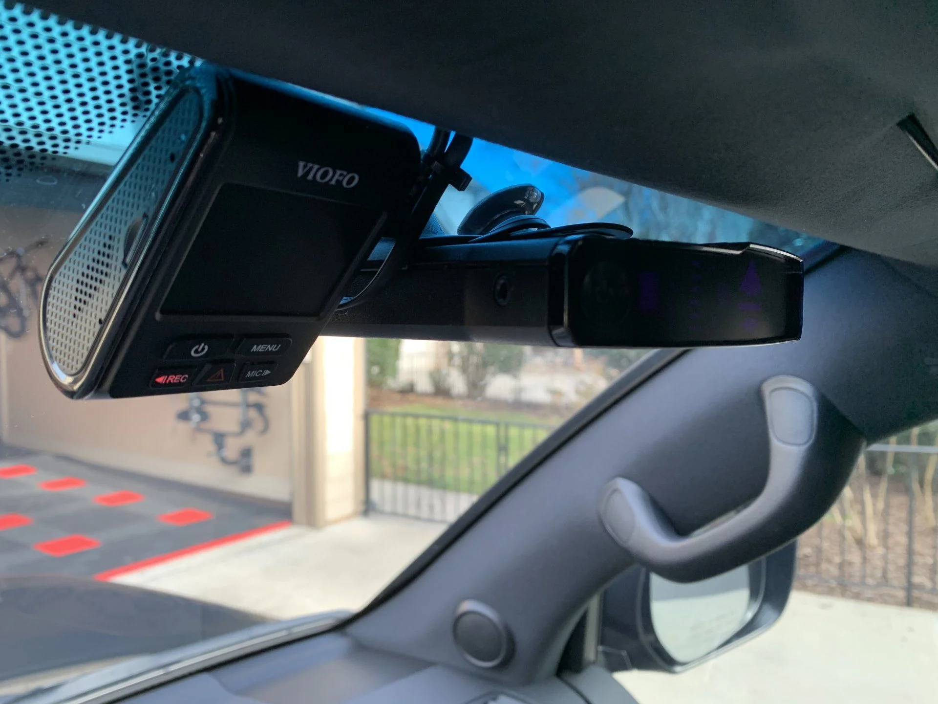

I like it more concealed with as much as possible covered behind the dark portion of the windshield. Both my camera and radar detector are to the right of my mirror. All cameras are wide angle now so there is not disadvantage to mounting it more to the side vs exact middle.

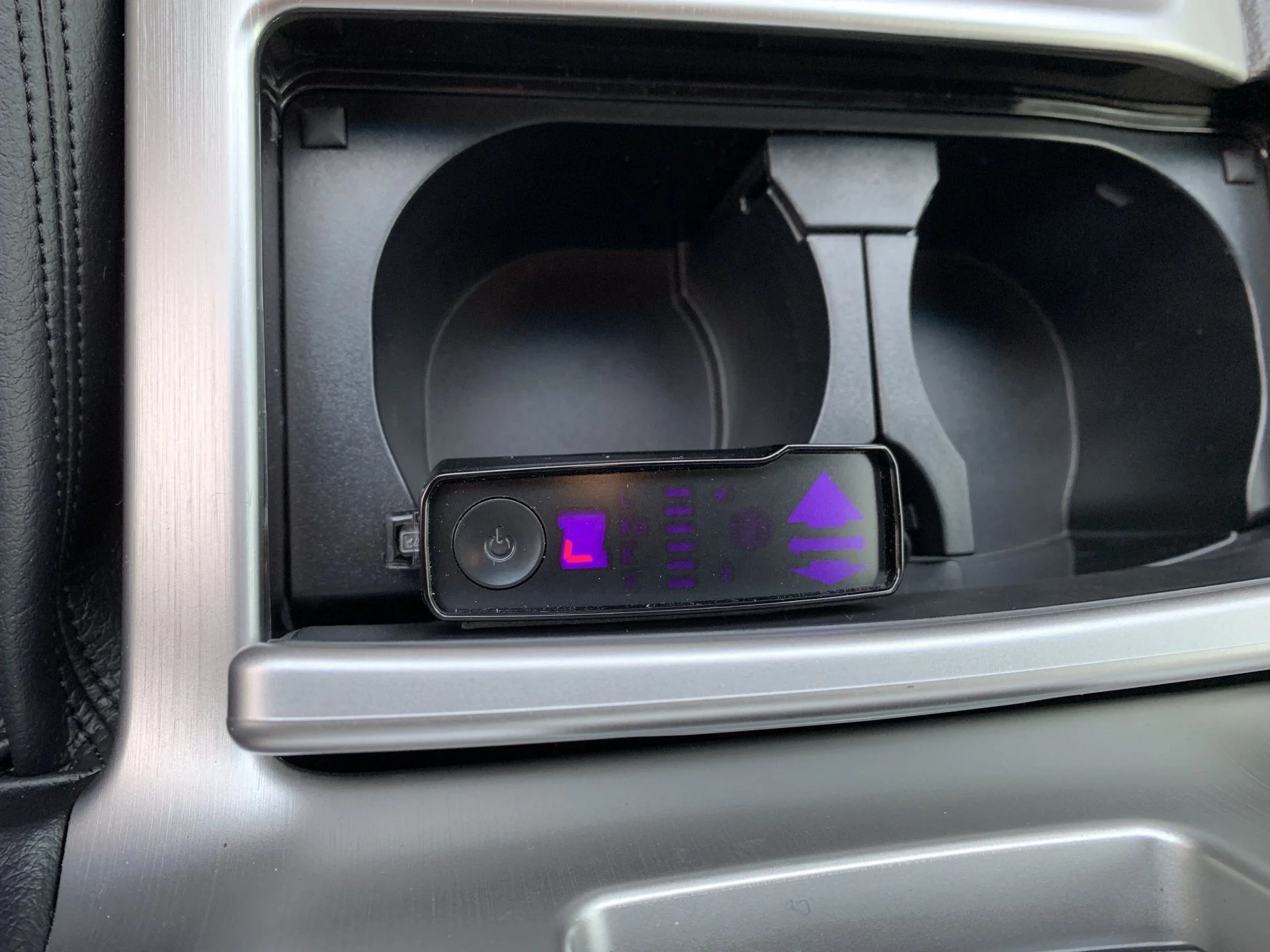

I have ran both wires tacked in behind the liner toward driver side and down the left pillar (couldn't fit them in only around the mirror cover where I tacked wires right between the cover and liner- believe it was middle row, 2nd one from firewall side). For the camera I have used fuse tap on driver side fuse box (used the same tap for both the camera and DRL I have installed in the bumper). For the Radar detector I have used Valentine1 Savvy which uses OBD port.

Yep. I have my RD mounted up high to the drivers left corner, easy to control. I live in VA.... Gives me quick access to take down if needed however, you can't really see it looking at the front of windshield or when LE pulls up next to me.
I'm not too concerned if anyone sees the camera, in some cases that's a good thing. It's hardwired to a dual battery along with the rear camera.
Nice Valentine remote, didn't know they had an OBD option.

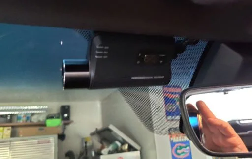

The dotted areas don't interfere with the Florida EZ Pass toll road system.
To add to the list of mounting: I mounted my front camera with as much of it hidden behind the dots as possible.
