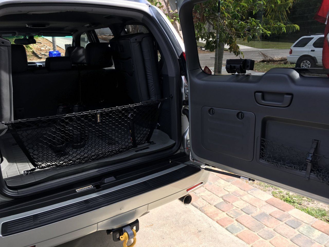

Is it strong enough to hold up in a decent wind? I am now in the habit of locking my door open so it doesn't blow shut on me.
Yes, its great. When I'm backed up the incline of my driveway, it will push the door open after I pop the handle. It has to be physically pushed closed. They really should have come this way.

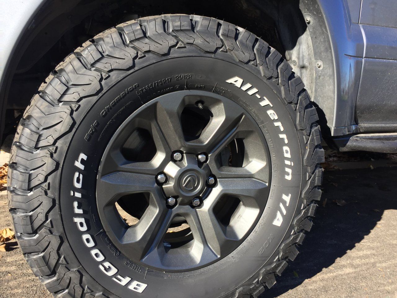

Posted these on other threads, but didn't want this thread to die. I've done a few sub $100 mods recently. Top LED bar was $88, lower LEDs were about $30 each, sanded and painted my new-to-me wheels (do the wheels also count as under $100 if I made money selling my Lexus chrome wheels and buying these?). Maybe painting wheels isn't a true mod but I'm putting it here anyway.

  • wheels - awesome - where'd you pick those up (CL)?

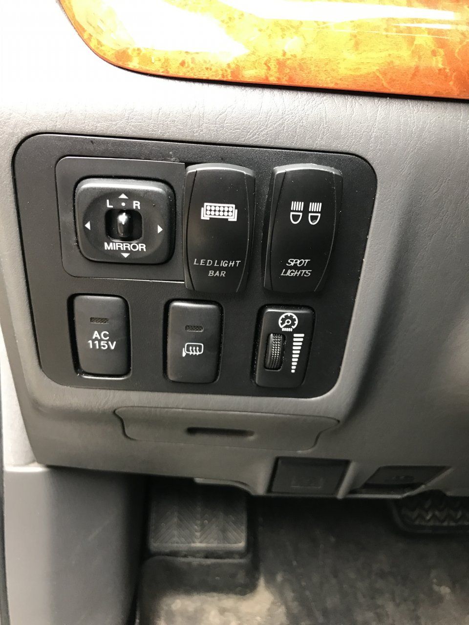

  • LEDs - awesome - how did you mount/wire the top one?
Thank you- I picked up 4 wheels on CL locally for $250, and then bought the spare on eBay for $75 shipped so you can't beat that. All were "take-offs" that hadn't seen any miles so were really easy to clean, sand and paint. I have to give props to a 4R owner who goes by Fargo 4X4 on Ig who painted his wheels this same way. I had been browsing through literally 100's of wheel options and never would have considered these in silver. But as soon as I saw them in this color with the KO2s I fell in love. Perfect offset, great price, and now with the Lexus emblem they're also unique enough for me. ;)
The light bar wiring was pretty straight-forward, and I'll grab some pics later today, but I ran the wiring towards the windshield under the gutter lining, then stuffed it into the channel next to the windshield, under the hood and into the engine bay. The switch wiring was pushed through a hole I made in a rubber grommet between the engine bay and cabin on the far drivers side. Then dremelled a cut out for the rocker switch next to the side mirror switch. It's not super clean, but I like the ease of it. I moved some switches around (had to re-notch the openings) so the light bar switches were next to each other. Overall I don't think it turned out too bad, but someday I may decide to get some Toyota-sized switches and redo that area. We will see. I posted a bit more about the mounting here: What Did You Do With Your 120 Today?

Nice truck, Lee. What wheels are those?
