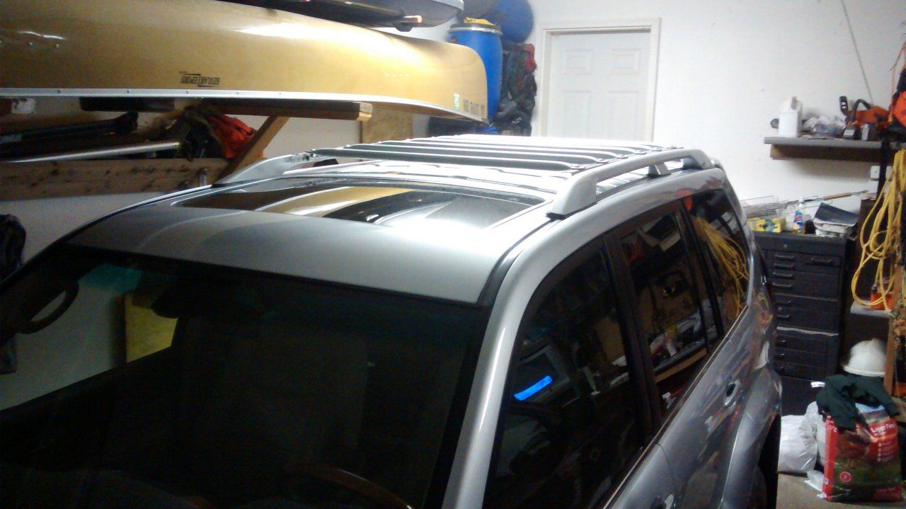

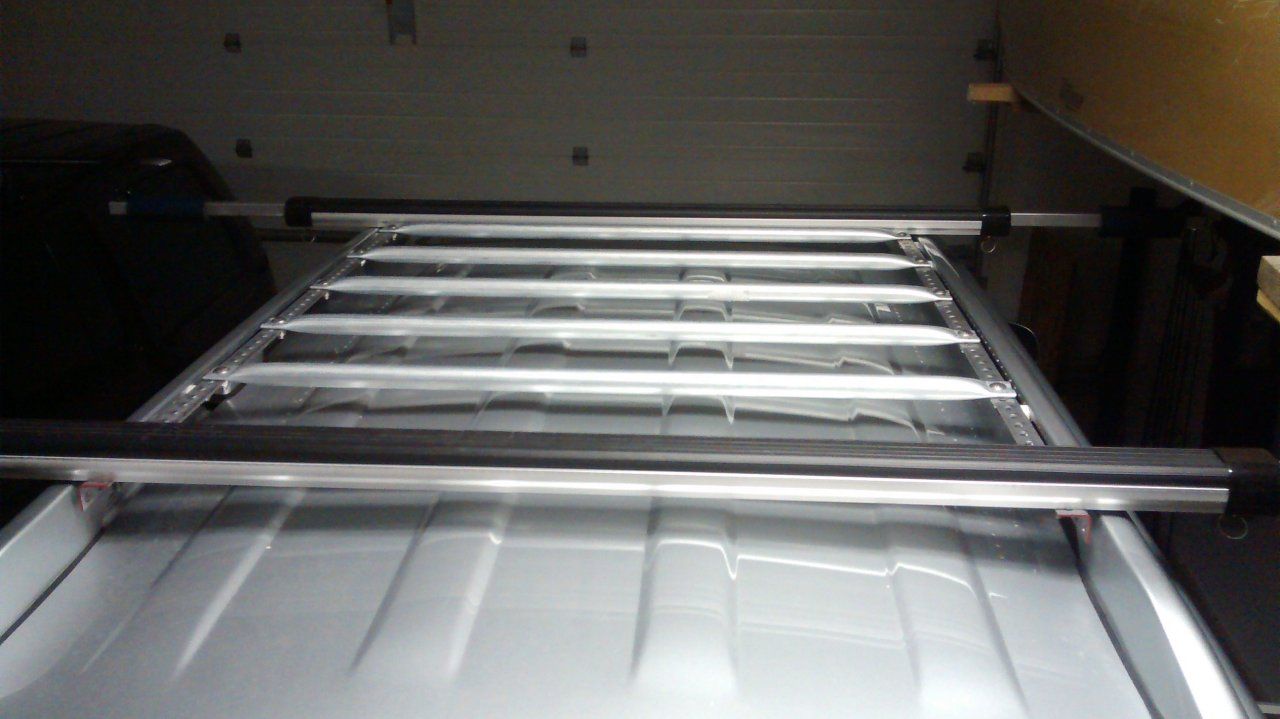

New roof rack for about $60.
Cross bars are 1" EMT Conduit with the ends pinched in a vise. I did not use the bolts from the cross bars. I used stainless steel carriage bolts. The square under the head of the bolt was an exact fit in the slot of the factory rails. Used four on each side as well as some nylon spacers. I did not run the EMT all the way to the end because I have canoe bars I can take on and off as needed.
Borrowed rack idea from T4R.org. I like it. Need to add a fairing. A bit of noise. Not bad with all windows closed though.
