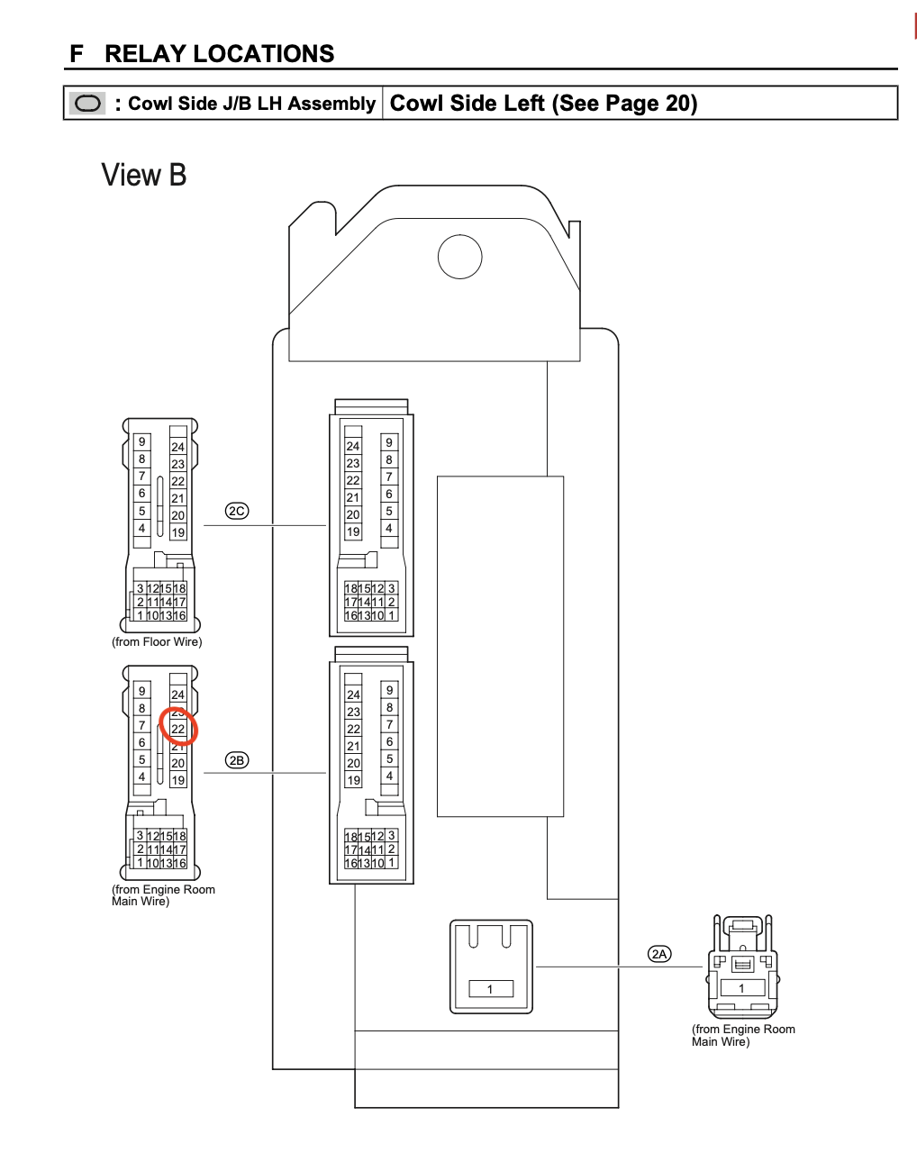

I believe best case would be to remove pin 22 from the 2B connector on the junction block that is the grayed out block on the first diagram. Wire in the switch there. I like the idea of also locking out the shift interlock and the split is on the backside of that junction and would be awkward to access. Locking the shifter in Park would be the benefit. It would take quite the motivated individual to get through all of that and a full time 4WD is a pain to tow in park without making a racket.

We never heard if @ekolpack ever implemented this, but I decided to do so. Thanks to @LXRuth for this clever-seeming idea.
I managed to locate pin 22 of the 2B connector where it plugs into the main body ECU (or maybe into some box that contains it - I'm not clear on that. I pulled the panel from the dash and was just able to find room to splice into the wire at pin 22 - it was a red one (24 and 19 aren't connected, the other ones were blue or green I think). I tested starting the truck with the wire connected and not connected, and everything seemed to work just as expected.
For now I just have the other ends of my splice twisted together, but my plan is to eventually get hold of one of the OEM dashboard buttons such as the VSC OFF switch and put it in one of the unused button locations on the dash. Then I'll just need to press that AND the brake when I hit the start button. I don't imagine it will matter if it stays unconnected while driving.

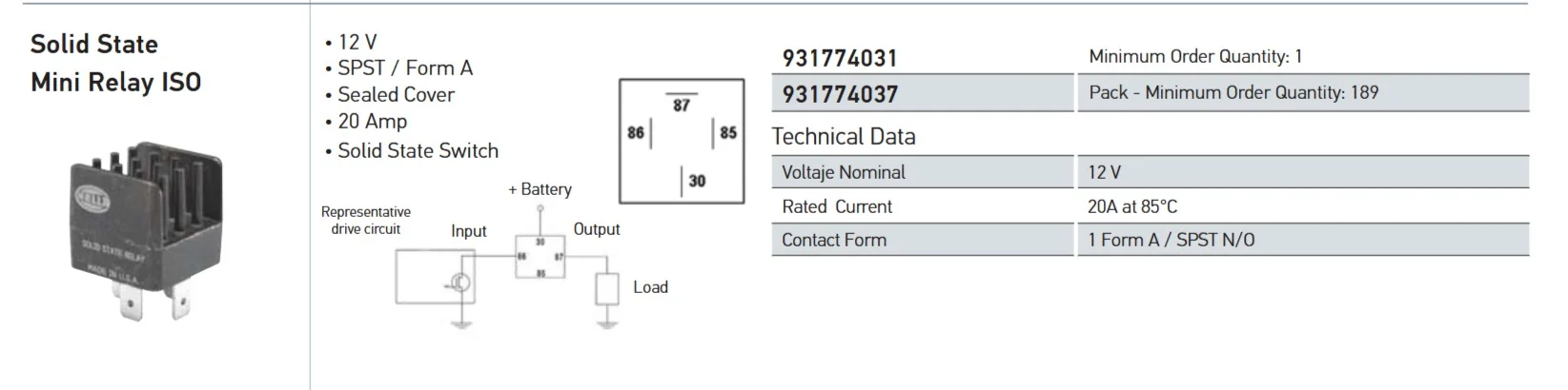

Hello guy I’ve been thinking of installing this unit on my lc since I don’t have to splice any factory wires. I’m just concerned about using non oem relay. Any thoughts would be appreciated.
Drop-In Kill Switch (Anti-Theft) - 41.22 Inc. - https://41twentytwo.com/product/vehicle-kill-switch/?srsltid=AfmBOopo6RNY0spVzgS2yWSHIZDmuOiRhIbnGl-KfkaXhGTwrb24MLS2
I’d HOPE they use a quality relay in this kit. But for $98, it’s likely Chinesium low bid stuff. If you’re really concerned you could keep the original relay hidden in your car should this one take a sh*t.

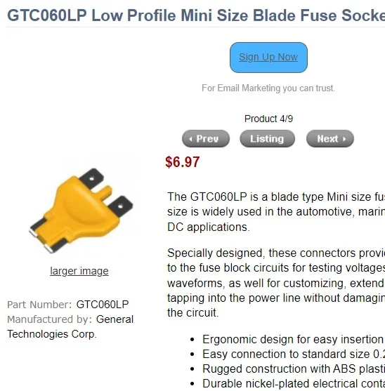

Second best seems like the delay-on-release relay but I'll need to figure out somewhere to get power in the cockpit. Maybe tap off an unused fuse but there's no extra room under the cover. If anyone has a better idea for sourcing power I'd be glad to hear it.
