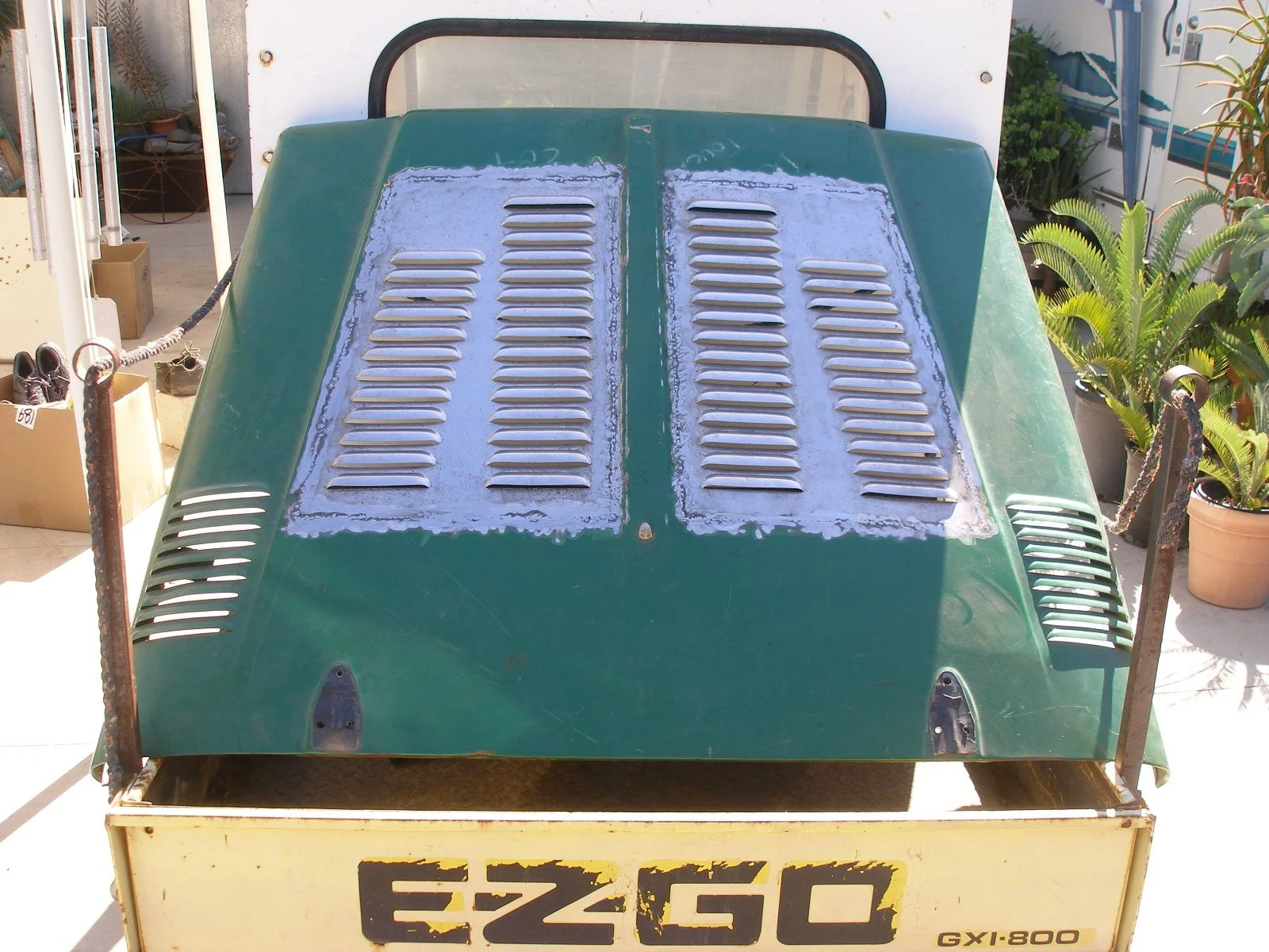

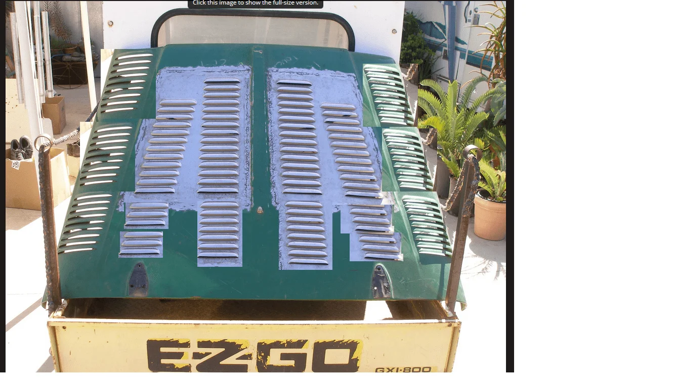

Might get louvers punched locally, but more likely will add louver panels. Something like the attached photo--just not so huge! Maybe two panels of 7 or 11 louvers.

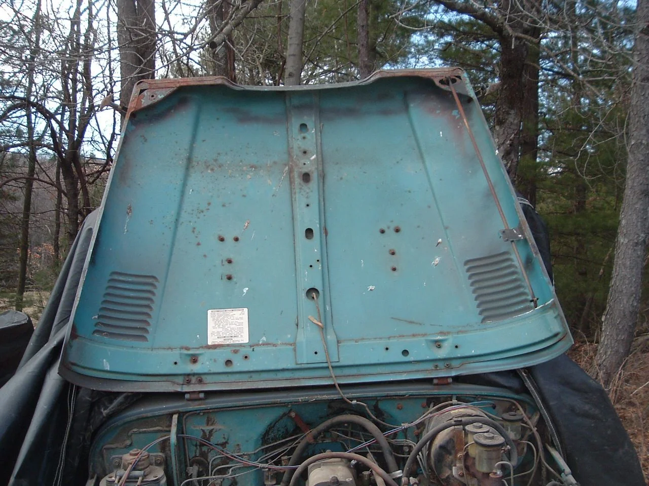

My main question is location. The factory louvers are on the sides at rear, in what I expect is a well-thought out placement for engine bay air pressure, to draw hot air out, and also away from the cowl intake vent at the base of the windshield.

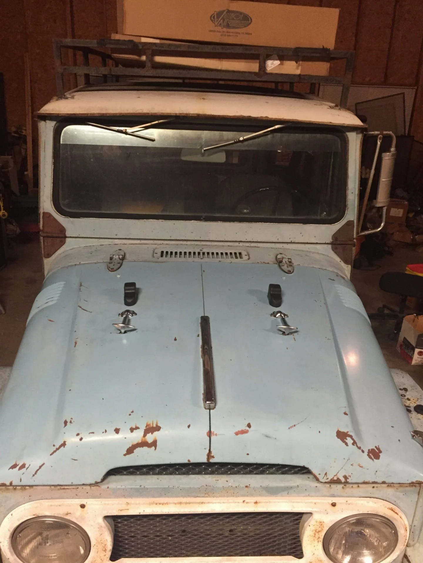

So to sum up, if you were going to do it, where do you think the optimum location for some new louvers would be? I've attached some additional photos. The "closed hood" pic is our project FJ40.
Opinions noted! Where you you put louvers if they were, in theory, needed? Always liked the look of louvers in the hot rod world, where they are very common and popular--and do have positive effects, generally speaking.
Not needed ... and if it is... there are other issues
I agree. There's plenty of room for air to escape out the bottom. When my hood and fenders rotted away I fabbed up all the body work forward of the firewall. The hood has no vents. The six blade fixed fan pushes plenty of air out the bottom. With a 170* T-stat I run at 170*
I agree on all counts. Call it for looks then, but stays functional. It's Project Ugly Duckling, anything goes on this Cruiser.
The factory louvers are tapered the back one is wider than the front one
I should have measured them first lol
If a 460 big block doesn't need extra airflow your diesel should be fine
They are also different lengths and different counts.
Later hoods have 9.
Earlier hoods have 7 but they extend further around the radius of the hood.
