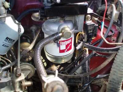

Check out the Racors and GoldenRods. You can get spin on versions of both without heaters...

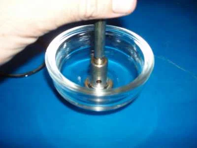

I have a CAV Lucas 269 filter on my HZJ80-turbo. I had a thread going on this subject a while back.
Pics of the filter seperated.
IMO the racors are really nice units, if I had another truck and needed one, i wouldn't hesitate to go racor again

if you want the CAV Lucas 269 unit i have one one those too....:) :) :) :) c/w replacement filters...
