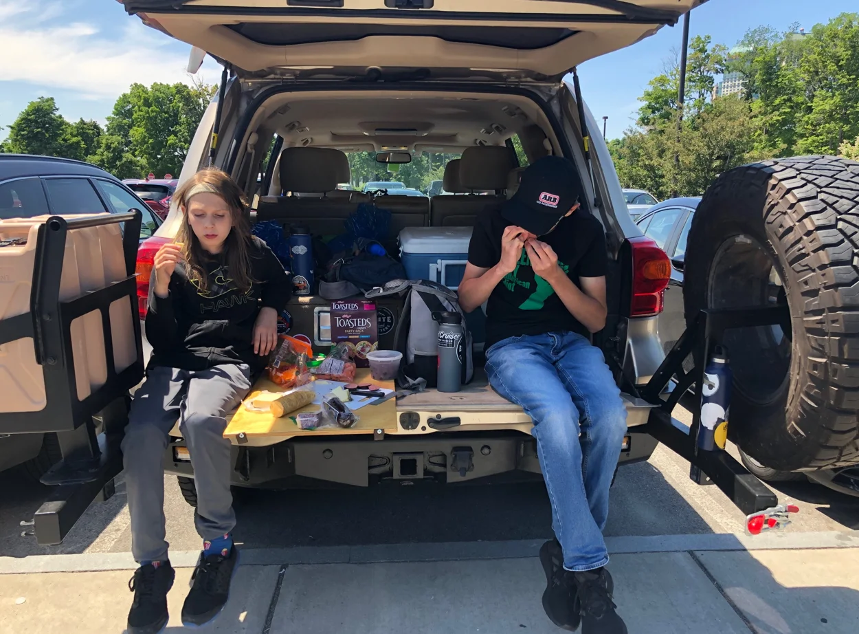

I recently installed a dual swingout rear bumper. I've got a single drawer with a table that slides out from underneath the drawer, which we routinely use to eat lunch when we're back from a hike. I picked up one of those nifty electric faucet pumps for $10 off Amazon this week so we can get drinking water out of the 5 gallon jugs without having to lift them out to tilt. (I do like @Markuson's 3/4" water spigot idea but I wanted to be able to use all 3... plus for $10 I get the coolness factor of it being electric).
After seeing that my wife suggested we put together a simple kitchen so that we can do a bit more food prep/cleaning/etc when we're not at the trailer. Also the 5 of us will wrestle for use of the trailer bathroom in the morning so having a secondary place to brush teeth or put on/take off contacts is a plus. There's an interesting cutting board/collapsible sink on Amazon that I may pick up (along with a mirror), but then I got to thinking about how to make easy use of the space I have.
Things which easily mount to the swingout get a +1. For instance if I could find a table which would mount behind my jerry can holder and fold down to provide a place to put the aforementioned sink, that would be swell. (Note: This one would almost work, but it's ~27" wide and the jerry can holder is only 21" wide). Or a stove that would fit behind the spare and fold out.
Sub-$100 ideas get a star, because we could all drop $10k to have someone custom-fab a special swing out kitchen but finding the one with an almost perfect fit off Aliexpress for $29 plus shipping deserves a medal.
Pic of my sons chowing down in a parking lot at Niagara Falls.

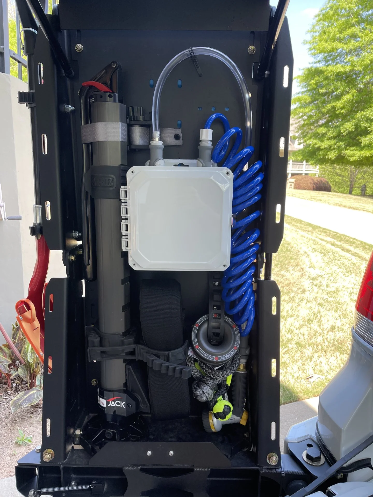

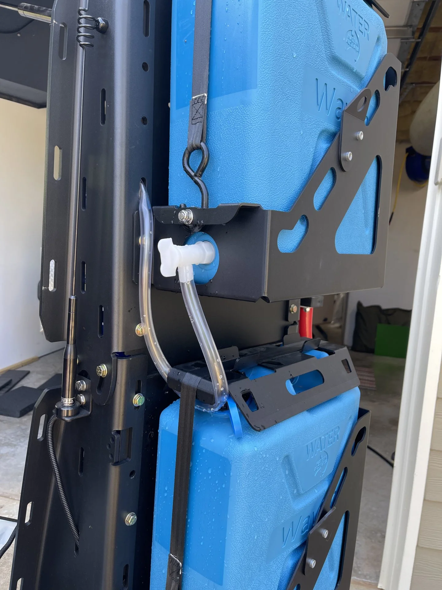

I have Dissent swing outs with the locking cabinet and jerry can holders on the beck side of that cabinet. Using the water from one jerry to a 12v pump and hose attachment has been really handy for washing up hands, kids, nasty boots, showers, etc
. It’s an idea I got from a user in here, if I can find their thread I’ll post it.

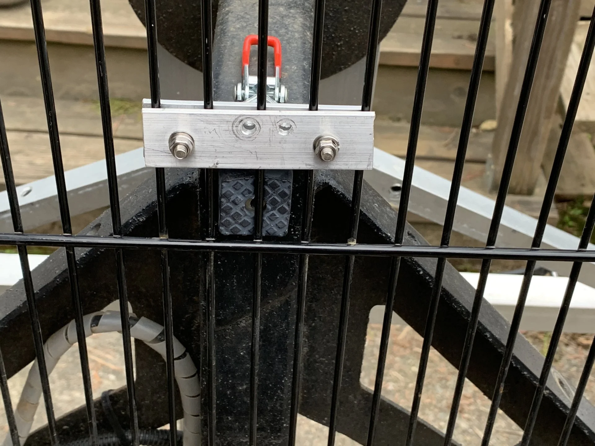

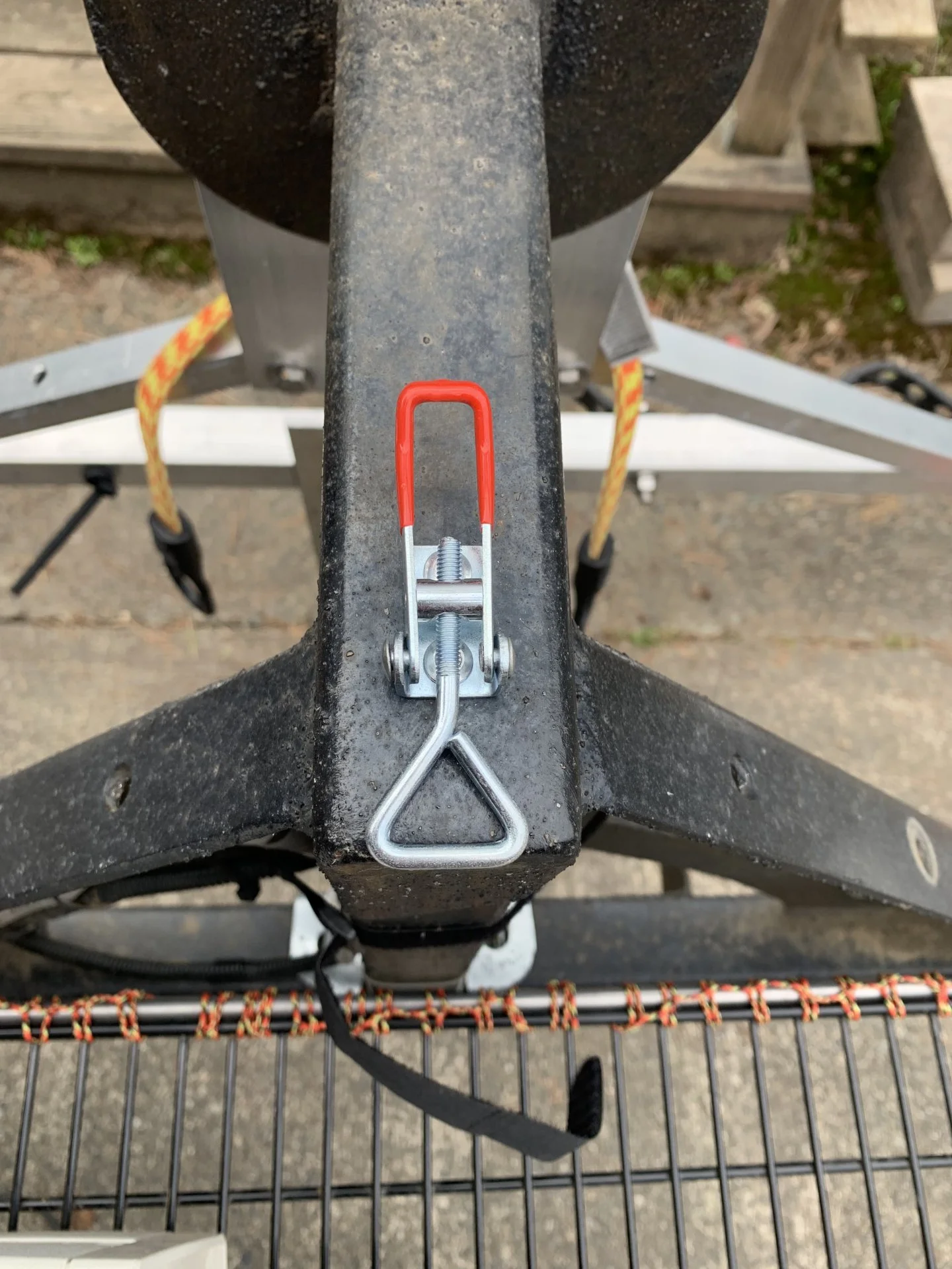

I built a fold down shelf out of a wire storage shelf ($25). The shelf is made in a variety of sizes, I used 30x18.
This version uses a stainless bar woven to the shelf as the pivot, some heim joints at the ends, and is just attached to places that fit behind the tire on the swingout. Using a baby sized latch for closure
The hinge stuff was $30 or so.
Still deciding how to best support it, for now a piece of aluminum angle in the right length works fine.

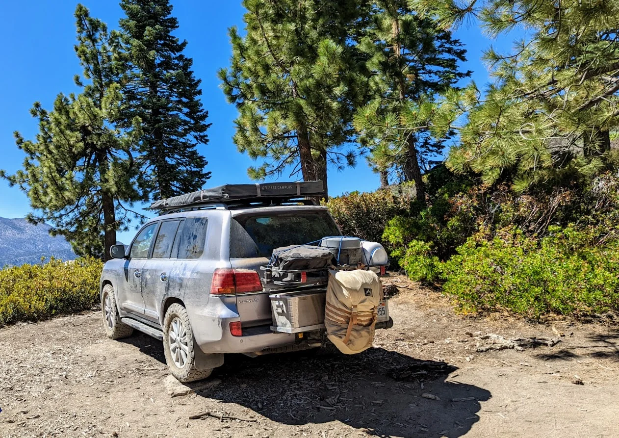

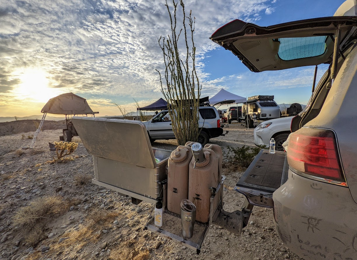

Within my group, I'm usually the stuckie doing trail lunches for 14-24 people. I prefer hot lunches and the group doesn't mind having a break for some good eats. Working out of the car has to be manageable, especially supporting a group this size. A 22" Blackstone griddle is my key cooking partner with lots of cooktop space, 24k BTU, easy to clean, and earns it's space as I don't carry other pots/pans outside of a coffee percolator. For trail lunches, I'll commonly do hamburgers, pulled pork/beef sandwiches, quesadillas, or recently chicken salad on a toasted croissant as it was 95 degree out. It's great for more complex meals as well with the ability to steam, grill, sear, braise, etc.
Other parameter for me is keeping the rig as light as possible. Storage and organizing solutions that add more value than they weight, as I don't want to have the burden of too much weight while enjoying off-roading.

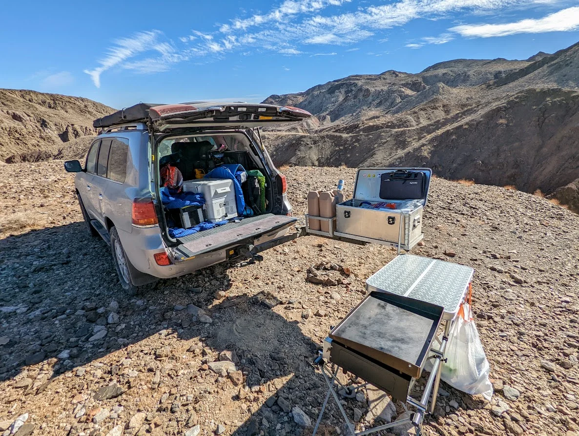

Custom fabbed swingout. Lower box/water carrier is probably about 40lbs (not including water/gear). Add-on upper basket section for longer trips, prob another 30lbs.
Hand wash station with the same type of pump @linuxgod uses.

@TeCKis300 what swing out hitch is that and how do you like it​
I butchered, lengthened, and reworked a Yakima hitch swingout that is no longer recognizable. It wouldn't be very usable as purchased. But there is a possibility a Kuat model could work based on what I learned from re-configuring.

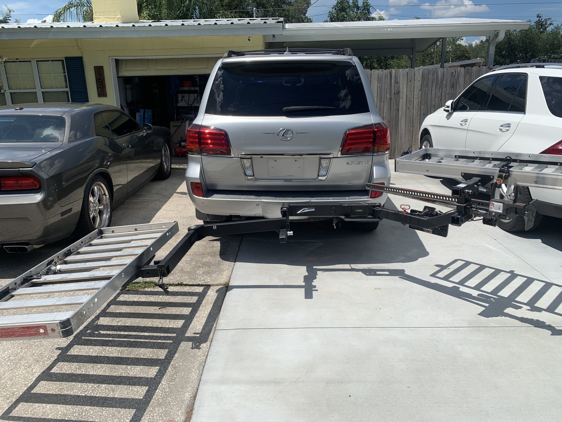

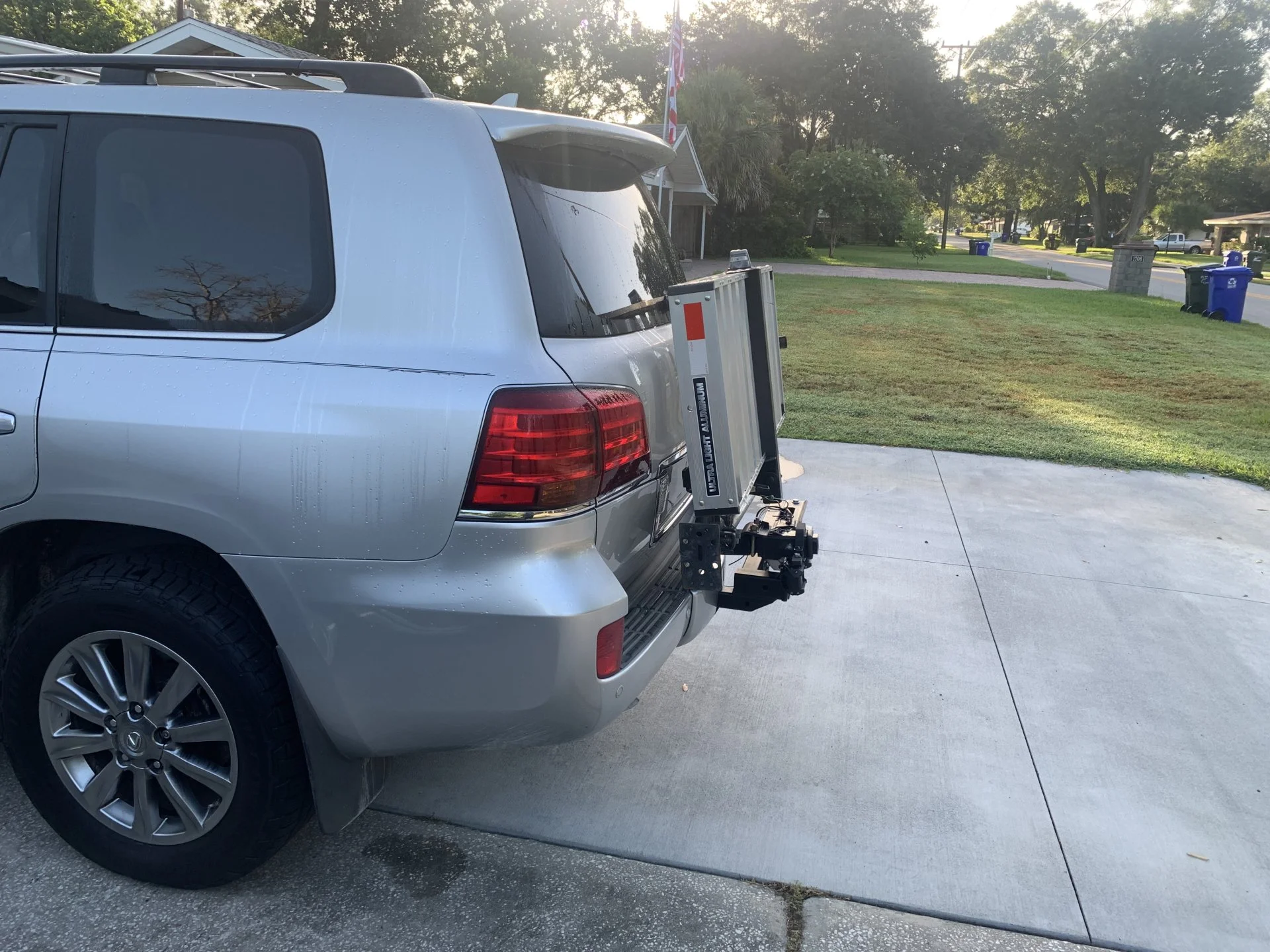

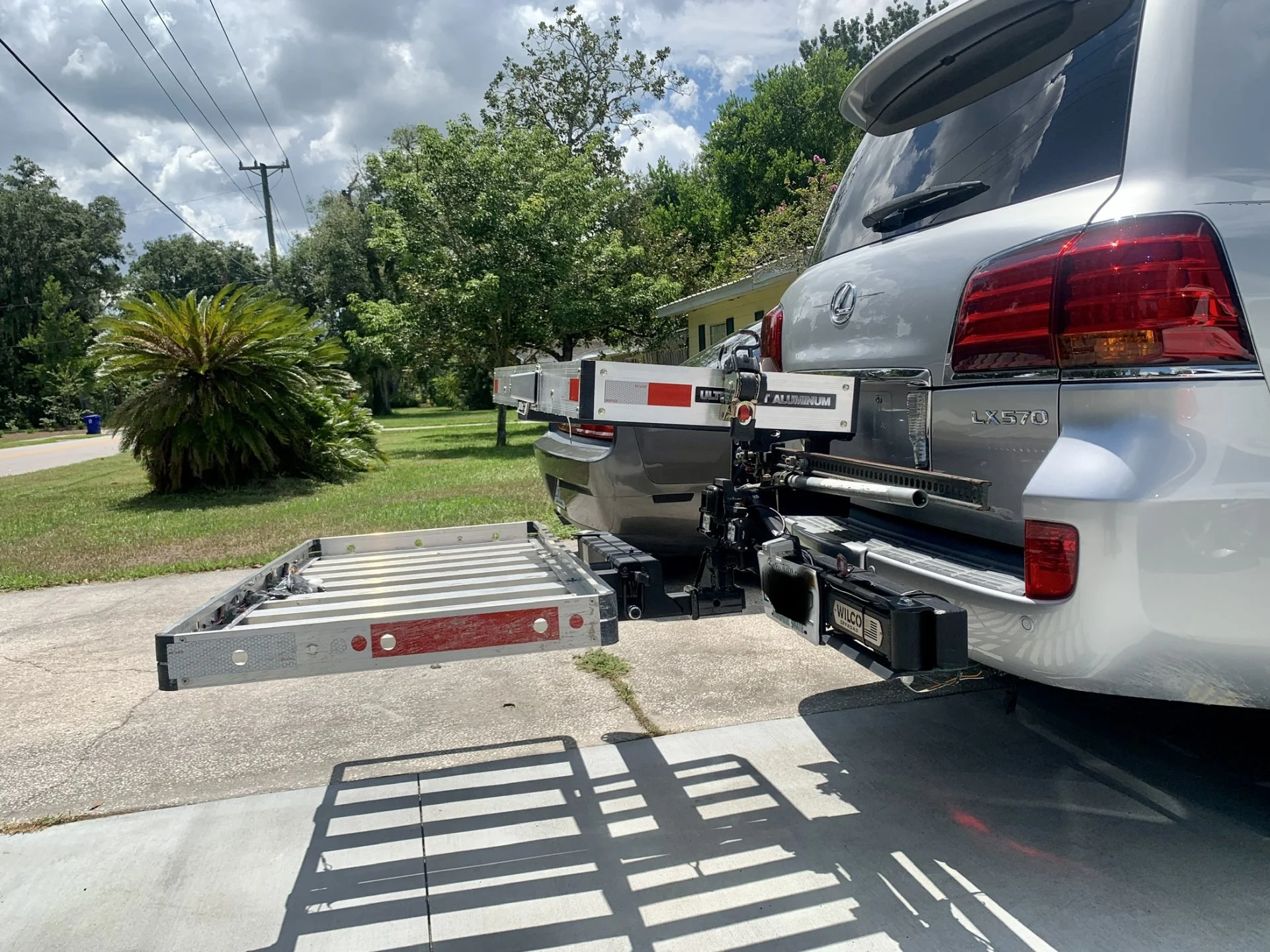

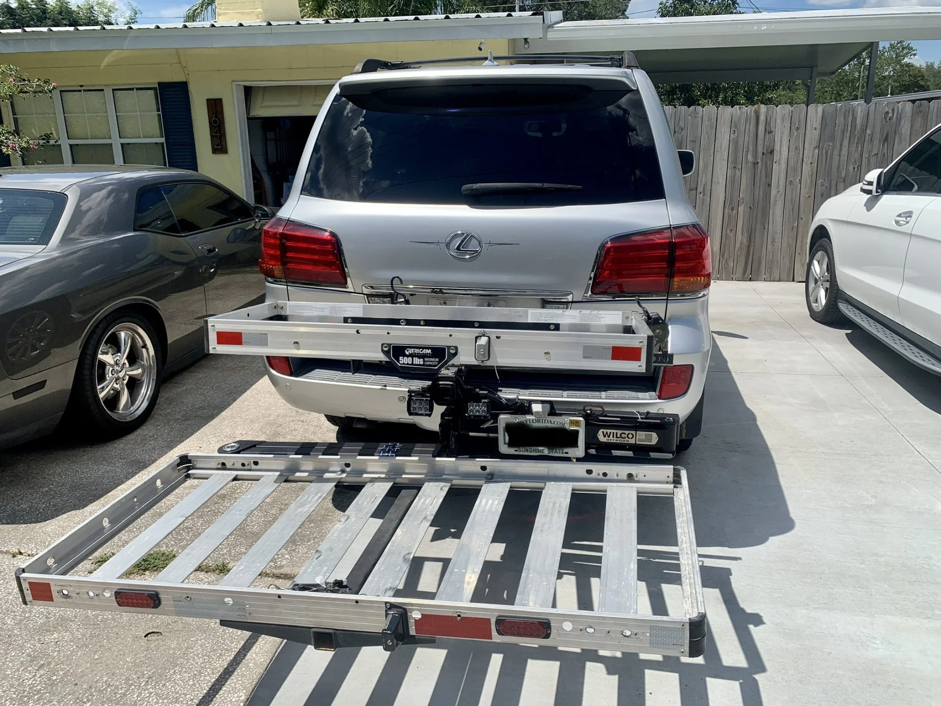

I’ve got a Wilco hitch gate with a riser and a fold up mini hitch carrier that I leave on all the time.
And I recently picked up a driver side kuat swing away (and a hitch drop down) for a larger carrier (with bike rack feature) for when I’d like a little more storage. I haven’t road tested it yet, but I think it’ll be good for road trips…the Wilco and mini carrier, especially when folded up, I think will be fine for more trail oriented trips and when towing.
