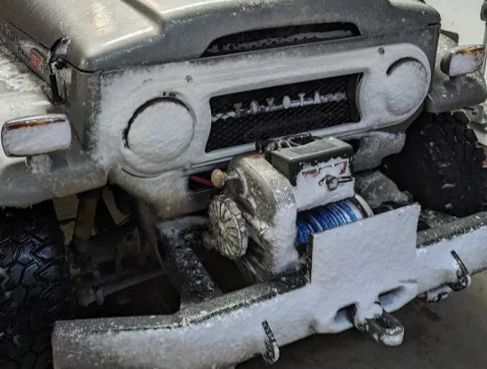

I'll mention that I have the City Racer LED lamps and I love them...but I found out the hard way that they dont get hot enough to melt wet warm snow on the highway.
The headlights were caked over about a inch thick with close to zero light transmission.
It was a very short drive around twilight and it was very hard to see down the road. When I got home I found out why...

I had a similar experience with my city racer lights in the snow. Wiping them off plus some auxiliary lighting got me home. Since then I added couple lights that are protected from snowfall in case this uncommon situation arises again. The city racer lights work great otherwise.

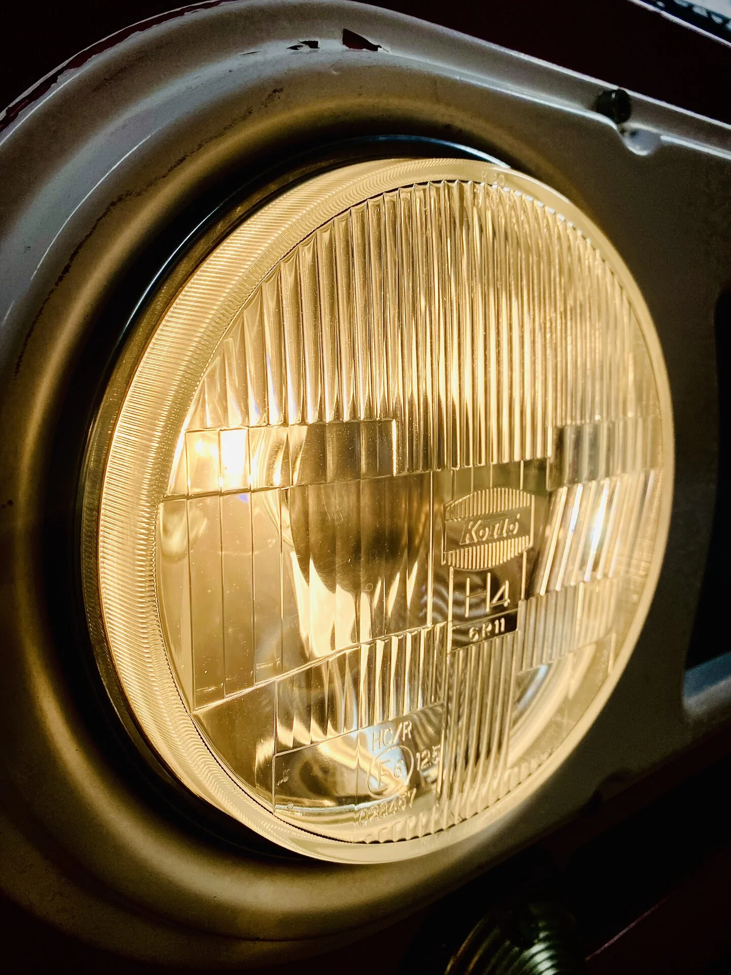

Koito H4 Upgrade Kit
I love the looks of the H4. I may go with this kit also.
Does anyone have a DIY link to do the upgrade to the H4? Looks like there is another harness involved and it isn't as simple as plug and play.

Usually Toyota's require an additional harness as Toyota switches lights by grounding instead of powering the lights... wiser people than me can correct me if that ain't correct.

That's a great kit at a great value. I installed it a couple of yrs ago. It definitely brightened thing up a lot. I shorten the harness a bit for a cleaner install.
